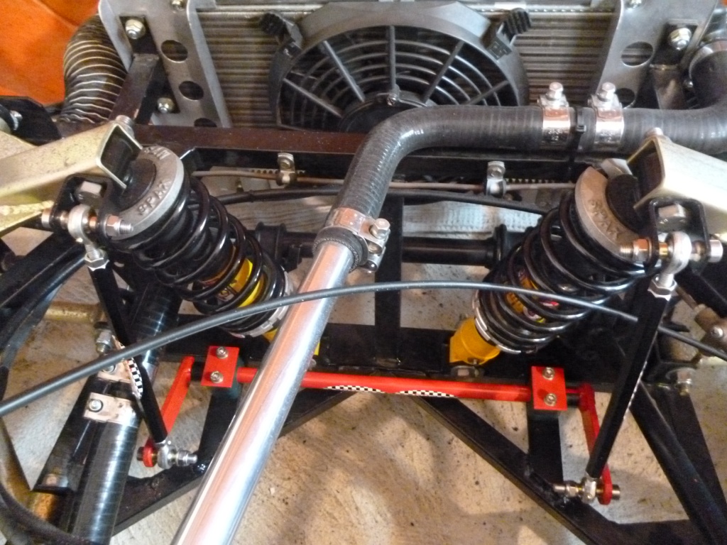

I'm impressed you got the hose over the lever arms , particularly as they're 90 degrees to the ' bar ' :P There's obviously no disadvantage but it looks like you have a hose in between the poly mounting blocks too , which isn't necessary. If with your method (no cable ties) the ARB floats too close to a water pipe or the oil filter , you will need to fit cable ties to give the hose stiffness , not merely to fit on :roll:

It took the best part of 14st to push them on and that was with boiling water and lots of soap, once the soap was washed away and the bar dried the hose really sticks in place. I put the one in the middle partly for asthetics, but as the hose is a tight fit on the bar it reduces movement even more as it's twice the amount of hose that now needs to move if it tries to drift.
If I find that it does drift under load I'll get the metal collars.
