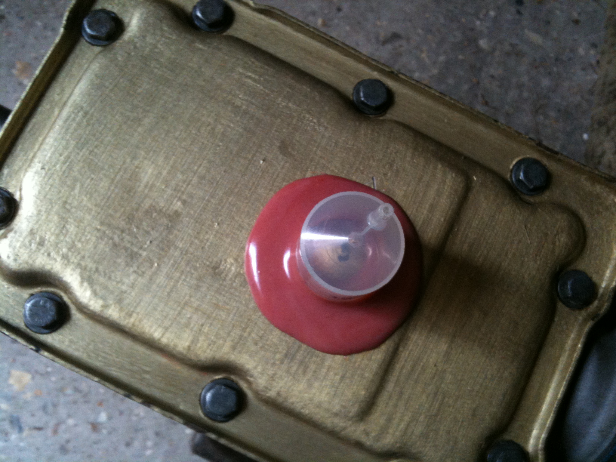

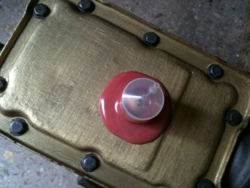

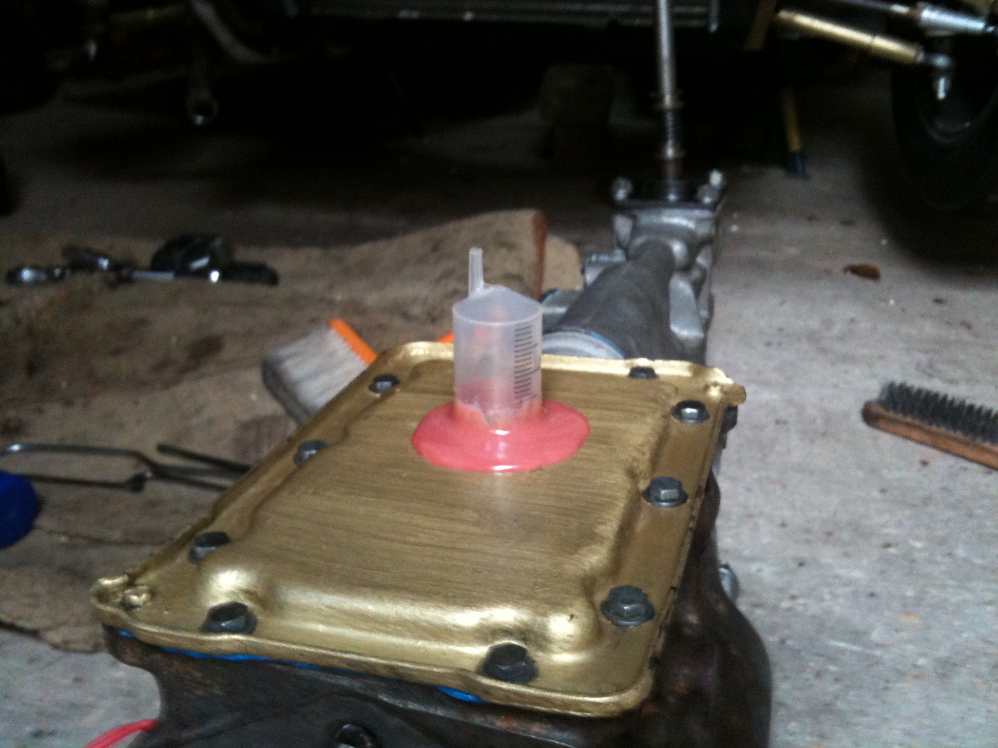

All very solid this morning , although does look very odd , especially the pink resin glue :oops: I scratched all the gold paint off and scored the metal before putting it on.
Might want to paint over the glue :lol:
If of course , I'd done it before taking the box down to Brian , then it could have been a metal tube but didn't think about it at the time :roll:

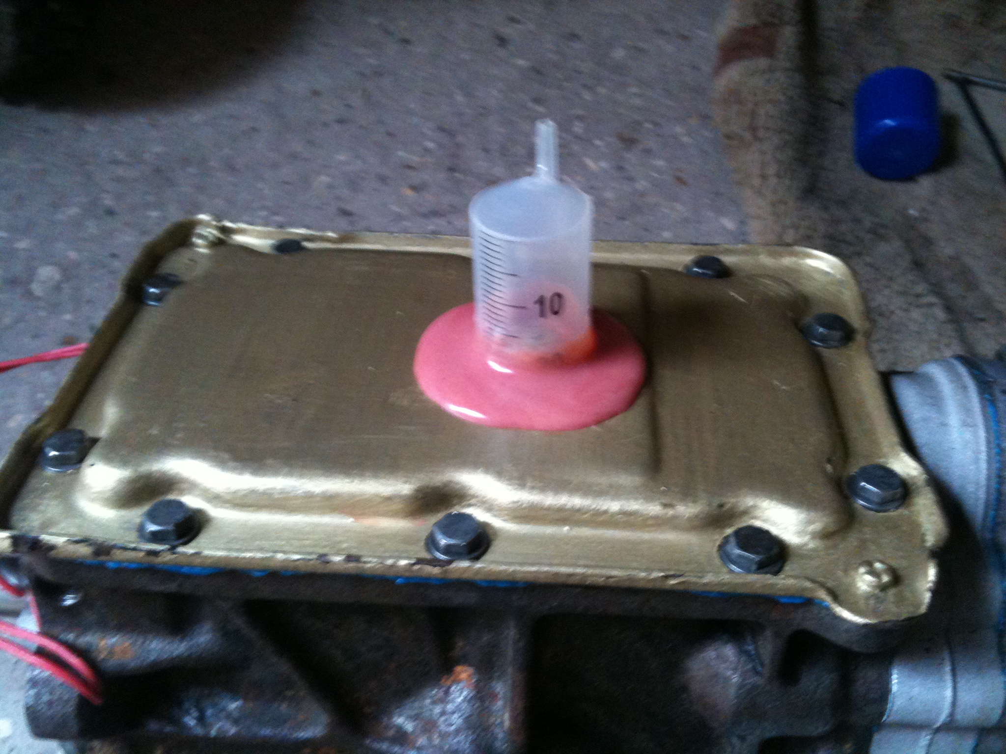

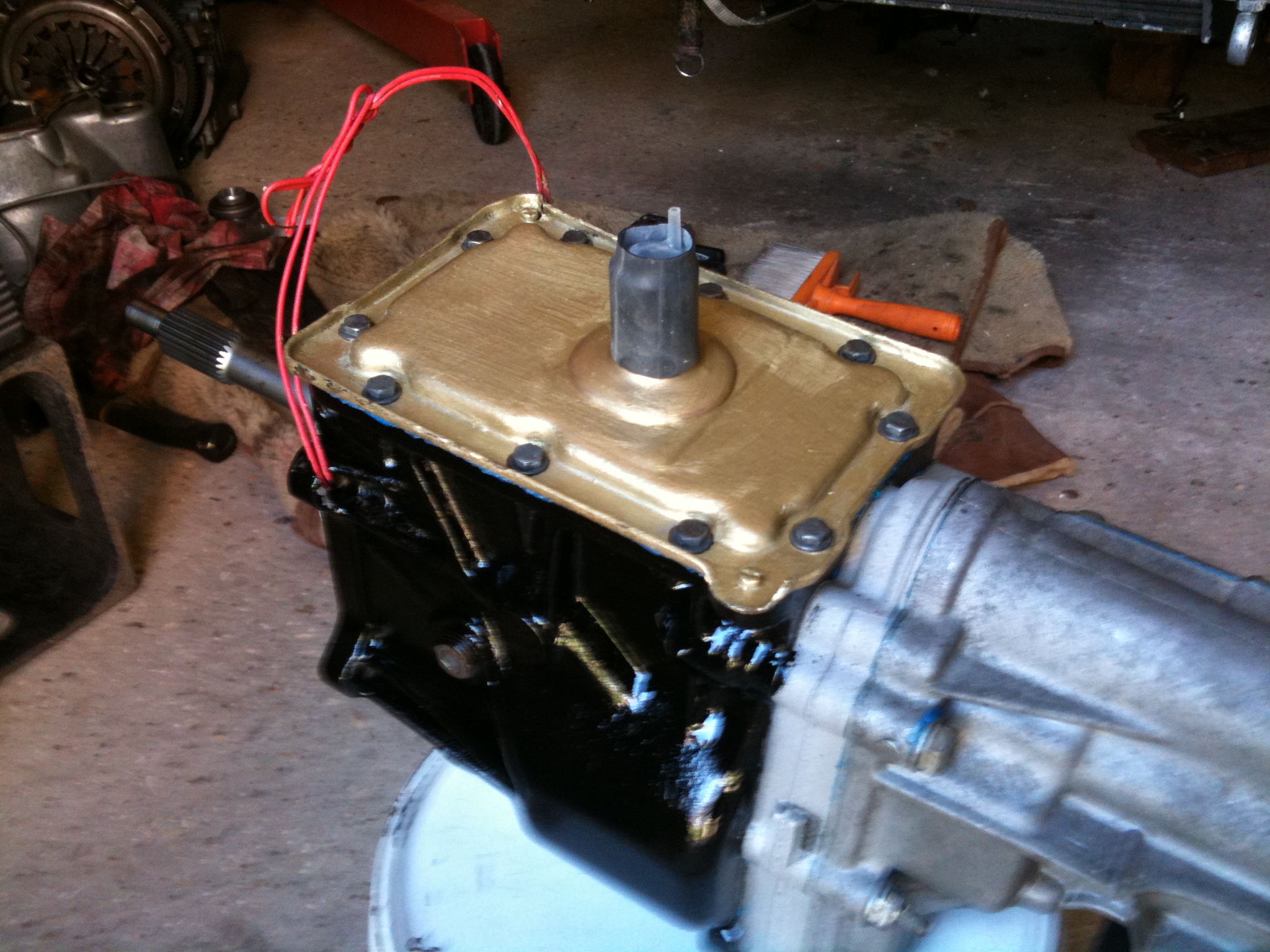

Better now :)
File comment: paint plus cycle tube !
