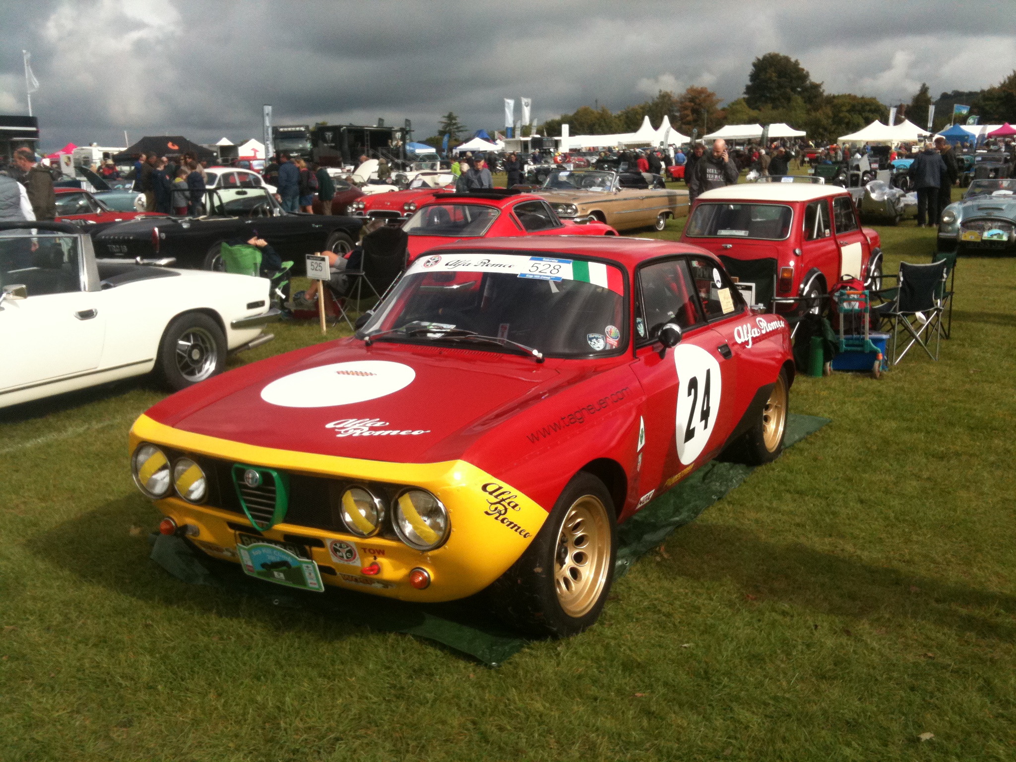

It was the KOP HILL CLIMB this weekend and my first run was great , a chance to sus out the very steep left right turns and sudden changes in gradient . On the second it was not as planned ie. I'd wanted to really nail it . Sadly after a great start from 1st , 2nd then 3rd at close to 7000rpm (rev cut is 7000) , there was a really loud massive multiple backfire then the engine died . Checked a few obvious things then came to the conclusion that the dizzy drive might be sheared , so got it home then tomorrow after getting number 1 to TDC , I'll remove the dizzy for a peep :shock:
SO -- if I can't sort it by Thursday/Friday then I can't compete at Goodwood which will negate any ambitions I had for a good championship result again . We'll see anyway , at the moment it's still in the drive sheeted over to deter thieves because I can't push it through past my house into the shed , via the lawn on my own. If I can't make it I'll post here again ok
Posts: 3770
Re: Tunbidge Wells motor club Goodwood sprint 23rd Sept
Dizzy drive isn't sheared , the clamping nut was loose , even with it's spring washer , so the dizzy wasn't properly engaged and one of the O rings had slid upto the top against the clamp so wasn't engaged by it's full 5mm's . So new O rings fitted with silicon gel , just waiting for the new rotor arm via CA in the morning .Hopefully that's the only problem and I'll be at Goodwood Saturday .

Two days now and no post from Classic Alfa with my new rotor arm :( Need to put it in the dizzy then get the engine timed up , to know whether timing was the only issue :roll:
Posts: 3770
Classic Alfa just said they'll send me a duplicate order via DHL a few minutes ago :) -- just got to post the other order back if and when it arrives
Posts: 3770
You couldn't make this up ---- apparently our village road works with subsequent diversions confused the Post Office , hence yesterday's post delivered just now . All fitted and timed up , running sweetly now :P
