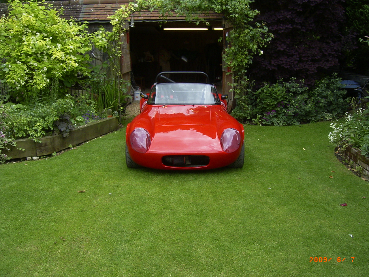

I'd already decided to black behind the lenses as they were before when the lights were in place. Since fitting the lenses though I've come to quite like them showing the body colour so I'm leaving it for now

Looking good Rob you must be pleased, the paint job good.

Very pleased with the job Joe Middleton's done and he said he barely had to touch the arch extensions they were so smoothhearbear wrote:Looking good Rob you must be pleased, the paint job good.

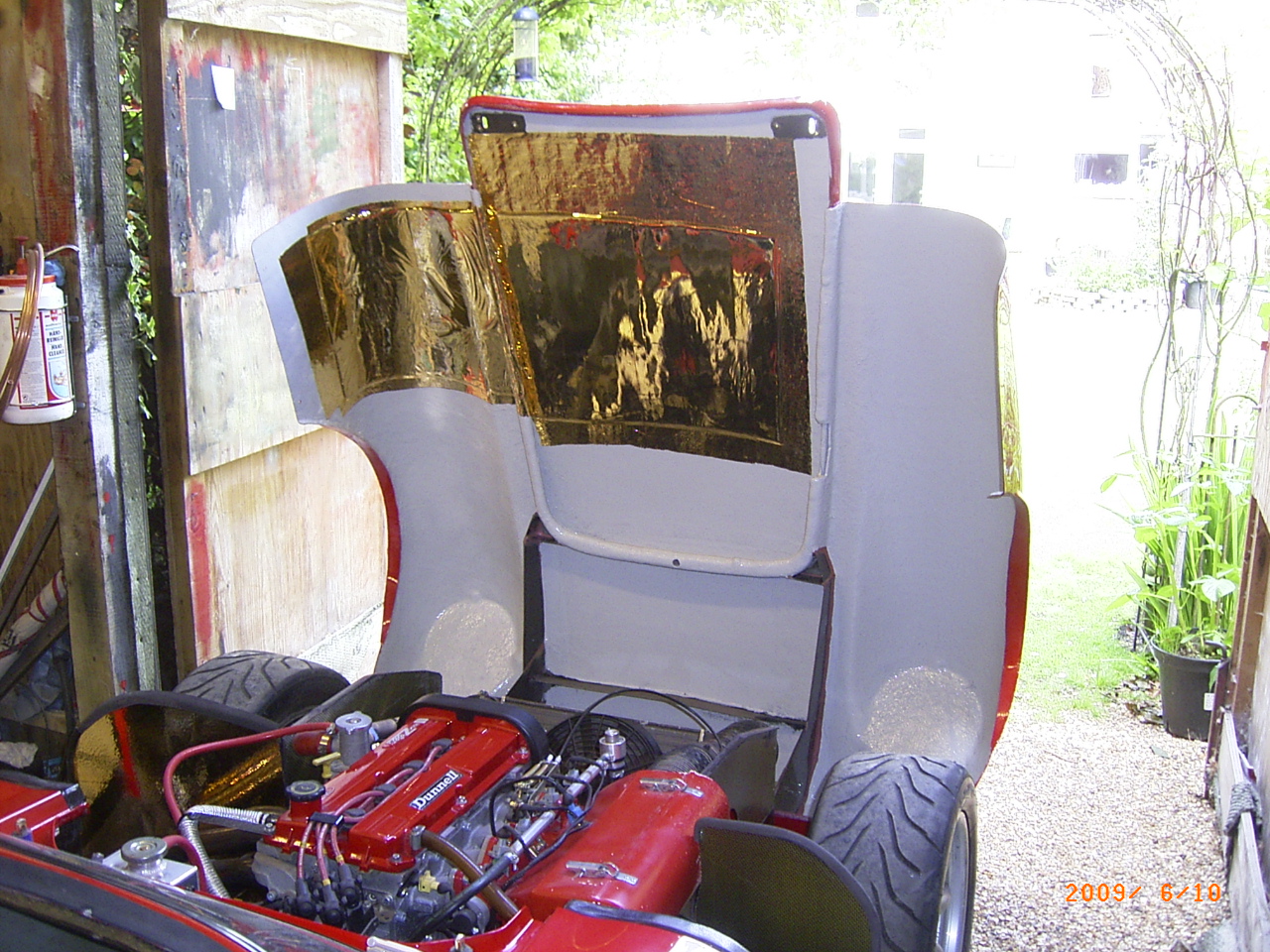

RE- light covers , did you mean '' did I get any ''
I've glued the heat matting to the underside today and covered it with reflective ' bling '
Can't wait to get in the damn car now --- the 27th of June's a looong way off

Painted underside plus heat mat

Be interesting to see how the heat pad works on the 27th

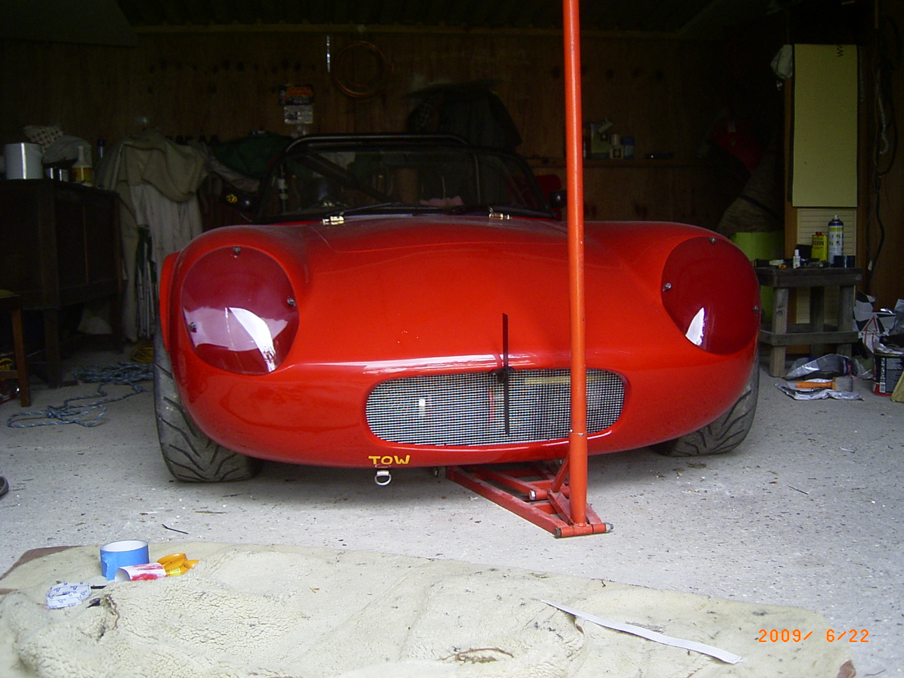

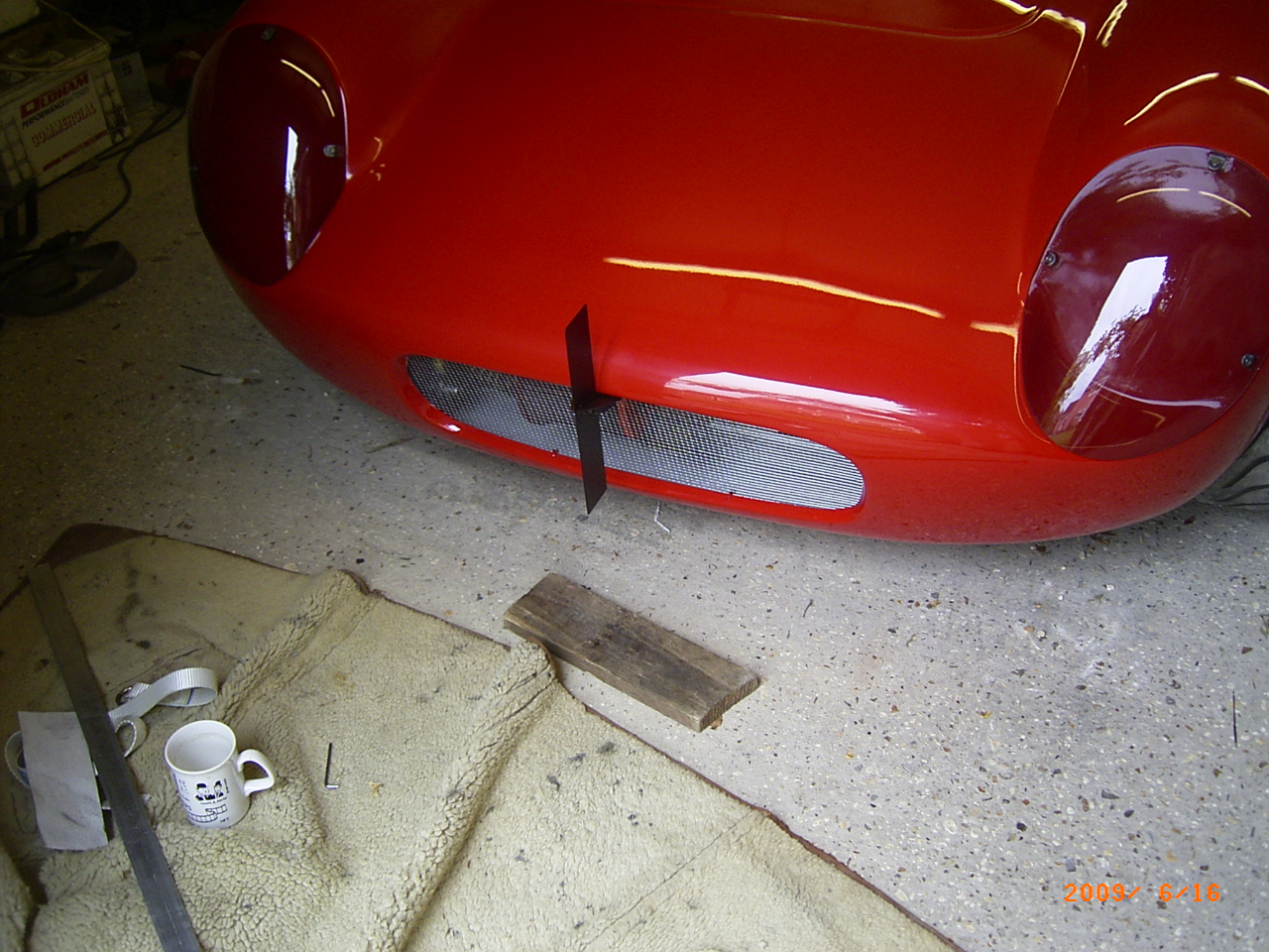

Grill mesh in now
and carbon timing strut painted mat black as per MSA reg's

looking great Rob - but I thought I remember somewhere that a fine mesh restricts air flow quite badly, I think you're supposed to go 1/2" or more....?
Re: body parts
Well it's 6mm square holes of 1mm diam' wire which is what I've always had without a problem . If you use 1/2 inch or more you totally defeat the object of a grill at all . Anything that can get through that will either block or bust your radiatornorma wrote:looking great Rob - but I thought I remember somewhere that a fine mesh restricts air flow quite badly, I think you're supposed to go 1/2" or more....?
You probably didn't notice the old grill because I painted it mat black

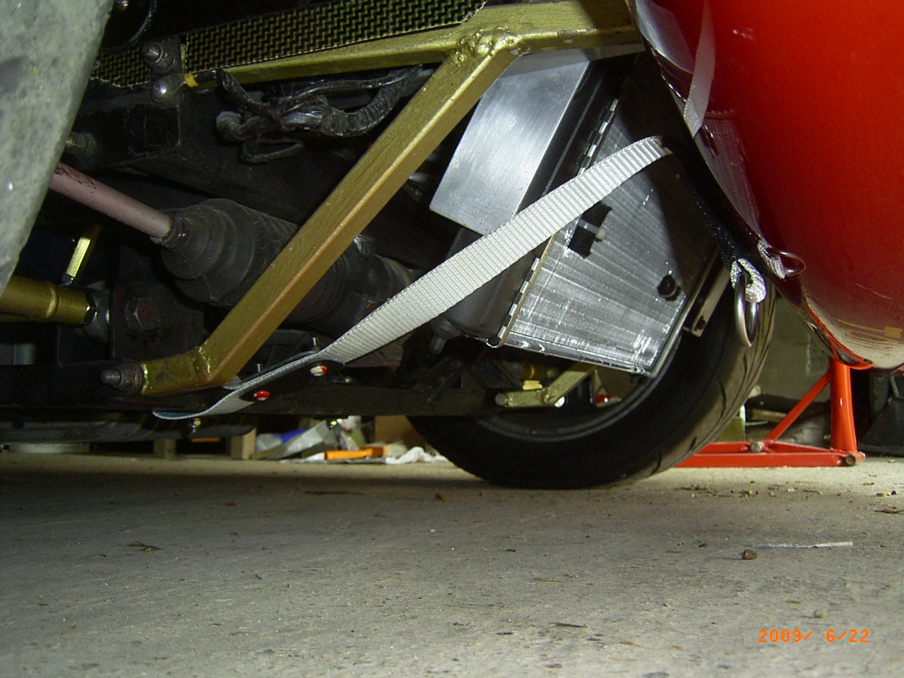

Finally sorted the ' MSA Tow hook ' requirement
Used Kevin's idea , using tow strapping but with the hook end velcro'd onto the underside of the front valance
Having a grill made it awkward to velcro it on the inside of the grill valance ---- the scrutineers would probably moan about trying to reach it from behind in a hurry
Just have to hope the velcro holds it tight so's it doesn't drop off at speed and flail around whopping the radiator
The male velcro is SIKAFLEXED onto the strapping then the female strip is SIKAFLEXED onto the fibre glass --- paint roughened up first
The velcro area is about 25mm x 75mm --- we'll find out on Saturday
