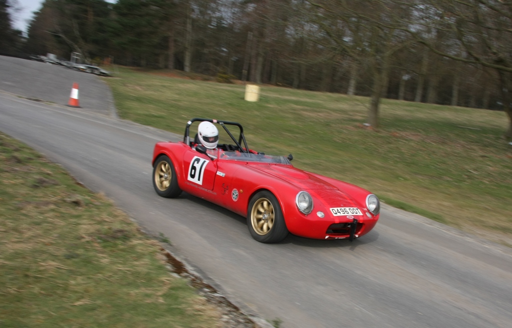

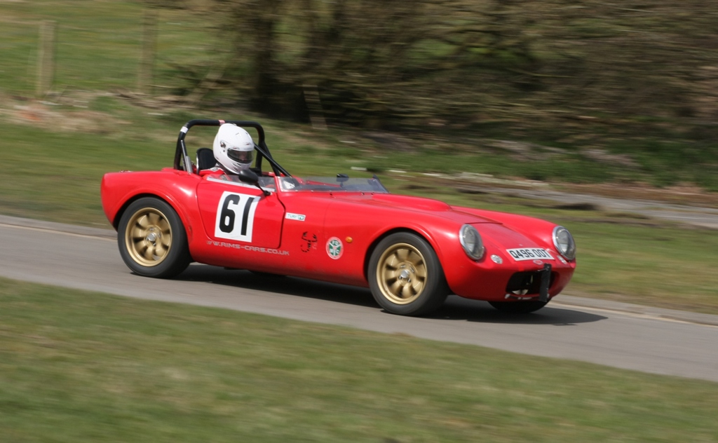

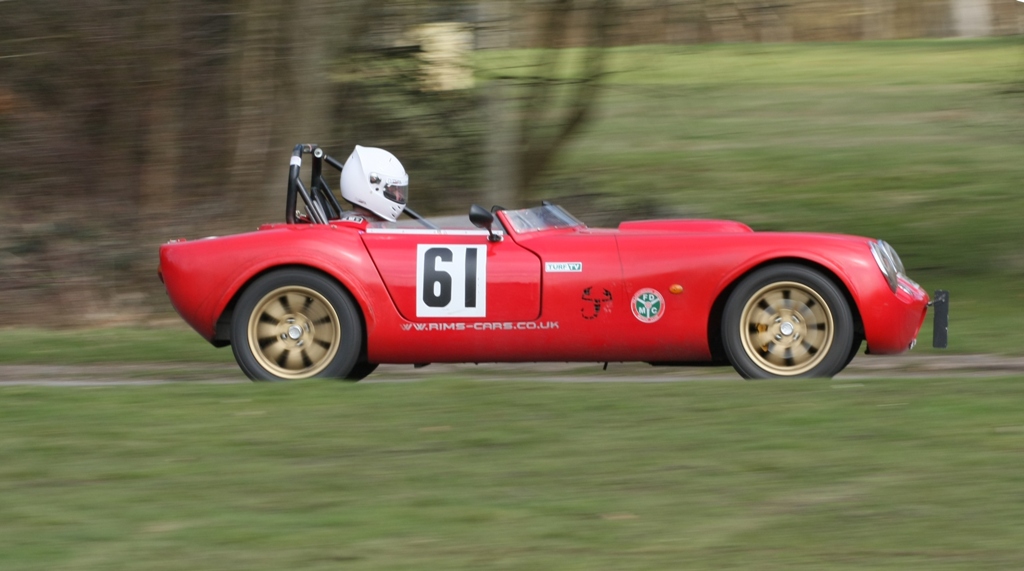

Stylus having fun !!! 8)
(will have to sort the rollbar height, its abit tooooo low) :wink:

Just looking at your rollbar Matt , isn't it the same height as mine :?: Thought you'd asked me at the time to measure mine. Mine's 23 inches to the top edge of the bar , from the flat inner f/glass body behind the seats , then my head plus helmet is almost 5 inches below the bar top edge .
Possibly your seat is in a mounting frame :?: Mines touching the steel seatpan , with rivnuts set into the seat bottom. Then I've got pieces of alloy tube with hose over them (bolts through these into the rivnuts/front) to lift the seat front up 60mm's .
If yours has a frame then sitting it on the deck at the back will gain 40mm's -- check out my circuit pic's :wink:

Hi Rob
there's some history there... ( & it's too late now :-) )
We measured yours, Tim added a but on, then asked Caged to make it.
Caged took too long, so Tim cancelled with them & had it made locally.
The one that subsequently arrived was shorter than first ordered, but got fitted anyway.
