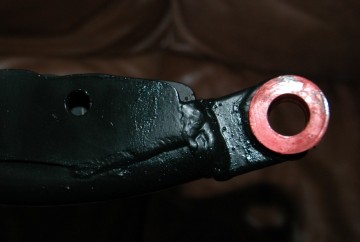

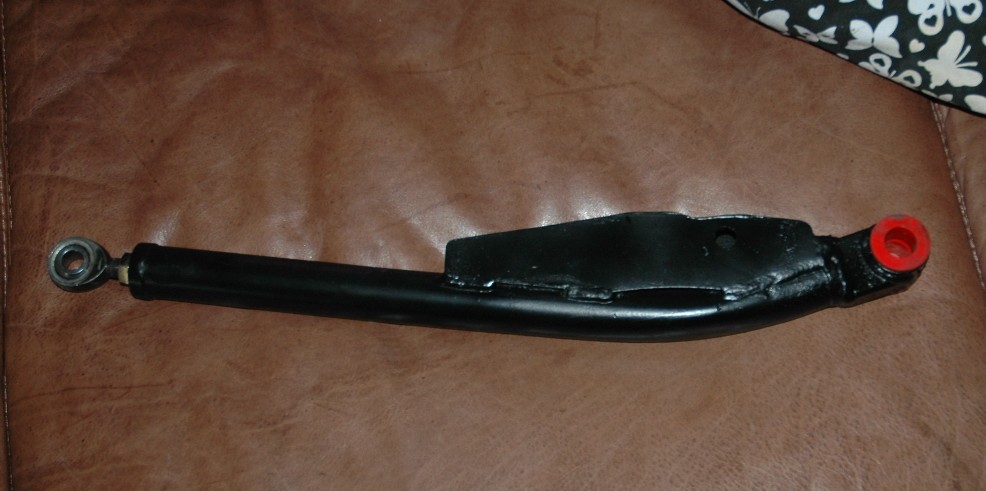

sorry Matt, wasnt paying attention, i thought you said Tim made you a set and they broke so i assumed you had another set done. also didnt click which end was rod and which was bushed. I get it now.
Rob, your explanation makes sense to have one end bushed to stop it braking. I'm not replacing the rear shocks/springs as what i have seem to be doing the job so i will rod the chassis end then, thanks gents.

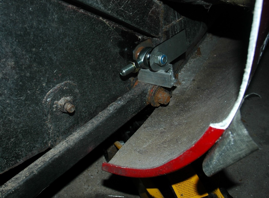

As for rear arb, not sure which picture you mean Rob, the car set up changed when it was painted so ignore any that were taken before it was white but all the ones from the front tell me the front is staying pretty flat, even under extreme cornering. But the back is up on its haunches. I reckon my car weighs a bit more at the back having the bigger axle and diff. The front ARB seems to be doing the job quite nicely, it certainly feels right and has stopped liftingg the front inside wheel and i get no understeer , but to get one strong enough to control the back aswell it would have to be pretty meaty. Stronger front ARB means more understeer if i understand things corrrectly and we dont like understeer do we rob

Rob, out of interest do you know if the arb i have is a stock fitment for the stylus or a fisher etc? i would like the same shape roll bar but in solid rather than tube as it will be much easier to fit?
It wont cost me anything to fit one so i may aswell give it ago and then let the pictures tell the story, if it doesnt work, i will try something different.
I have a set ford focus RS ARB's which i am considering fitting, although the front is quite thick and not quite the right shape but i reckon i could resolve that and make it fit. They were £10 on ebay so worth a try. As you may have gathered, i like to try things myself and learn from my (many) mistakes!
