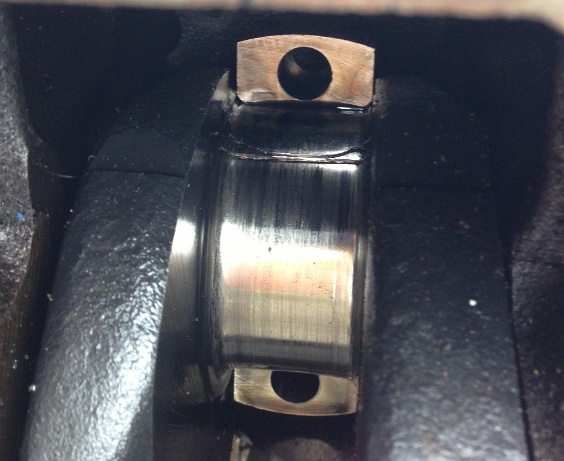

Crap photos... too busy working on the car to take pics
