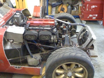

Here's a pick of my old 2ltr silvertop zetec setup, about 5 mins after I'd cut the front off & about 15 before the engine came out for good.
(Blimey does that look a simple layout compared to what's in the car now
Difficult to see, but its the long version Jenveys (DCOE replacement), with 2" ali rampipes & ITG dual port air filters, all on a Raceline inlet manifold.
It was reasonably tight, but did all fit under the bonnet.
The horizontal clearance was never a problem as they went into the void under the wing.
What was more of an issue was the vertical clearance on the front TB pair to the underside of the bonnet gutter (as the bonnet narrows & drop towards the front). I just cleaned it up with a power file to suit.
But a big K&N airbox or similar probably would be a real problem. Rob F has an F3 style airbox under his bonnet, and uses the shorter style TBs from Dunnell.
