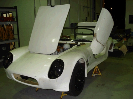

Well, I can finally get some phots onto the net about my door project. Still some minor and one or two major teething problems regarding piston strength, but so far nothing pushing itself through the fibreglass. the basic premise is that the door pops open sideways to clear the A-pillar (including window), then rises vertically.
Note the hinge arrangement to move the horizontal axis sufficiently high so as not to block the door, but the rather poor development process has left the hinges on the vertical axis relatively low. The problem now is the leverage the strut is applying to these hinges, is making the door slightly wobbly
when open. At this point there doesn't seem to be much loss of stability to the door when closed.
Current speed-bumps on the road to progress include the limiting stop, and a mechanism to damp the horizontal movement of the door. Some sort of guiding rail is currently the best candidate for eliminating both these problems.
However, I am open to greater engineering experience (ie advice) from here on in, or any particular brainstorms on the basis that many hands might make light work
