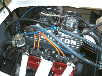

Zetec will b along after sva .but 4 now it crossflow
i under stand that i need leta from fords to confrm the year of manufacture for the crossflow
ive got the engine number dates it to as 1972.any one have the address or contact details for ford.
As you put it Kevin ...the beastie is just a 1700ish crossflow lump with twin 40s
pushed along by steam WHen sva has past i will be lookin for a Zetec but for now
