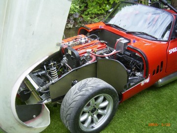

i don't have rear wheel arch liners at all on my car. i haven't even painted the arches and also the front i do not have any. only something that attaches the lower part of the bodywork to the chassis rail to stop the body flexing where it was cut for the flip front
