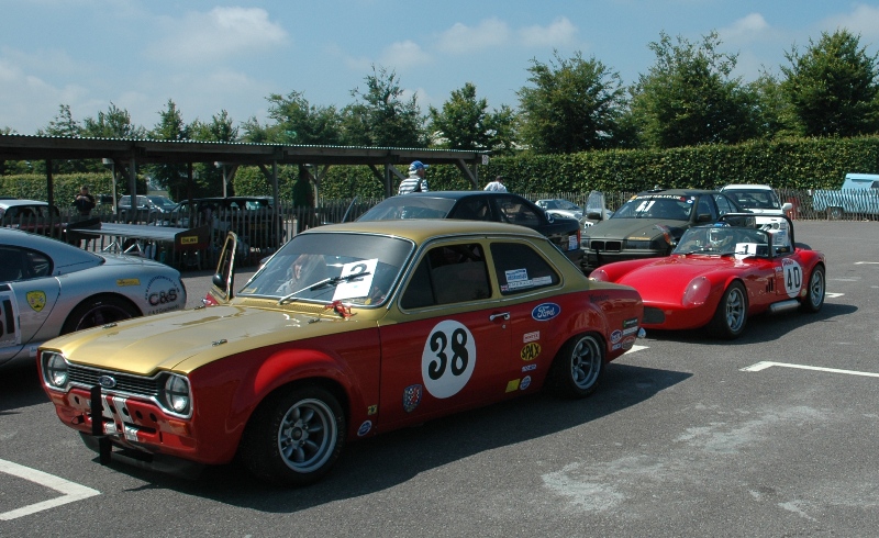

stylussprinter wrote:Seeing as you're so stuck on the ST170 , I'll throw in the fact that one of my competitors has a 615kgs MK1 Escort spaceframe fitted with the ST170 engine ------------ it has 280bhp plus runs on 10 inch rear 8 inch front slicks ---
The ' rub ' is that my little 600kgs Stylus 231bhp silvertop , on road B1 tyres still beats it , granted not by a lot but enough :wink:
a win is a win though! is that due to driver more than machine or is the escort not setup as well? on paper you would think it quicker but is more than power alone, as my dad always says is the sum of the parts. The 280hp stands out to me though, that in a stylus would be good, is that NA? I would assume is a mega money car!
Calum
It's naturally aspirated and the driver has won oval championships over a 20 year period before changing to sprints. The other point is his personal driving style ie. tail out as opposed to ' smooth ' calculated approach/apex/exit --- looks stunning though in the ALAN MANN colour scheme 8) --- I was amazed when first meeting him and being told it weighed 615kgs :o but then once the boot/bonnet were off all that could be seen were two 45mm tubes left/right and front to back with some tiny cross members.
We are normally just over a second apart on good dry tarmac but if wet and he changes to AVON soft wets he's VERY close or faster by a second ---- but as luck has it on most occasions the afternoon dries out for me to just sneak a win :P

Re escort does not look spaceframed thats a well done car, sideways doesn't get you forward quickly however!
