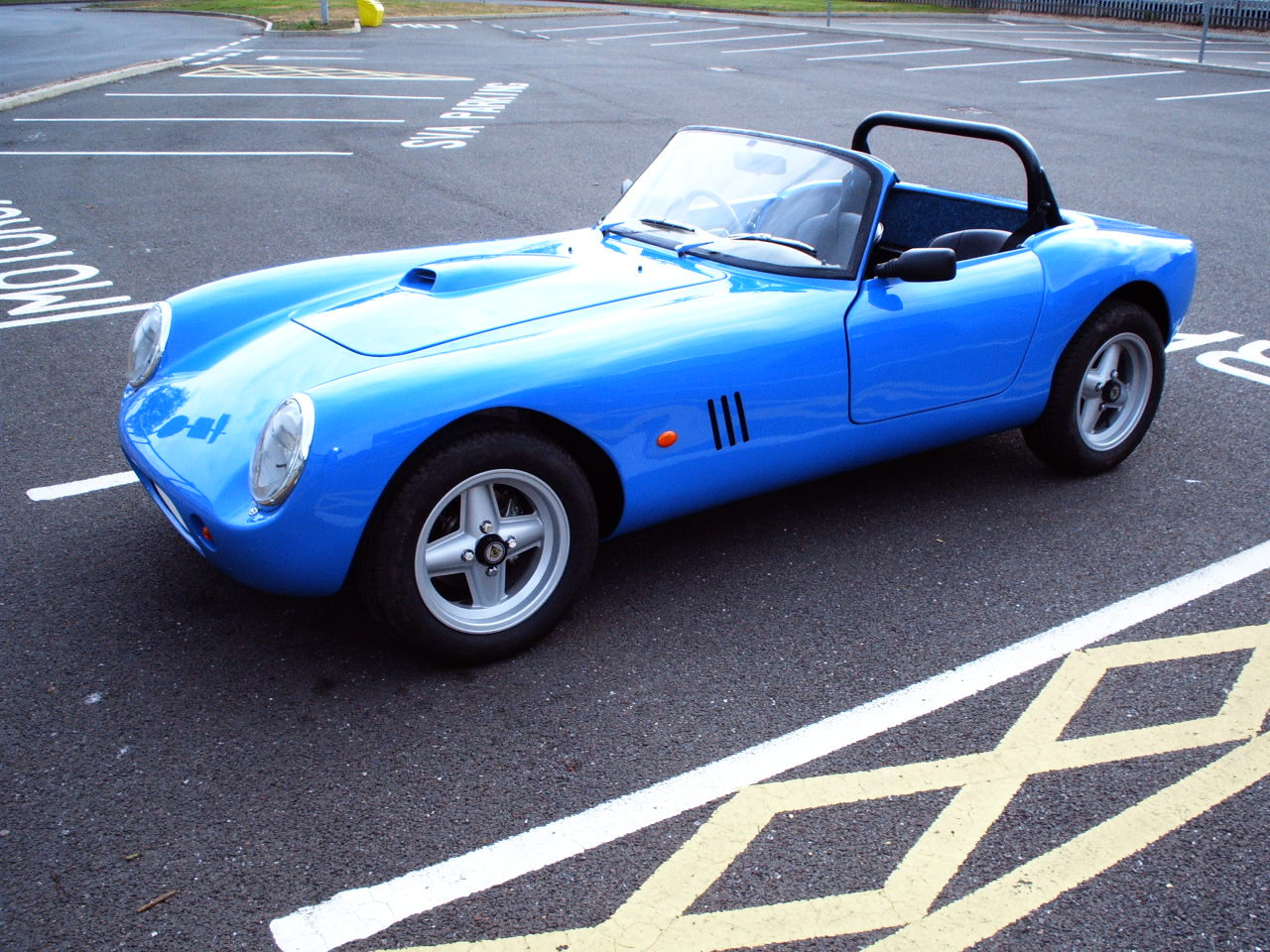

Thanks for your responses so far. For clarification on the roll bar issue, the testers argument was that as the top seat belt mount is integral to the roll bar and the roll bar is then bolted to the chassis then these fixings are also classed as seat belt mounts and have to prevent the box section from crushing when the rear roll bar stays are bolted to it through the boot floor. To prevent crushing I drilled through the box section and used two bolts per side with nyloc nuts, both sides were fitted with external steel plates to spread the load and prevent crushing but the tester said this would not suffice and wanted either welded captive nuts or internal tubes which must also be welded inside and out side the box section. The job is do able but is just going to be a hassle!
For reference the car has an escort rear axle and the paint is VW summer blue.
