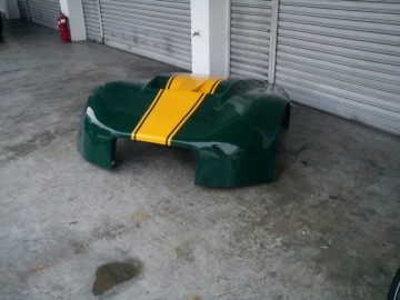

Been meaning to post here for a while but had a problem with the pictures, (which Mat has now solved. thanks). End of last year I hit the wall backwards, on the start line at Sepang at 125MPH, having spun in the wet, moved the back axil and had to do a lot of work on the body, so 6 months of work, and I know have;
The body 6inches wider, full flat floor and rear diffuser, front spliter and removable front end.
Bigger turbo on the SR20, which has been fully rebuilt, open exhaust exiting aft of the front wheel, new inlet, bigger injectors,
Rear axil now located with round air craft alloy training arms, rose jointed, with the upper links kept rubber.
The new body is around 50Kg lighter and the whole car on 17 inch wheels is now 675Kg with fluids but no fuel.
Brakes are of an Evo 6, radiator, inter cooler and oil cooler are fully ducted,
Roll hoop replaced with a full FIA cage, Hans Compatable seat, new six point belts, Haltech dash and ecu, and a date logger fully plumed fire system.
On a calbrated rolling road we got 374.8BHp at the road wheel, so allowing 30bhp loss in the transmission this is 600BHp a tonne.
Uping the boost gave over 430 but we decided it might be usfull to have a bit of reliability and finish.
Run the car yesterday and awsome, but gear box let go and couldn't get 4th so no fast laps, new gear box goes in today ready for racing this weekend, currently looking for a dog box.
Car won the championship last year and is now 50Kg lighter and 70 bhp up on power.
New shocks and springs have not arrived yet, so will run the weekend with the old ones.
