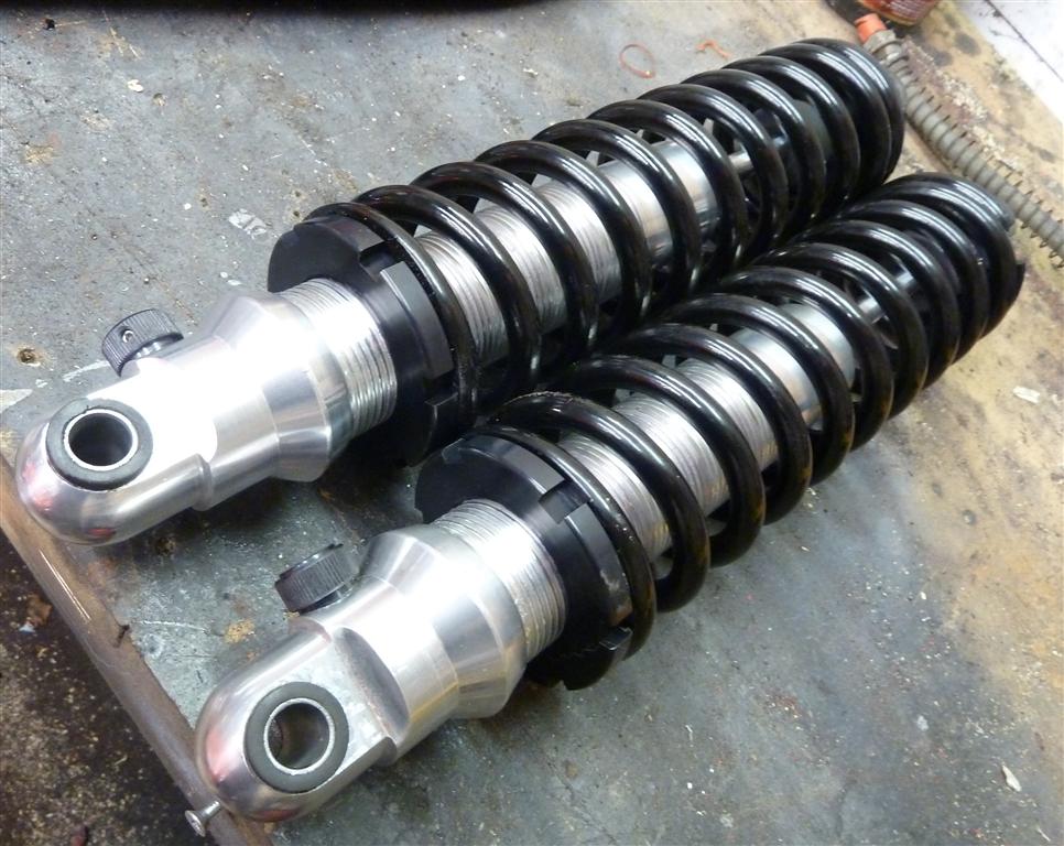

Well, the new shiney Protech bits arrived yesterday and I popped my 200lb springs on
Fitted them last night and set the ride height to something like. Just need to wait for some decent weather and see what they're like.
Procomp have re-valved them for the weight of the car and the intended spring rates. So no idea what damping I'll end up at but popped then on 6 clicks of the 13 for now.
If anyone is interested my old Gaz dampers weighed 3.6kg for the pair. The new protech ones weigh 2.4kg for the pair. (without springs)

Nice bit of bling!CMA wrote:Well, the new shiney Protech bits arrived yesterday and I popped my 200lb springs on

Well, finally got out for the 1st run on Saturday with the new rear dampers on. Set currently at 6 clicks of 13 with 200lb springs.
And as it was icy and even slushy snow in places and I still had my R888s fitted I didn't push it much but over the bumps and pot holes we have in abundance around here the ride felt far more secure and accomplished than it ever did on the Gaz's, no more crashy'ness just a smooth glide. You can tell they have been revalved for a lighter car compared to the Gaz's damping, so far I'm quite impressed. The acid test will be once I get it back on the track and see how it is then.
