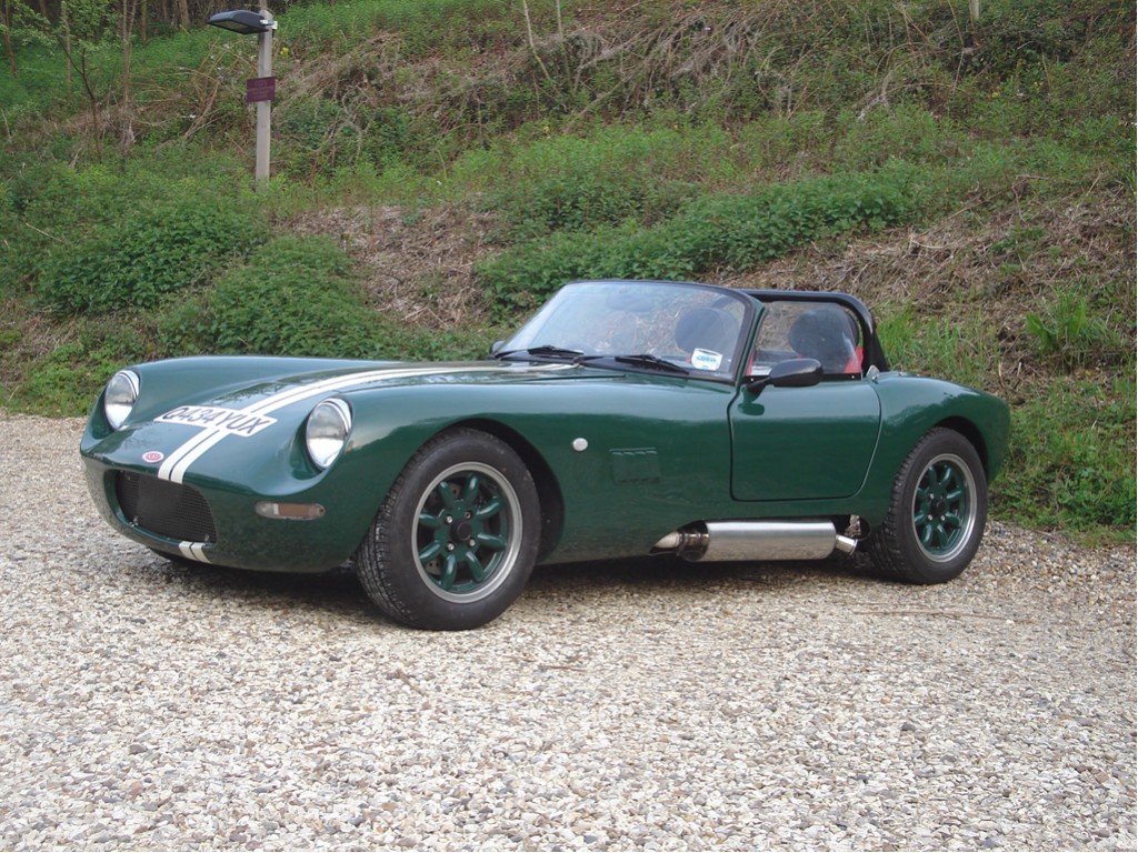

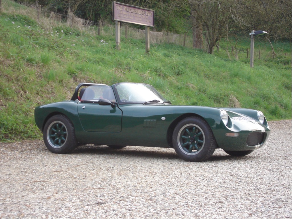

A quick update to the saga of the little BRG stylus.
It passed it's MOT today! :D so I celebrated with a trip out to a country pub (no alchohol for me) to mark what is a bit of a milestone. The car has given me a few moments of grief over the past few months but the effort has been worth it. Bit of a scare on the MOT as one of the front brakes was refusing to come on and off as quickly as it should have. Turns out that the hoses if screwed fully in to seat in the calliper were partially blocking the fluid ways to two of the four pistons :o . Sorted with a couple of banjo unions into the calipers and hoses into the unions. :)
Still lots of jobs to do, but for now, here it is
apologies to any afficionados of gold paint brightwork :wink:
Cheers all
Kev

I think it looks great Kev' . The gold was just a way to tidy up an otherwise messy silensor so did other bits to mirror it :roll: Interesting you should mention the calliper problem :) Unfortunately it is or was a fault of design in ' that ' particular manufacturer's calliper. Originally discovered by Neville Powell NHP engineering on this forum/Babybertha :wink: He was fitting new ones to a Fury so phoned them to say he had to resite the hole :roll: They weren't helpful , denying all knowledge :roll:
Hope you didn't ' chuck ' the gold ally ' cover :?: Sell it , it cost £40 for the piece 1 mt x 300mm :o
