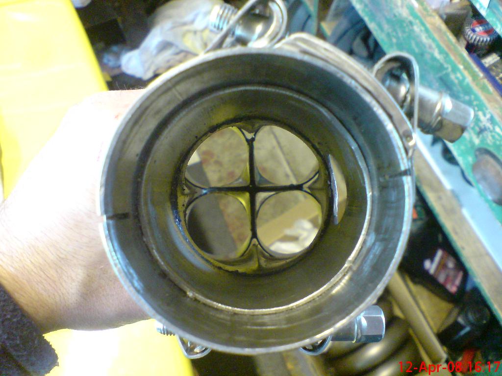

After a long delay (which was mostly caused by having to fit a new bathroom) I have a 4-1 collector with 1 7/8" in and 2.5" out.
I also have 6x180 deg mandrel bends in 2" and 6m of tube in 1 7/8".
This has been done as the 1 7/8" is an interferance fit into the 2" bends, therefore I can fabricate the whole primaries section without touching a welder, then when I'm happy, I'll file off the blunt edges of the 2" bends (for flow) and get the whole lot welded up. :mrgreen:
Watch this space..... :shock:

Collector viewed from 2.5" end
SSC Sylus 2.0 Dunnell Black Top Zetec weber alpha / DTA + cams, 236@fly. (aka NORMA)
