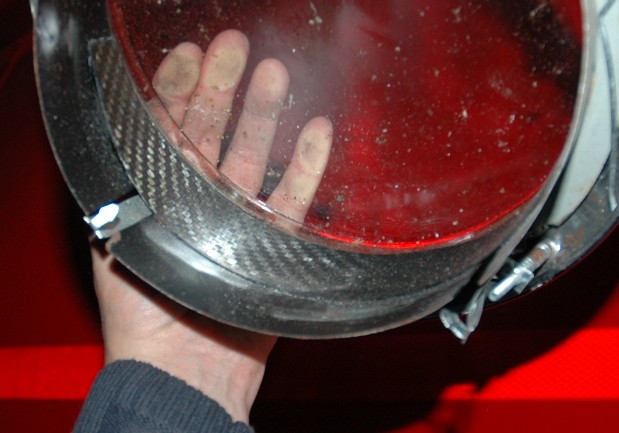

I've had halogen vw/porsche units on the shelf in the garage for 2 years :oops:
Just gone from 60W Main /45W Dip to 100 Main / 80 Dip ! :shock:

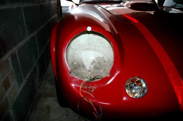

The pics should give you the idea on the Porsche type lights.
I've got SSC headlight bowls bonded in (so the tyres rub on them instead at full lock)
The headlight shells are as per your link, & they aren't US/UK handed (they're clear).
The headlight itself is any 7" unit, with sidelight. "Drive on the Left" type for UK roads.
I bought the original setup from Autocavan, now part of German & Swedish. Euro Car Parts should do them too.
The upgrade headlights I got from Europa & their part nos are in the pics.

Not sure what you mean by a surround :?: I've got photos of the lamps in the car but they're not fitted now as my car's too low to avoid ripping them out under HARD cornering on track -- hence just the 3 lamps :roll: email me at design@robertfarleylandscaping.co.uk for pic's if it would help. Don't want to block up this forum with photos already on here :wink:
SSC supplied the poly tinted covers but obviously didn't manufacture them so I'm sure they can be made/ got somewhere :roll:
