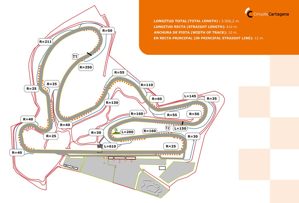

whats Cartagena and where is it? if its in the warm, it sounds good :mrgreen:

Southern Spain http://www.circuitocartagena.com/
