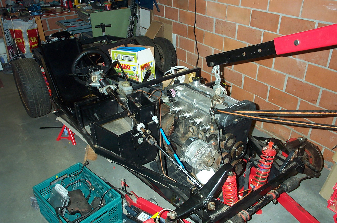

More progress last weekend and more questions off course. (clickable images)

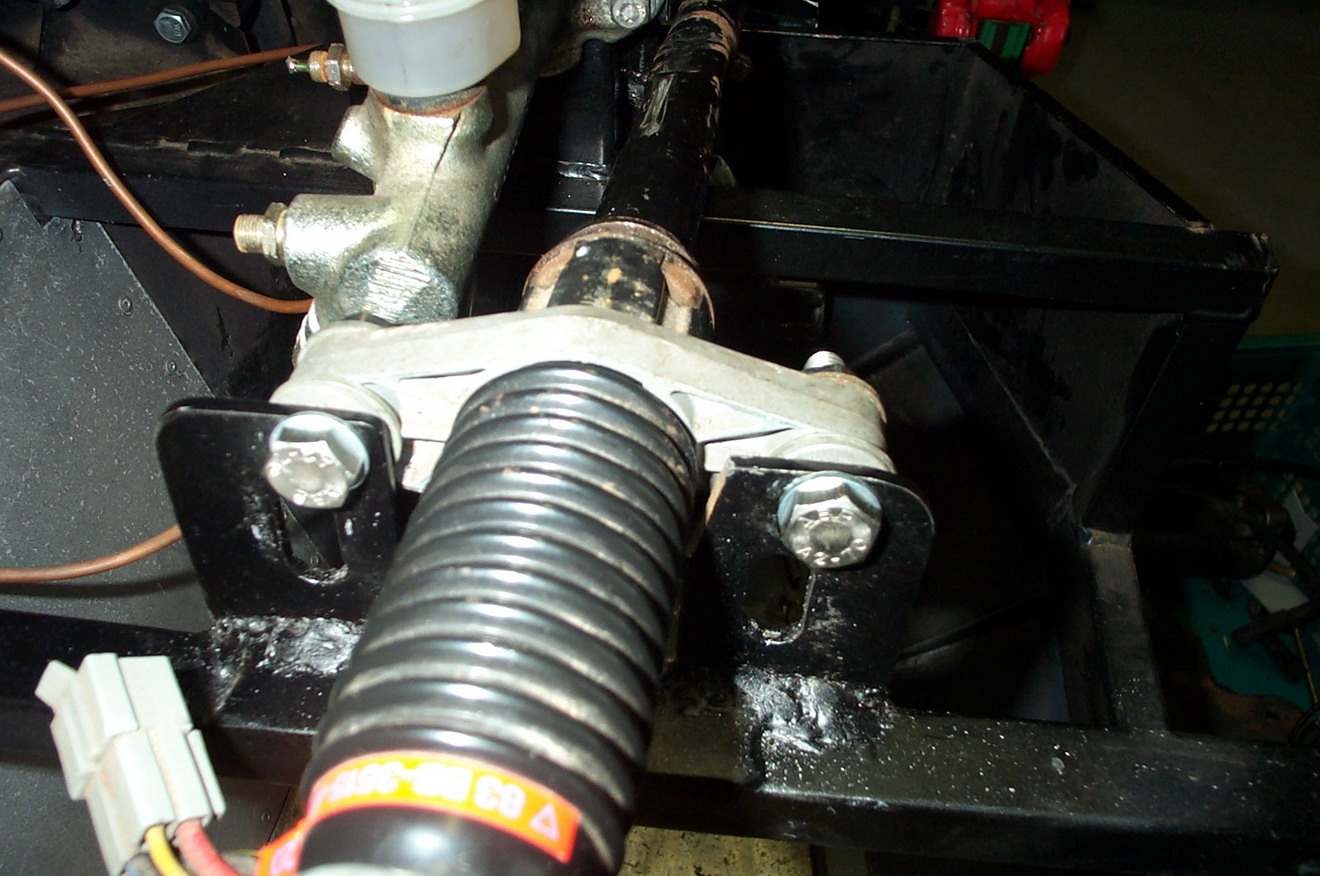

Relocated the steering column mounting holes as this chassis was originally for escort steering column, but previous owner added brackets for sierra column, but too much to the left so the column touches the throttle pedal.

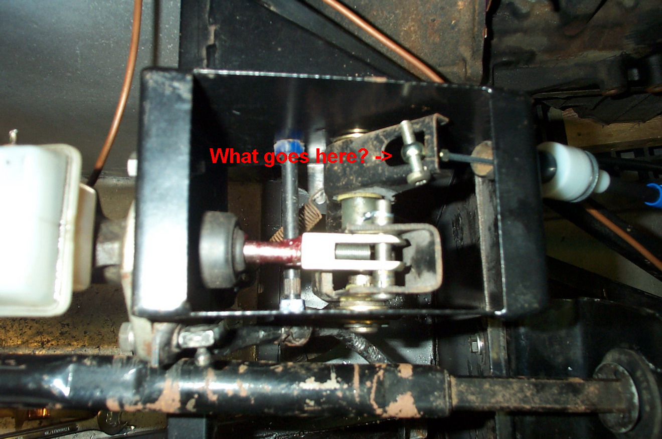

Was supposed to be better in the picture, but how is the clutch cable to pedal supposed to be?

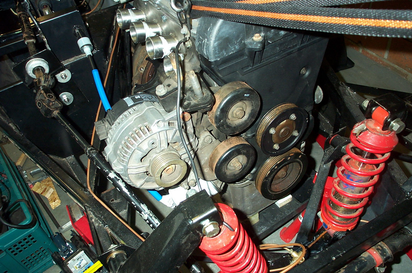

Anyone else using the original mondeo alternator bracket together with the idler and tensioner pulley? It's a bit heavy but seems to fit perfectly. And it clears the throttle bodies.
Overall view of the progress. Still need the engine mounts though.
I thought I gave you that with the master cylinder It's a little nylon moulding to take a pin where you have the bolt. I'll have a look in the shed --- just might have one Engine mount wise , I'd need a pattern really . I could make them up by measuring then leave the engine plate undrilled -- you could then drill the plate (3 holes)from your own cardboard/paper pattern off the engine block holes
Let me know if you're stuck and I'll do it That's a huge alternator and bracket Werner. I've got a Raceline one for sale --- alt' plus bracket kit.
Engine mounts are no problem, just awaiting material to construct them.
Never seen a plastic thingy, but thanks for looking.
Well, it fits and is free so I'll stick to it untill funds show the possibility, but even then it will be a raceline sump first, 2nd would be waterrail and 3rd the alternator+bracket.
