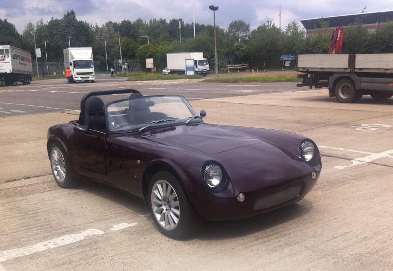

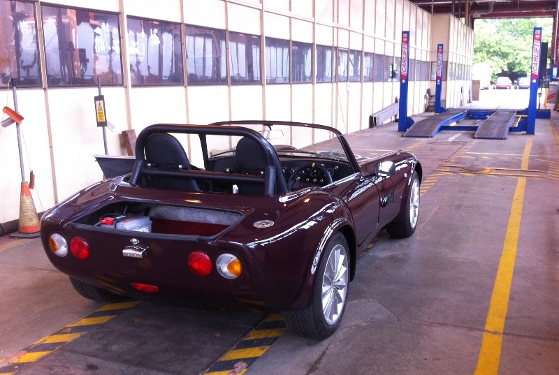

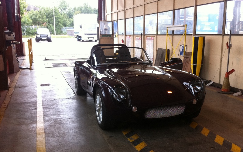

During the test...
Failure points being....
Mismatch of emissions for each bank of the V8 - failed on CO2 one side & H/C on the other (despite have been setup for MOT).
Seat bolts not marked with thier grade - 8.8, etc and the inspector wanting to see 100x100x4 load plates.
various wiring tidying - such as putting more sleeving on, supports, etc
one place in the tunnel where the brake pipe rubs the chassis.
Fog light working with sidelights only (should only work with dip & main).
All digits of VIN number stamping not clear enough & not on right hand side of chassis - gonna stamp & weld a new plate in.
Biggest one - failure on noise - 101db one side, 102db the other - 99db allowed. Its going to need a rethink in silencers

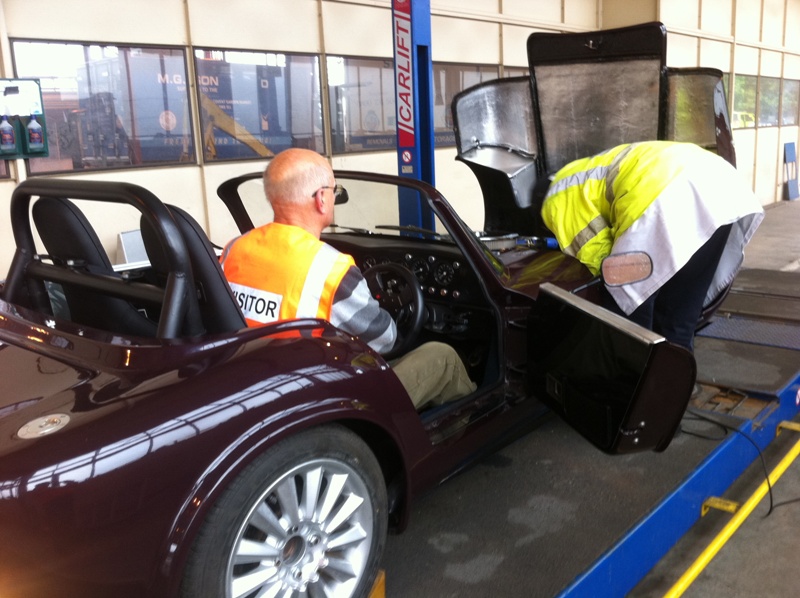

Oh, & a strip down on the upper steering column for inspection during the re-test, as he can see how its mounted.
And what was left after taking a few bits & pieces off .....
Positive overall, and the job list isn't earth shattering... but still annoying not to pass.Failure points being....

My guy just looked under the dash with a mirror and torch to see the column mounting Where do you go from there regarding the emissions Who set it up for mot I bet he's pi ....... ed off not getting a pass .

I also had to stip my dash & access panels for the tester to inspect the stearing mount & pedal box.

Yes its the steering & pedal box he want to look at, so obviously on their list !
Interestingly... its a new guy at Yeading... trained by the guy from Southampton.
Re: V8 Stylus Build
Hi Robstylussprinter wrote:My guy just looked under the dash with a mirror and torch to see the column mounting Where do you go from there regarding the emissions Who set it up for mot I bet he's pi ....... ed off not getting a pass .
Yep, I made sure the under dash was fully boxed in, so no chance of getting need heater & wiper motor, etc..
We took the column cowling off top & bottom, but that wasn't good enough for him to see !

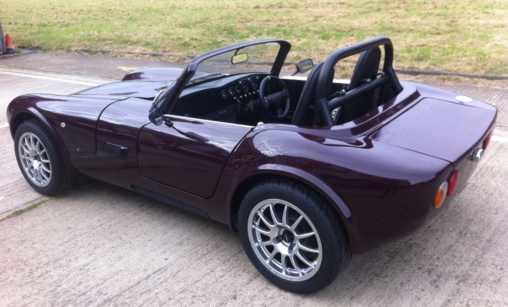

Was hoping to say it passed today, but no such luck
Passed 14 of the 15 failure points, including the noise & weight problems.
But still failed the emissions test on CO being too high, despite having been setup again by a local garage & having the print out to prove.
To be fair, the tester ran the test 3 times, but to basically the same result.
So some head scratching to do.... possibly remove 4 barrel Holley & revert to SUs for the test.
Well at least she looks good on the £800 worth of lighter wheels & list 1B rubber
