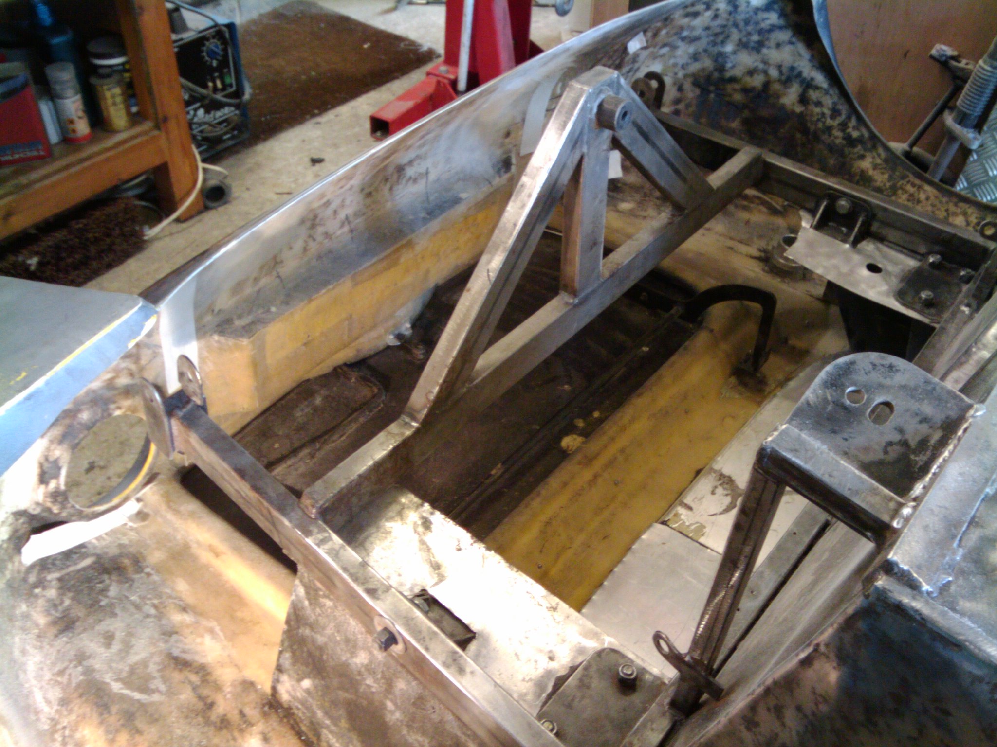

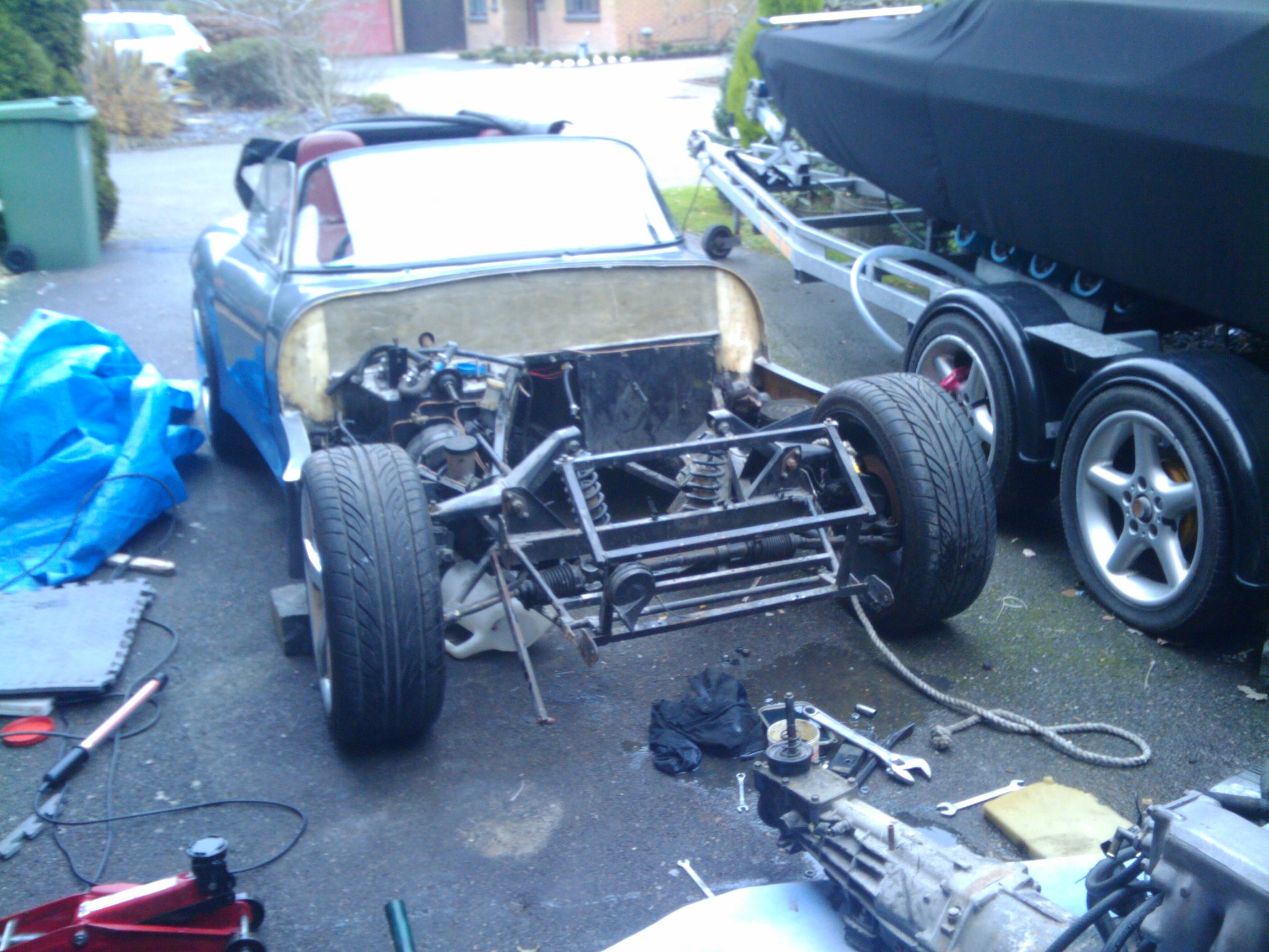

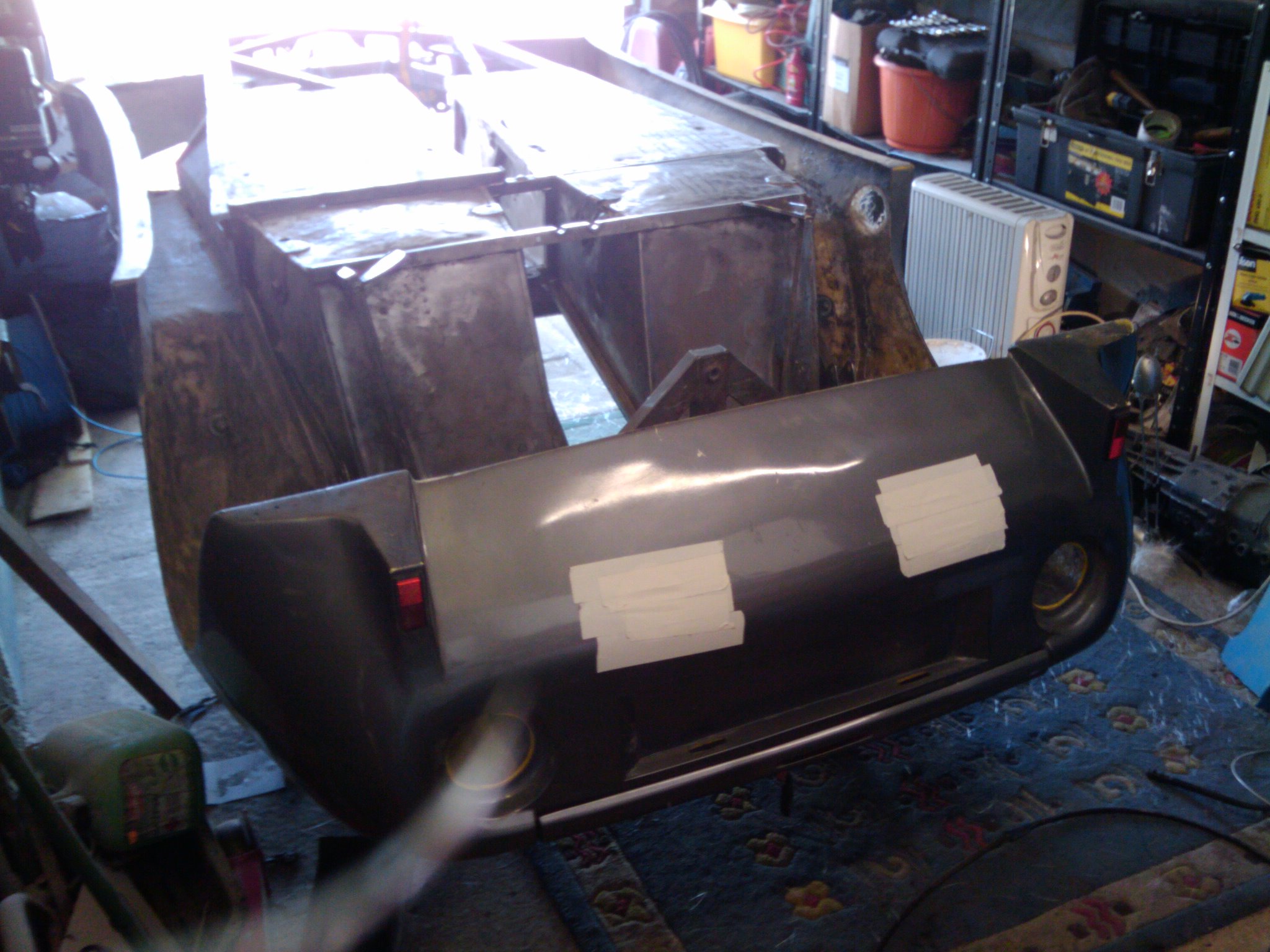

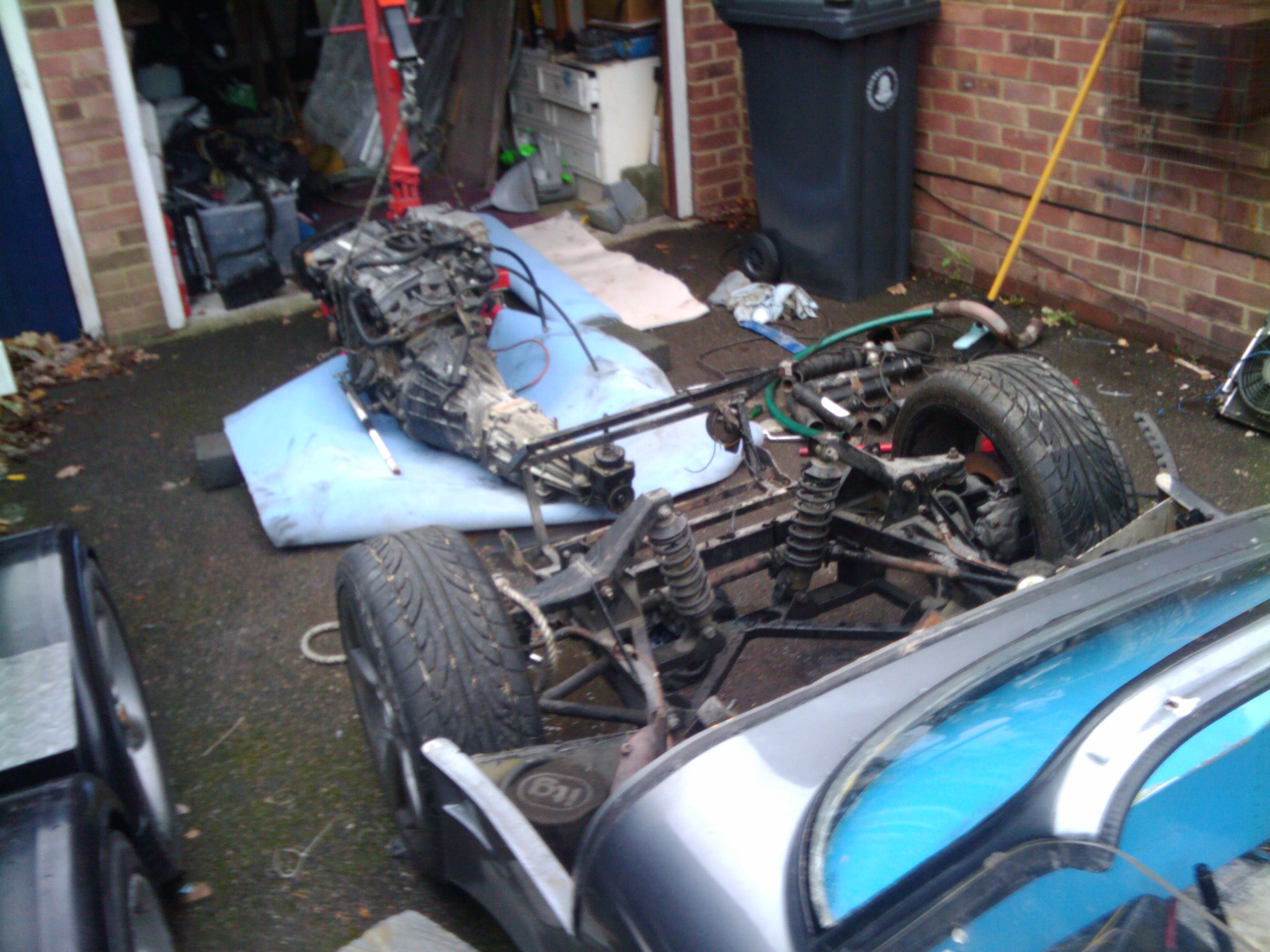

Flip front removed to make engine removal easy

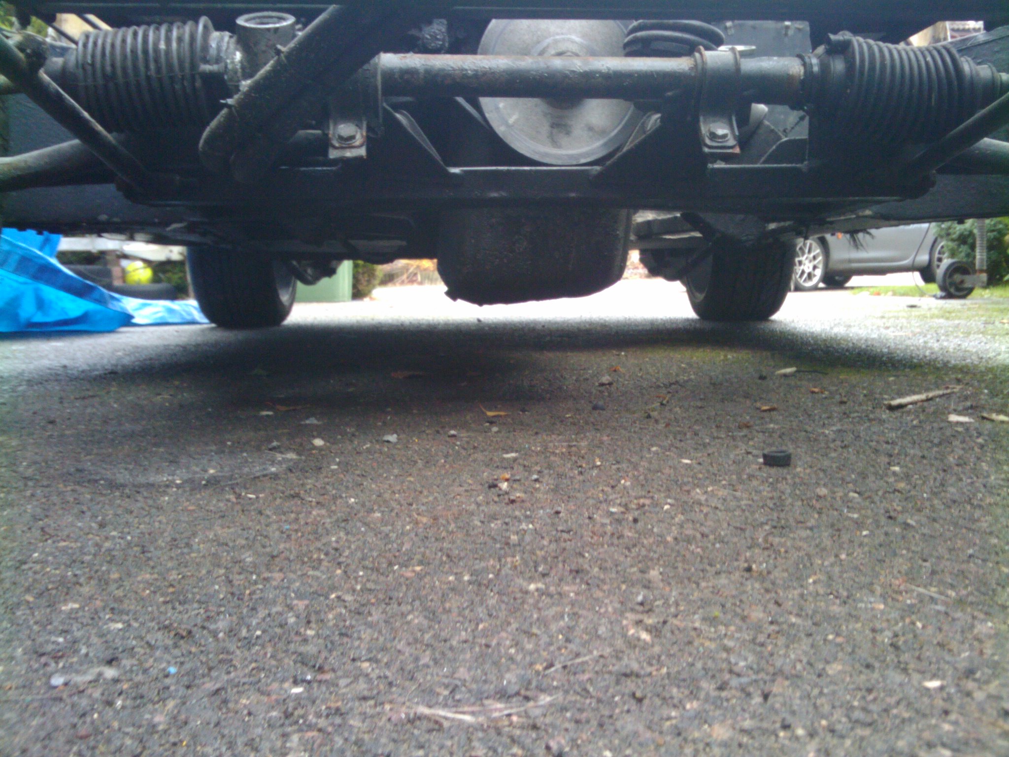

eek: ground clearance below the sump on flat road!
Engine out!
Engine out!

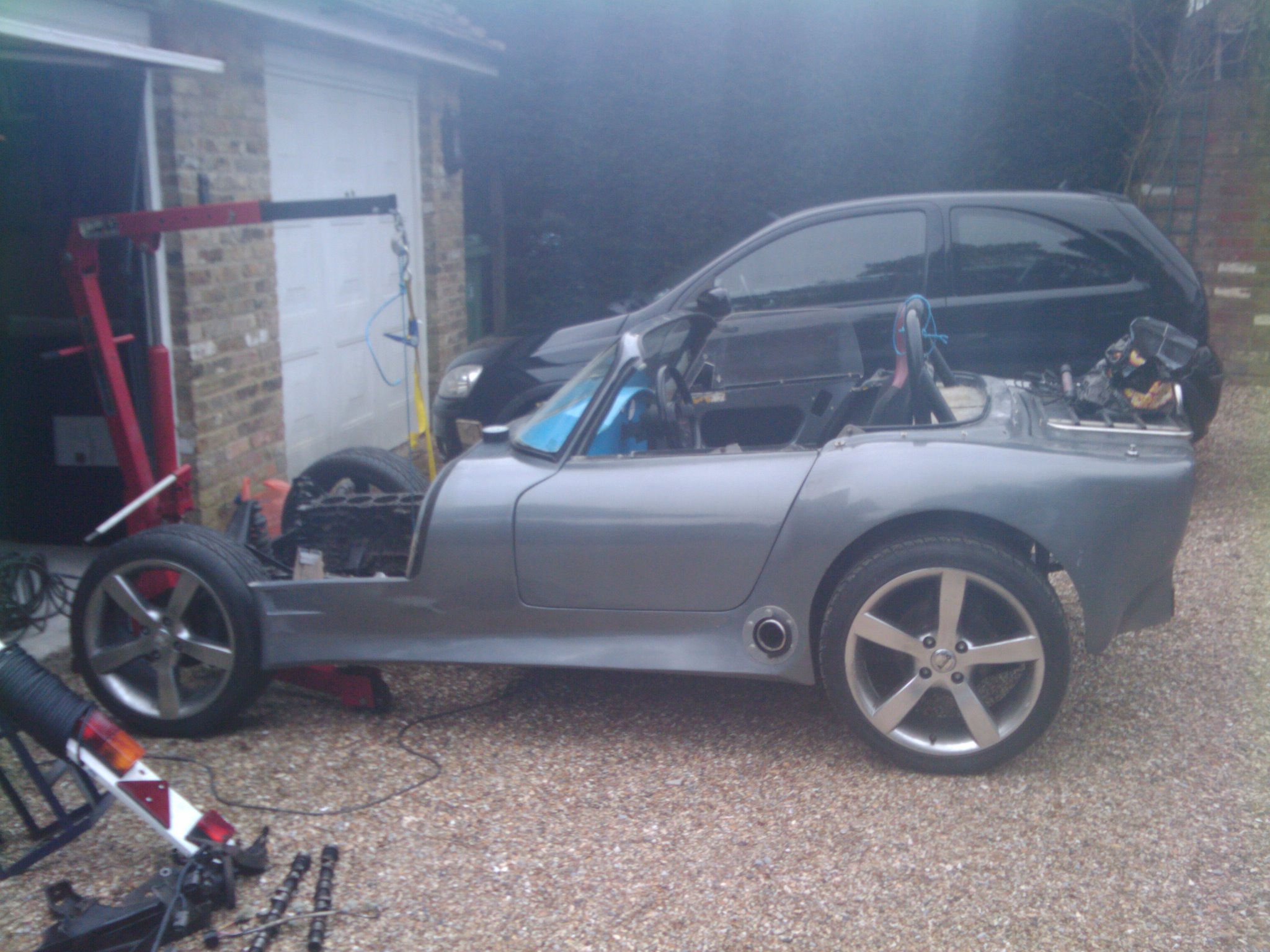

Stylus's new home
Stylus's new home
Wheely :D
Wheely :D

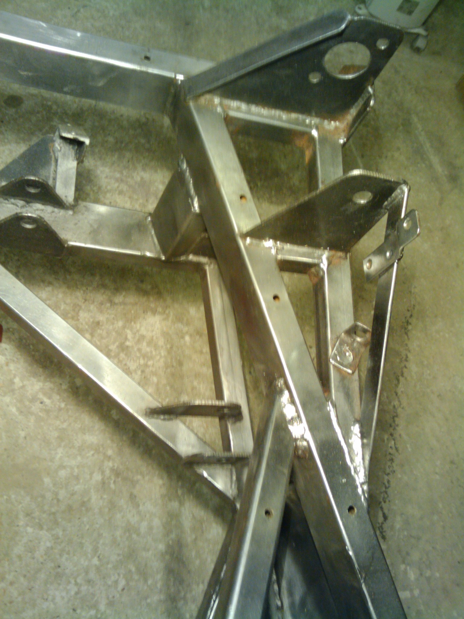

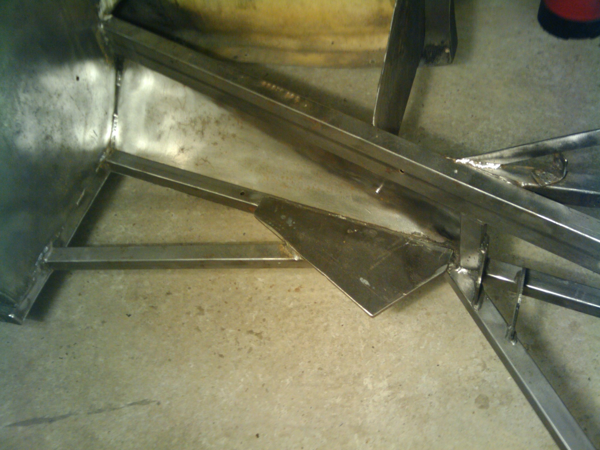

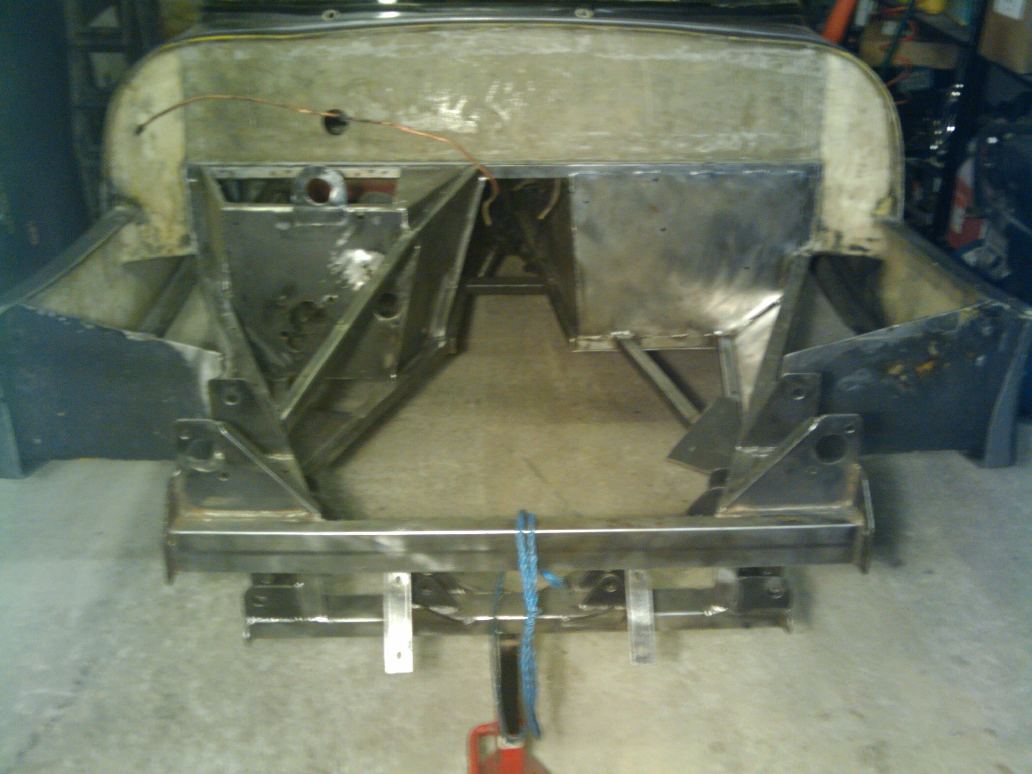

Welders Inc, top bloke who made my engine mounts

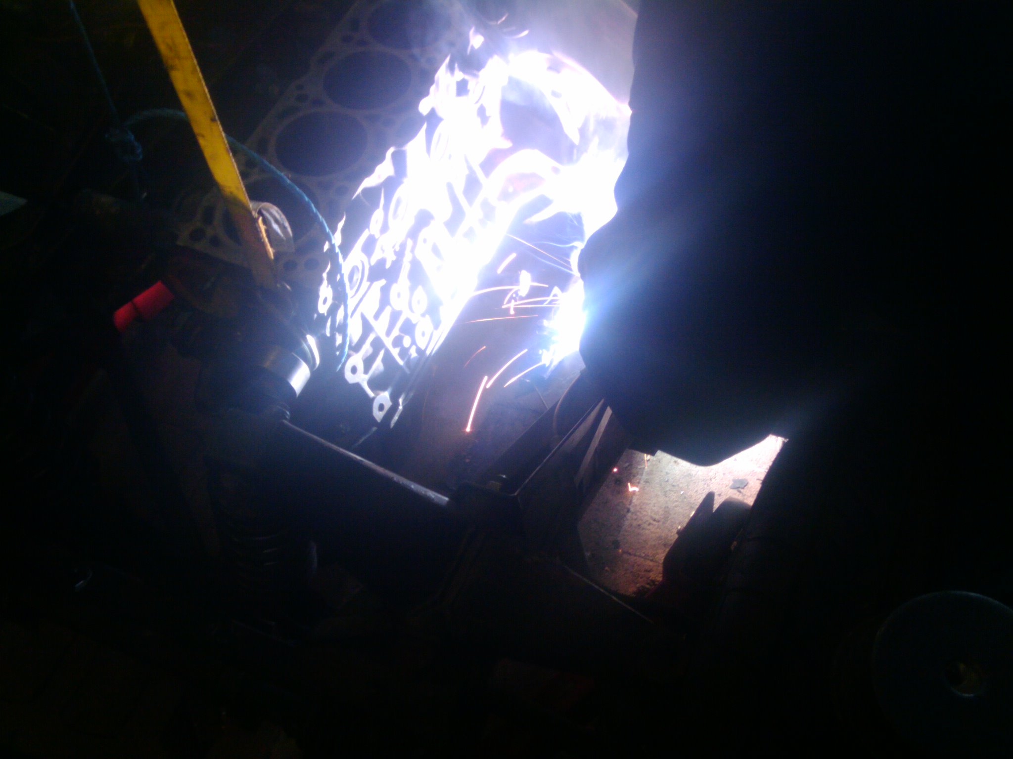

Pic of the new engine mounts being welded in
Heres the finished article! muchhh better than the original mess!

Engine mount #2
Engine mount #2

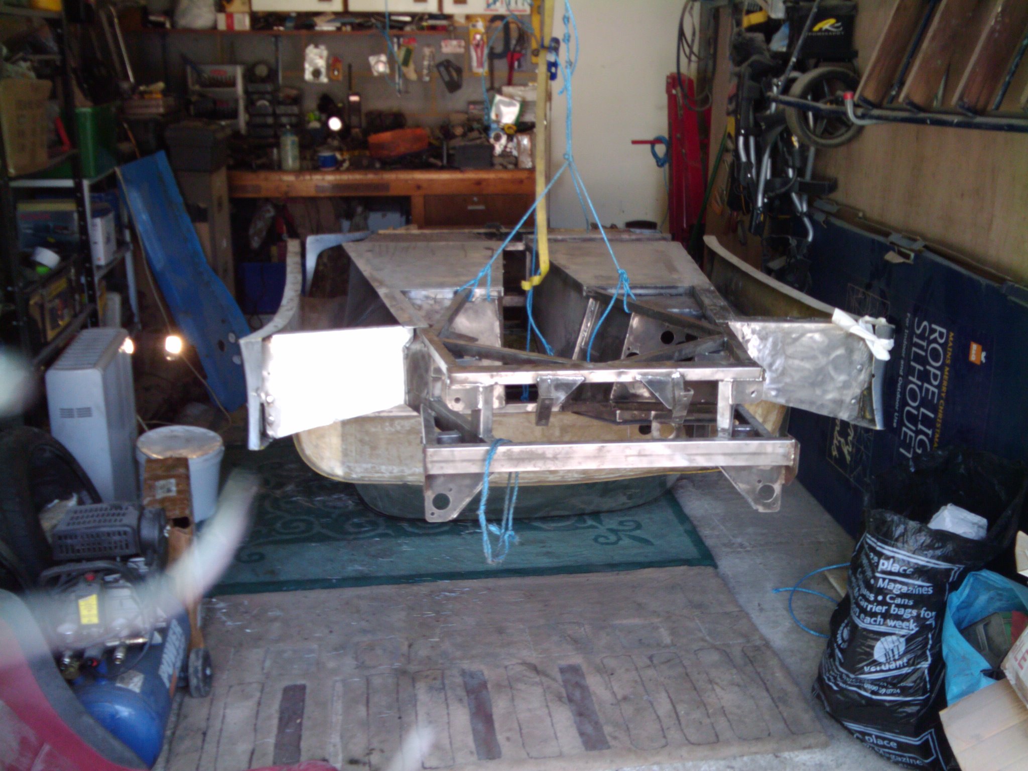

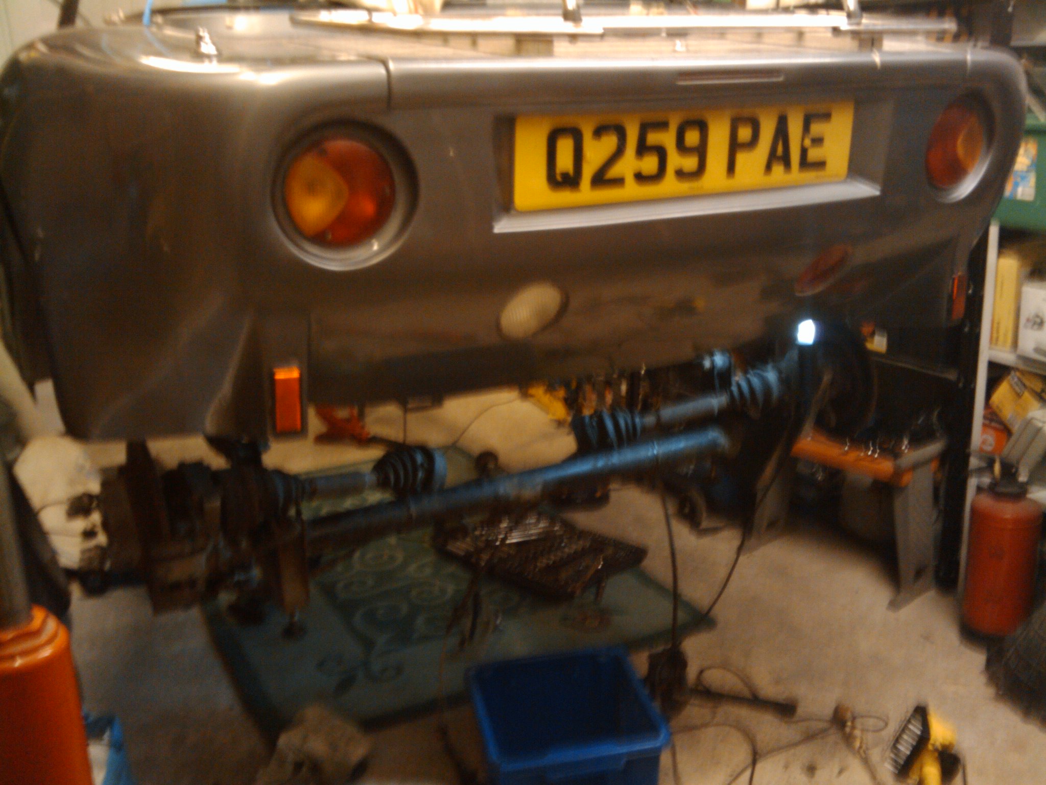

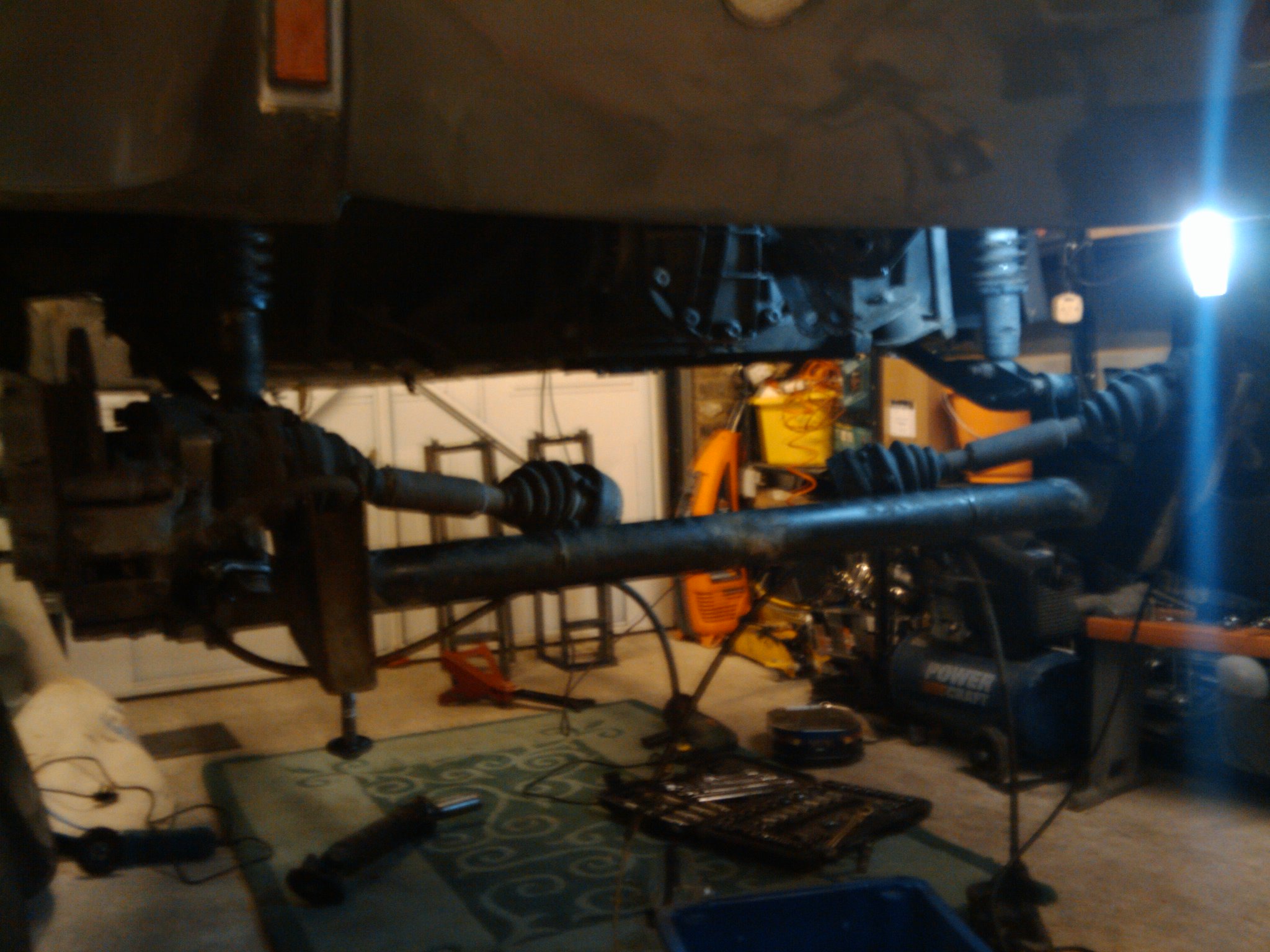

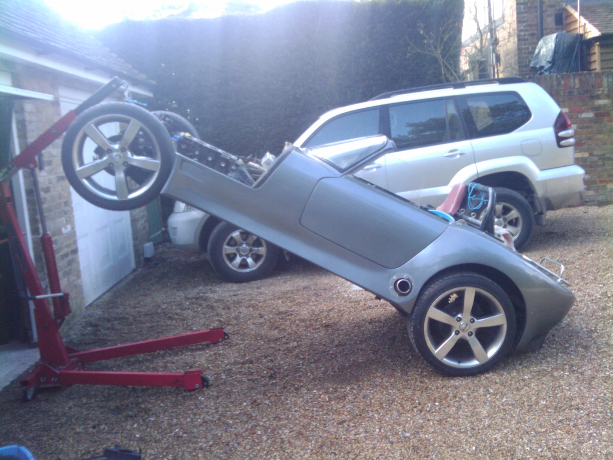

Stylus strapped to the rafters! removing rear suspension
Rear beam coming off
removing the diff mount aswell

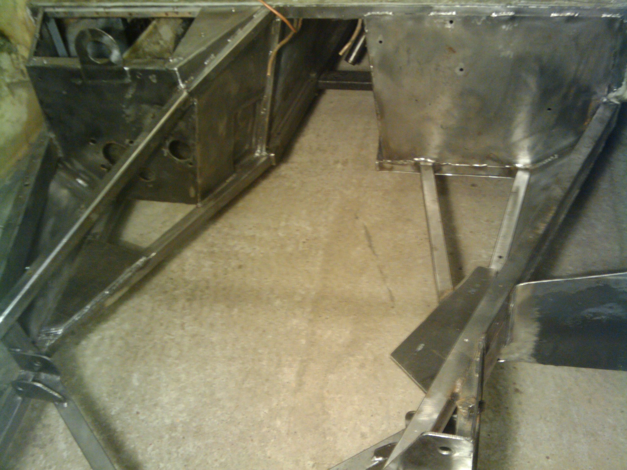

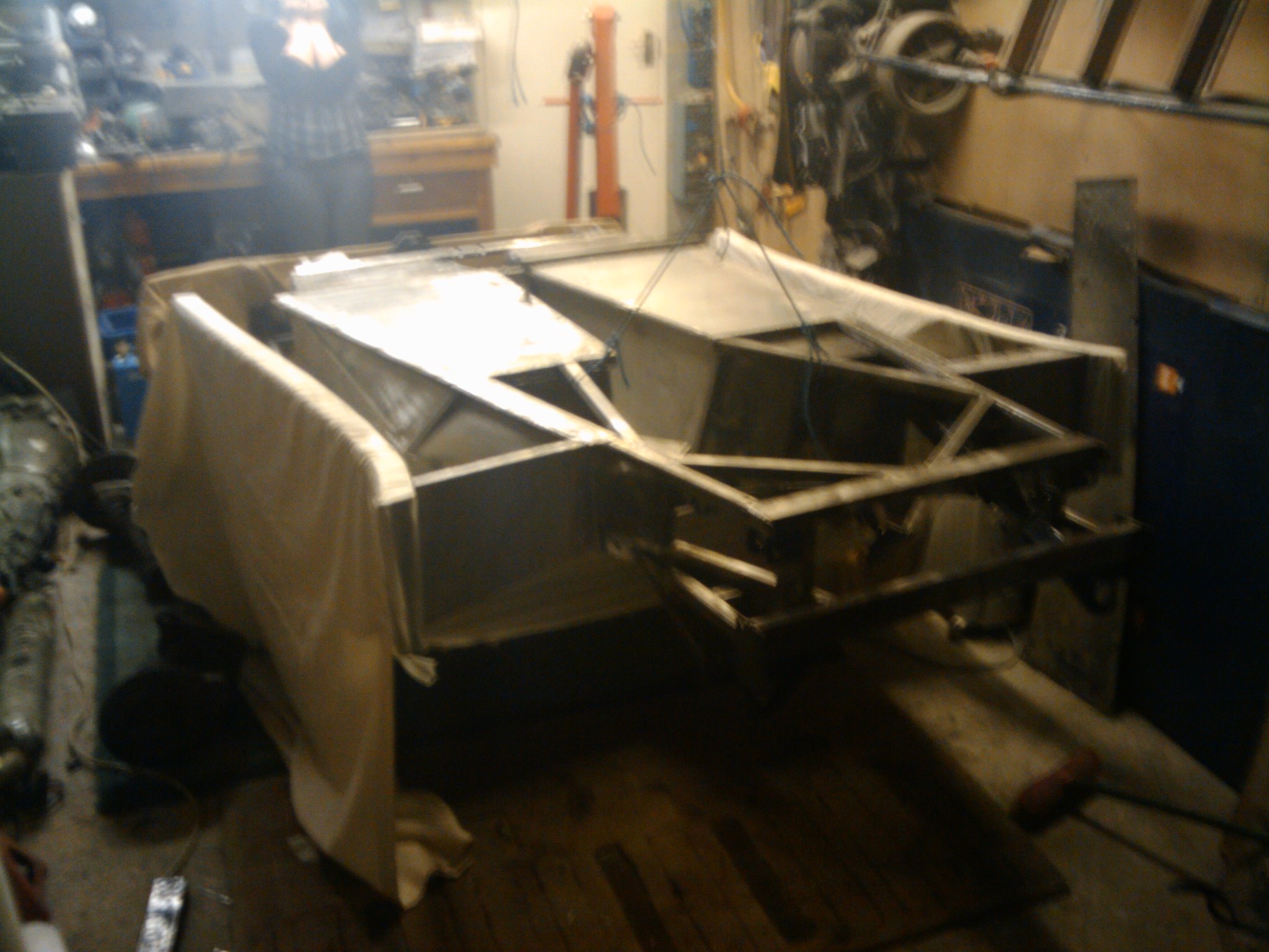

removing the old paint off the chassis!

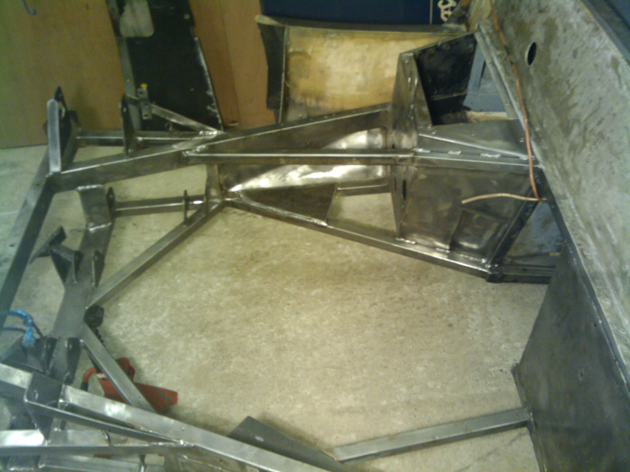

After ALOT of work!
After ALOT of work!
Clean chassis & new engine mounts
Nice & clean!
Nice & clean!
Engine bay all ready for paint!

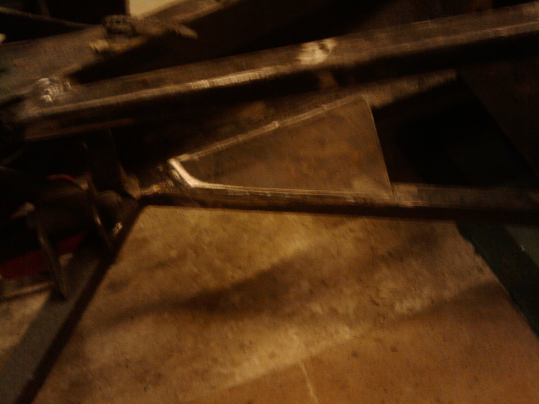

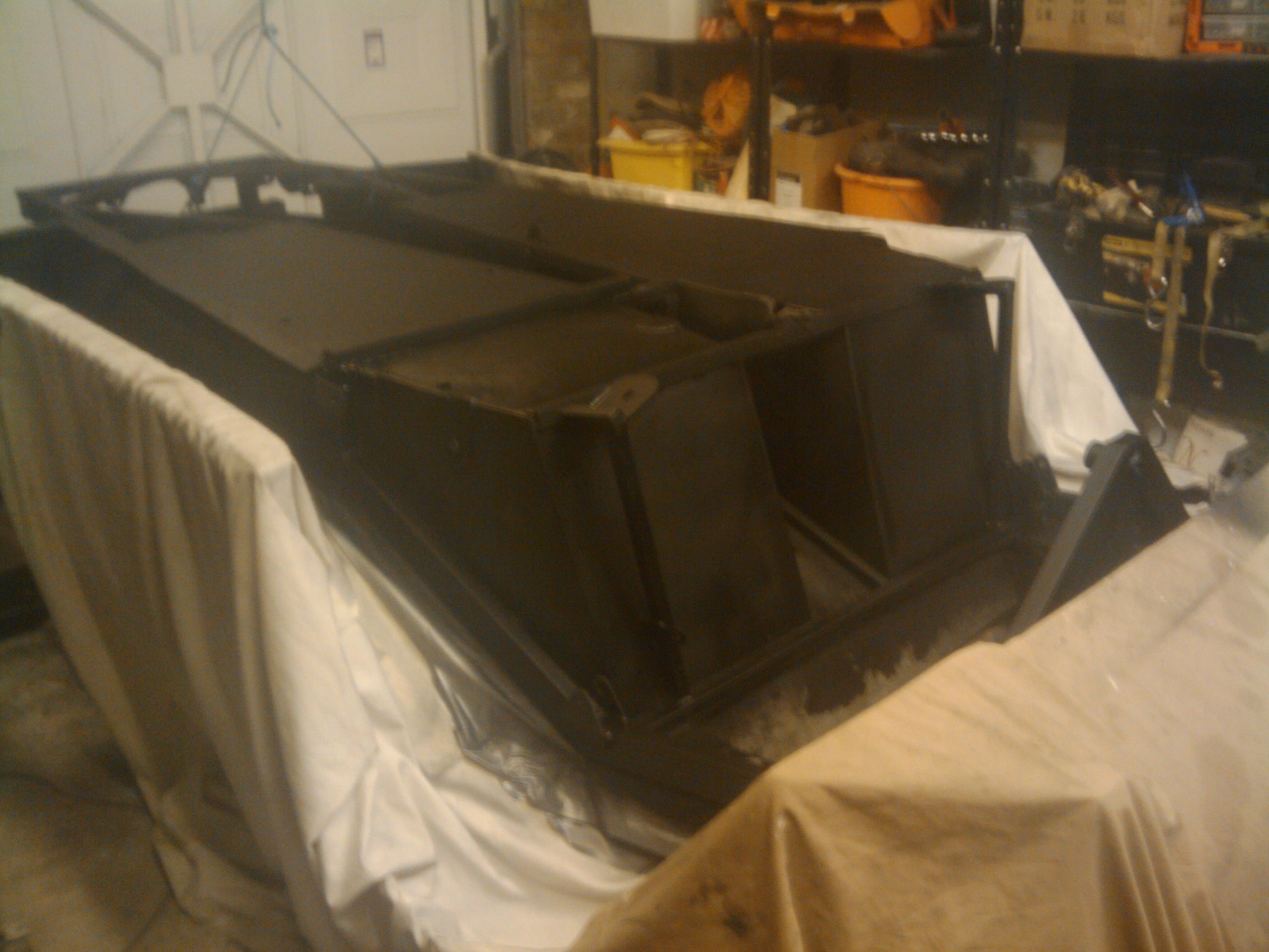

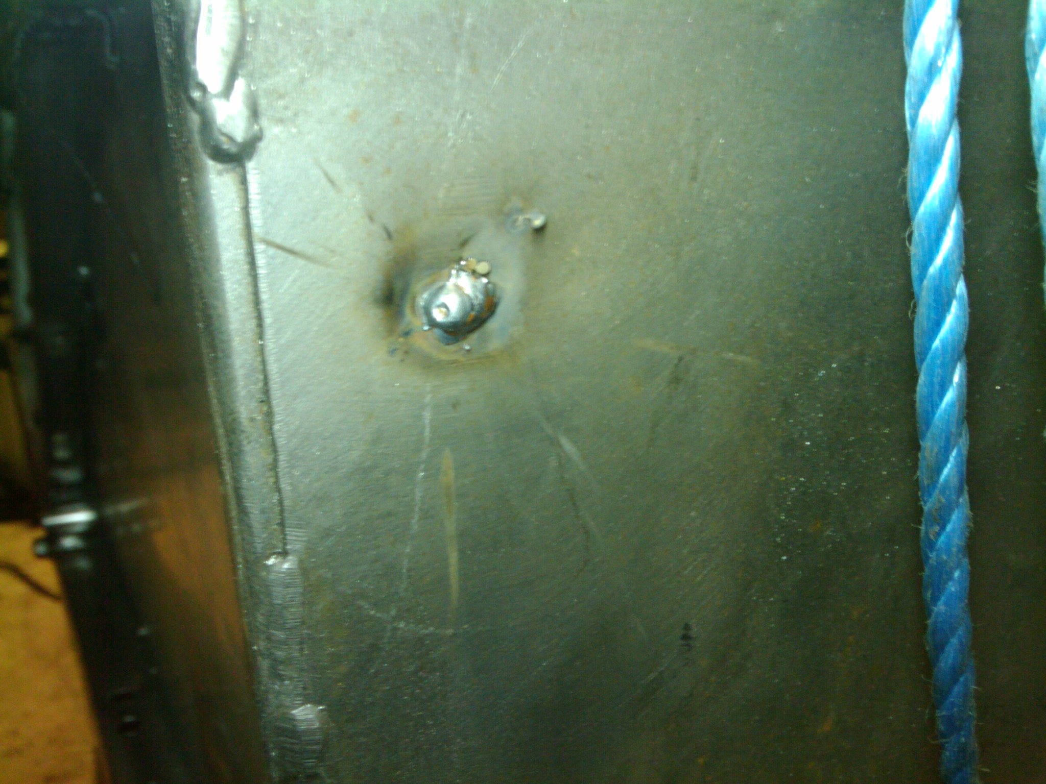

My first bit of welding- welding then smoothing off all the old rivet holes

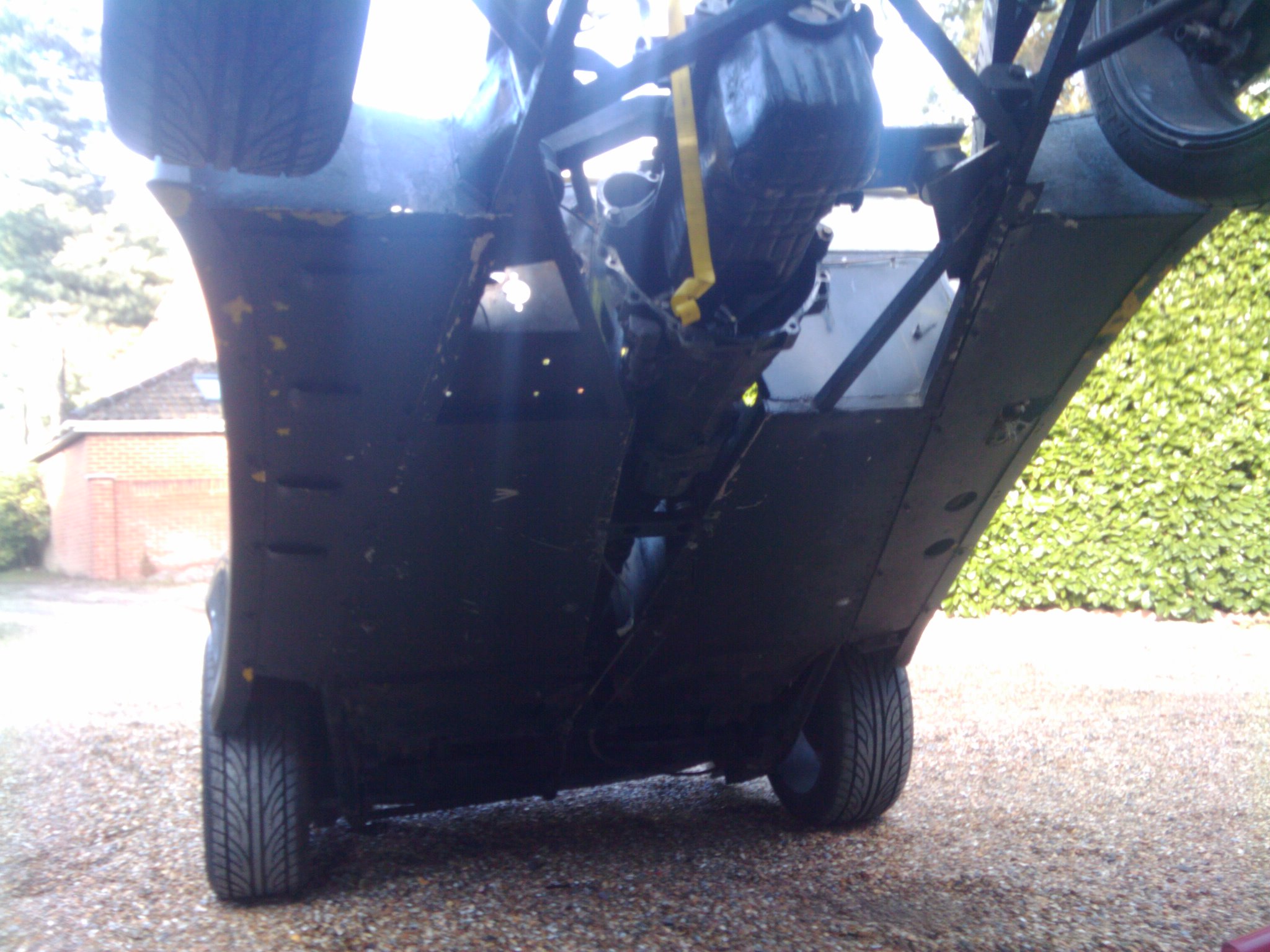

upside down stylus! moreee prep work on the chassis!
Removed all paint from chassis! what a releif that jobs over!!

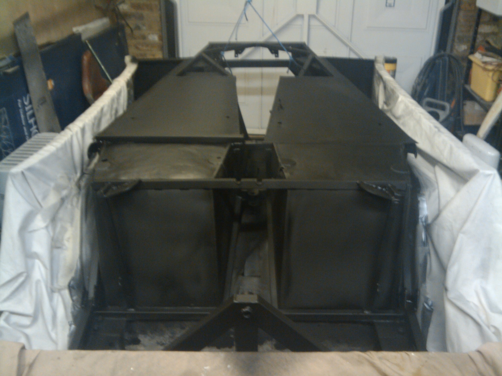

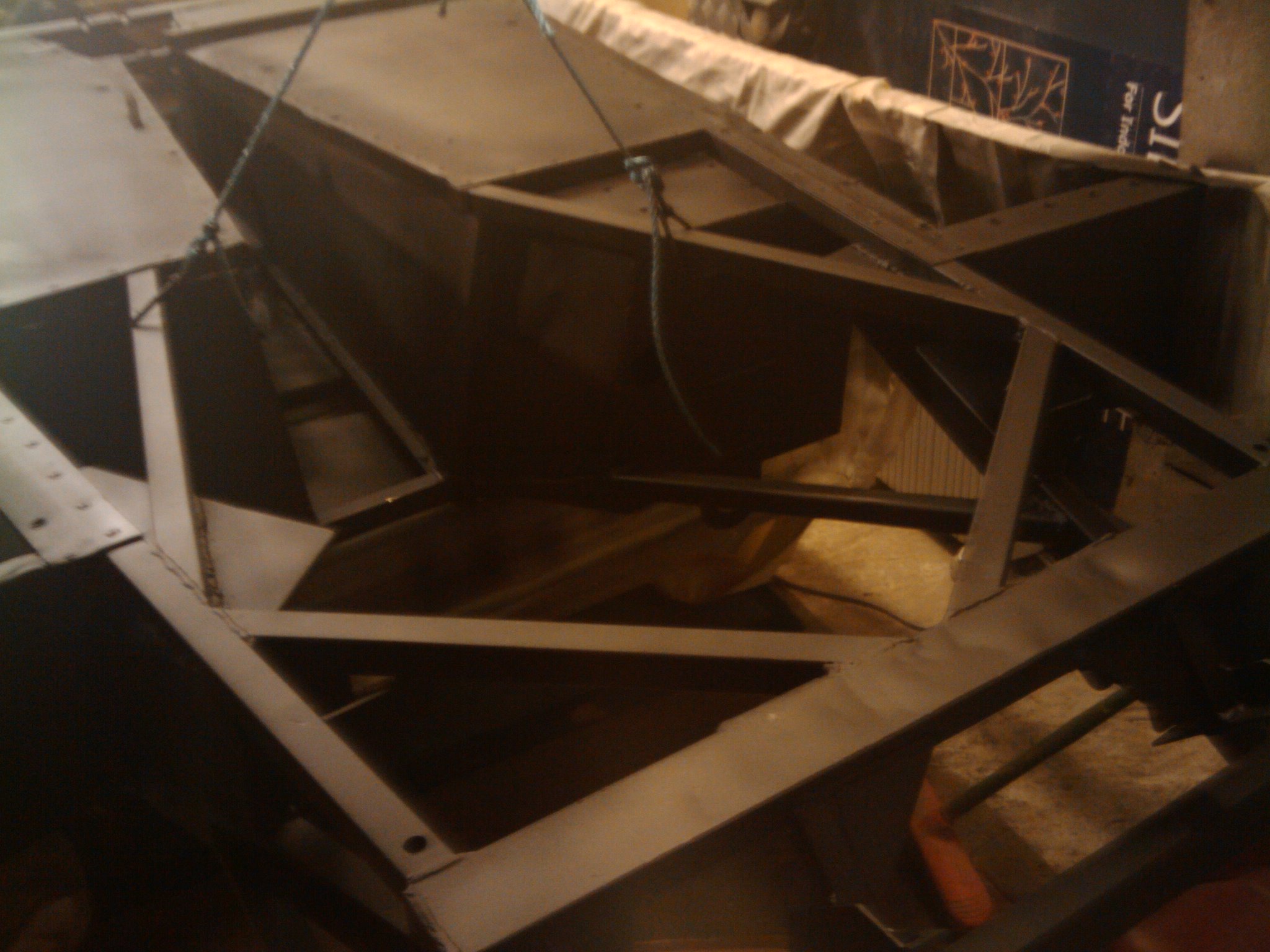

Masked up ready for first coat of corrosion protection paint!
After first coat of paint!
#2
#2
Rear end, As you can see I cut the cross member which goes across the back to give me more boot space & triangulated the legs to put all the strength back in :D Once I tacked them into place Peter from 'Welders Inc' poped over & welded them in properly to so there nice & strong :D

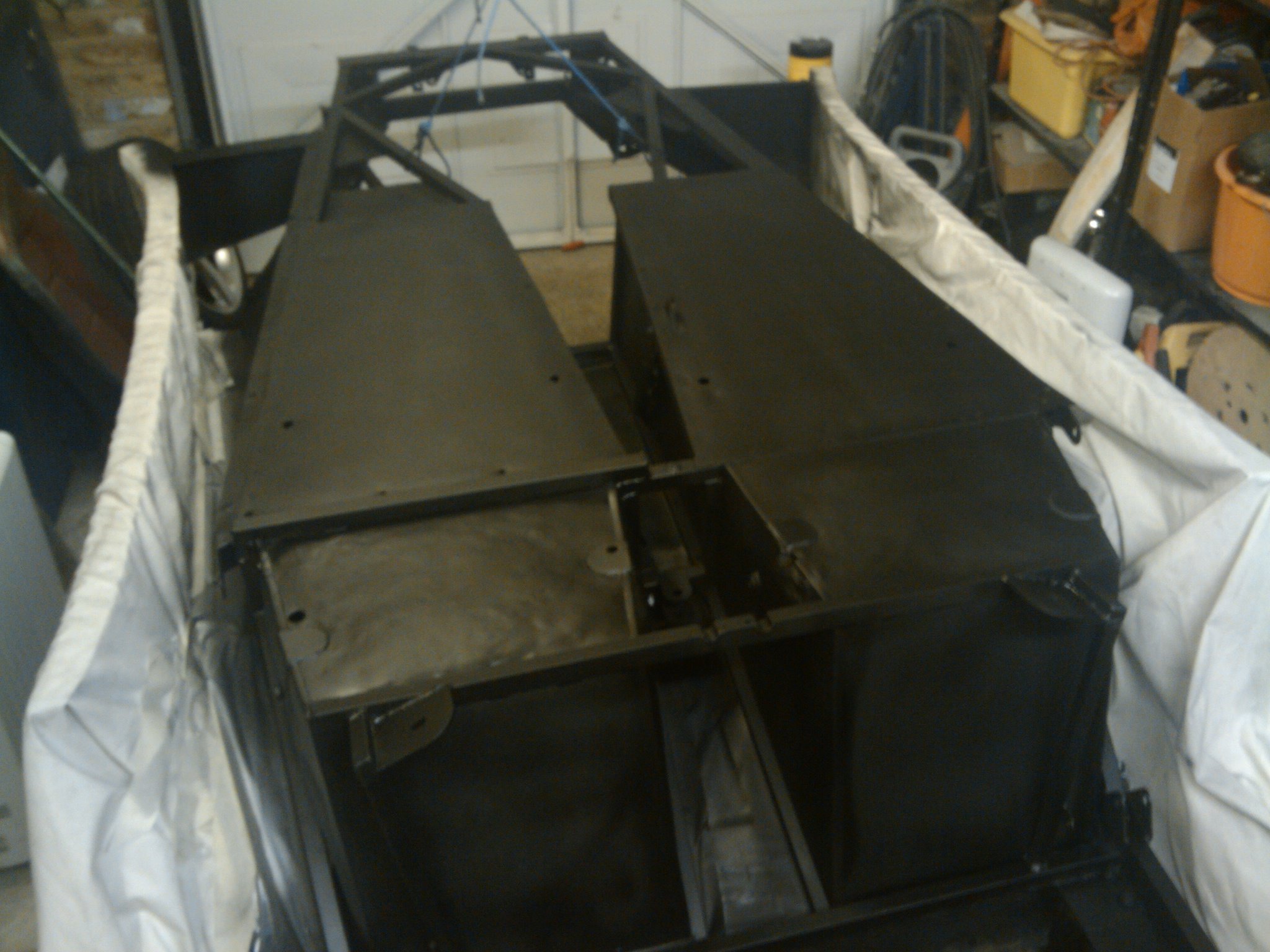

Painted chassis again
Front end gets its base coat too

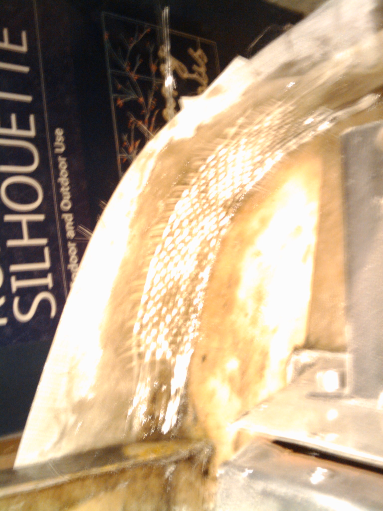

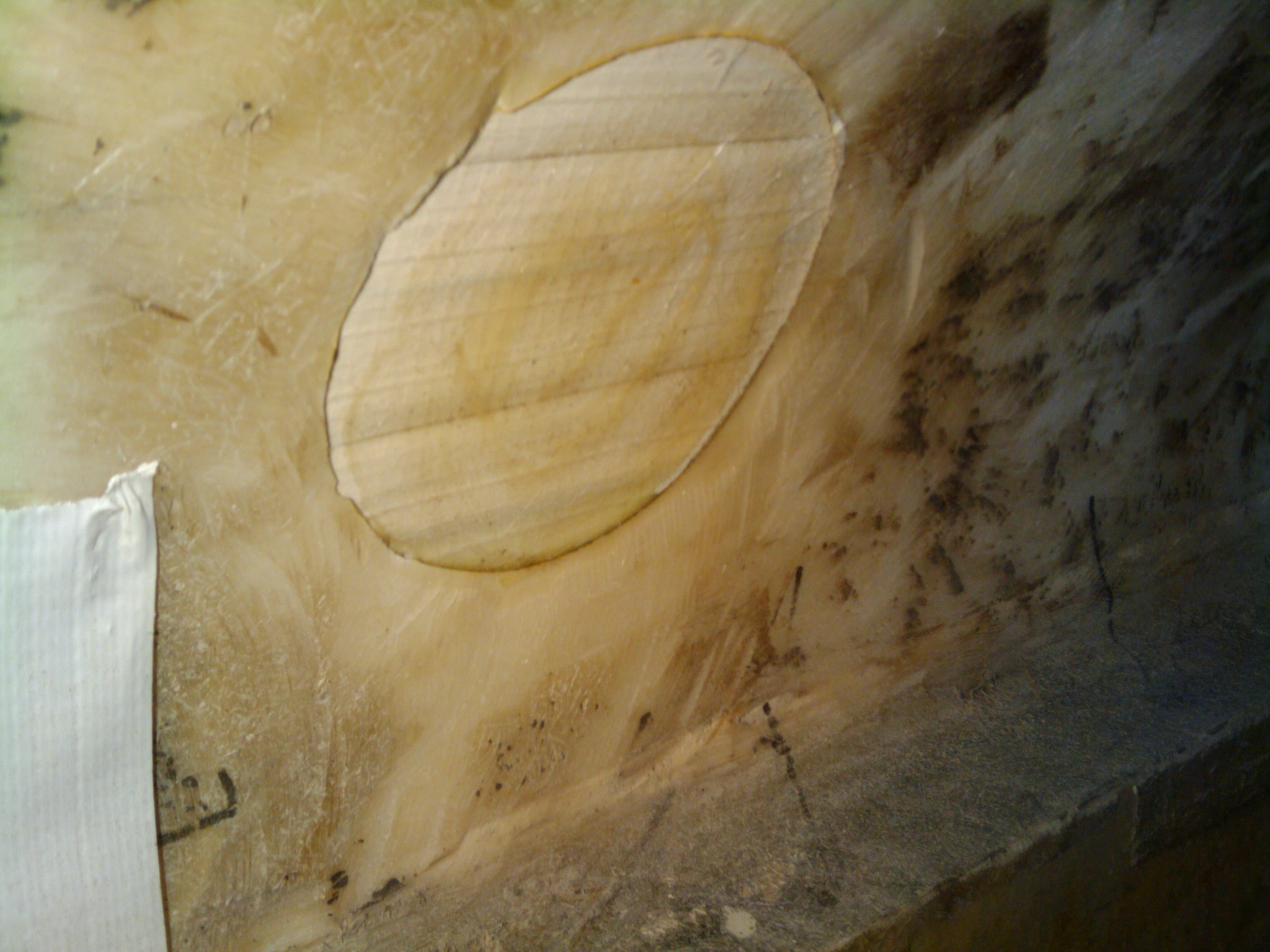

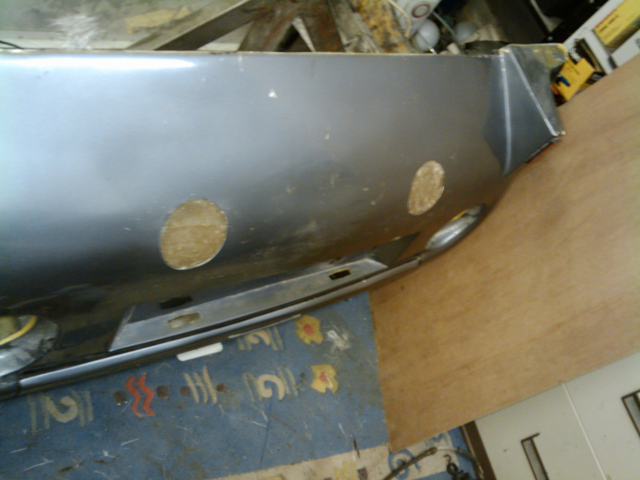

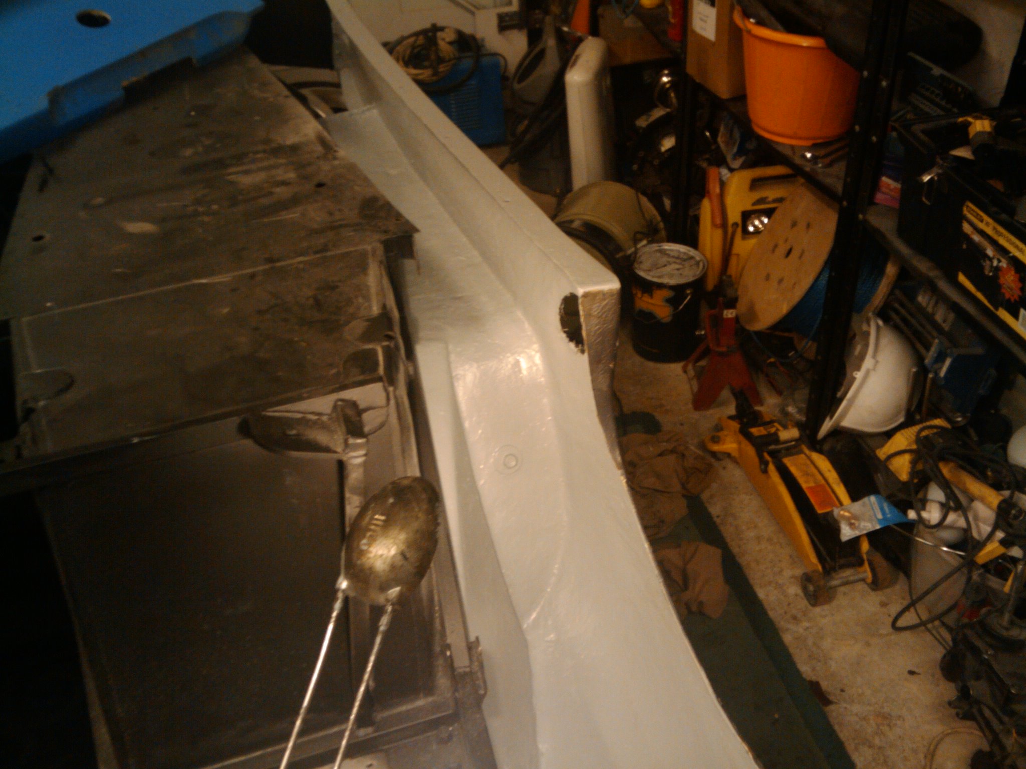

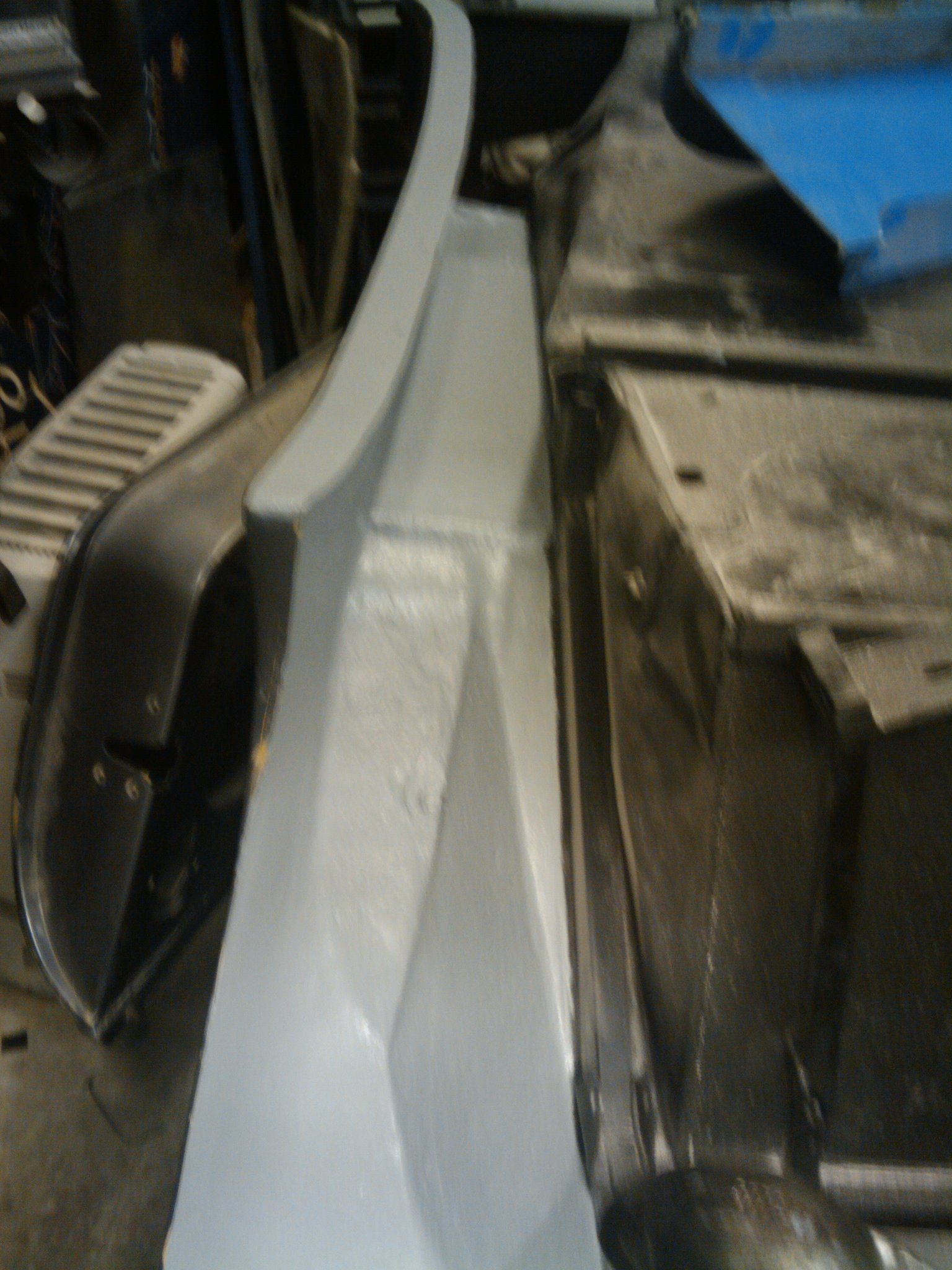

Decided to remove the reverse & fog lights from the rear, Started by 'thinning' around the holes which were to be filled untill they were around a mil thick then taped over them from the outside
Nice & thin so i dont get a crack where they have been filled, smeered a touch of grease on the tape to stop it sticking to the fibreglas

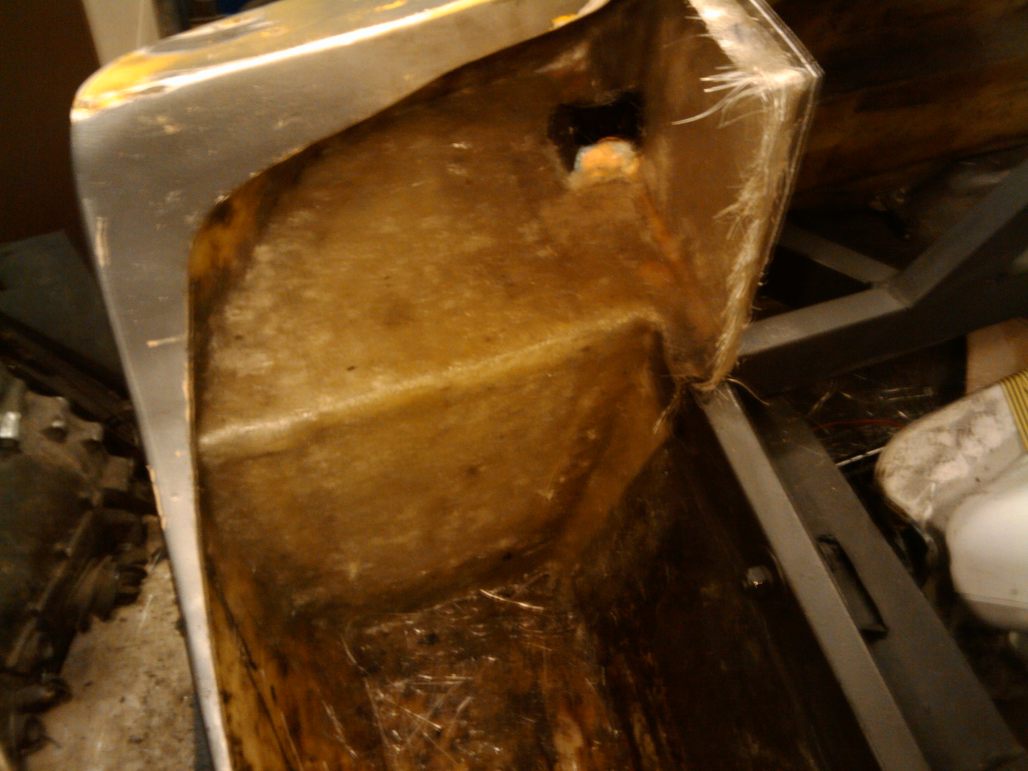

After a few layers of fibreglass
Another shot
Another shot
Remove tape & this is the finished article- simple but very strong, ready for a skim of filler :-)

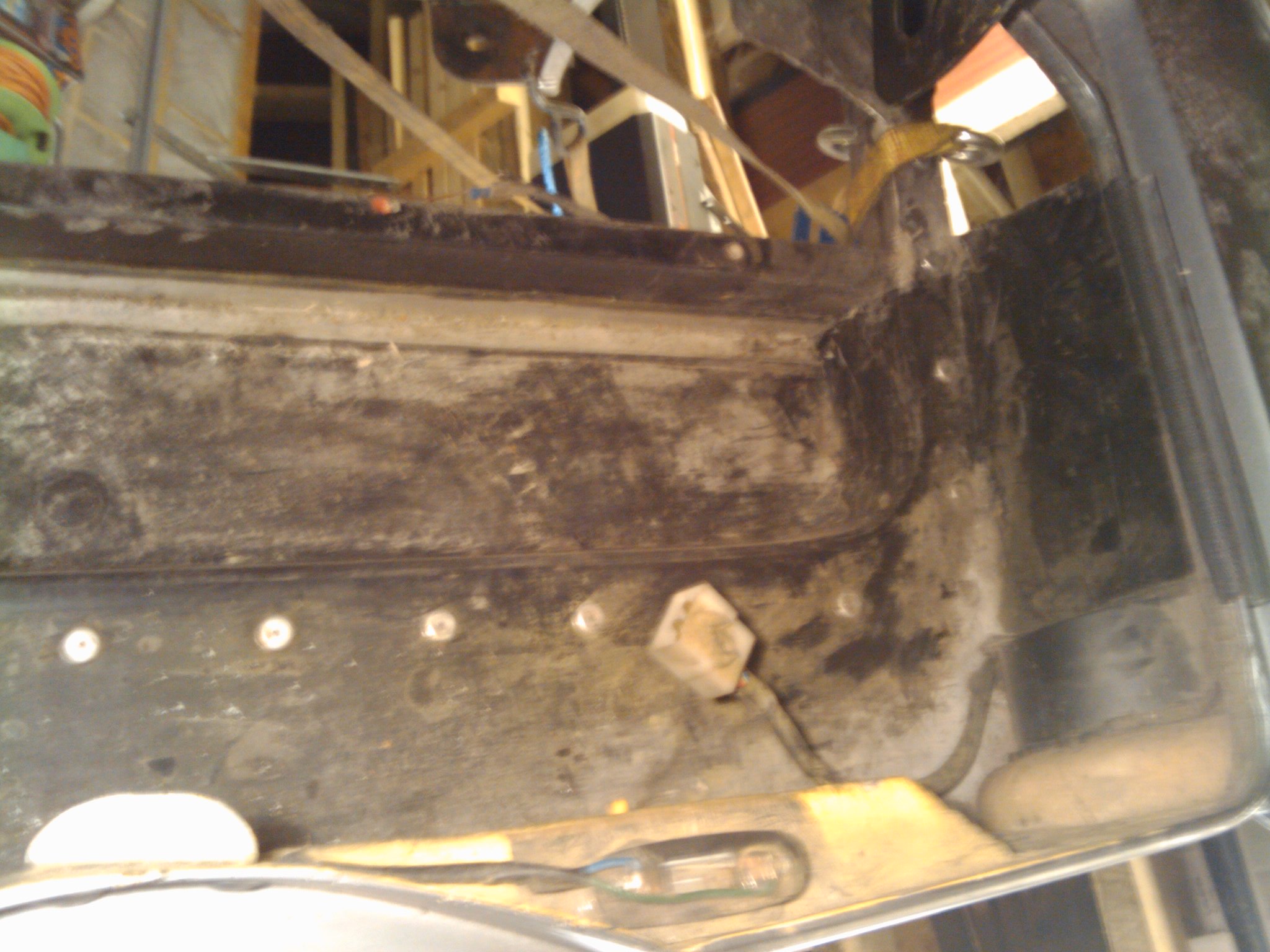

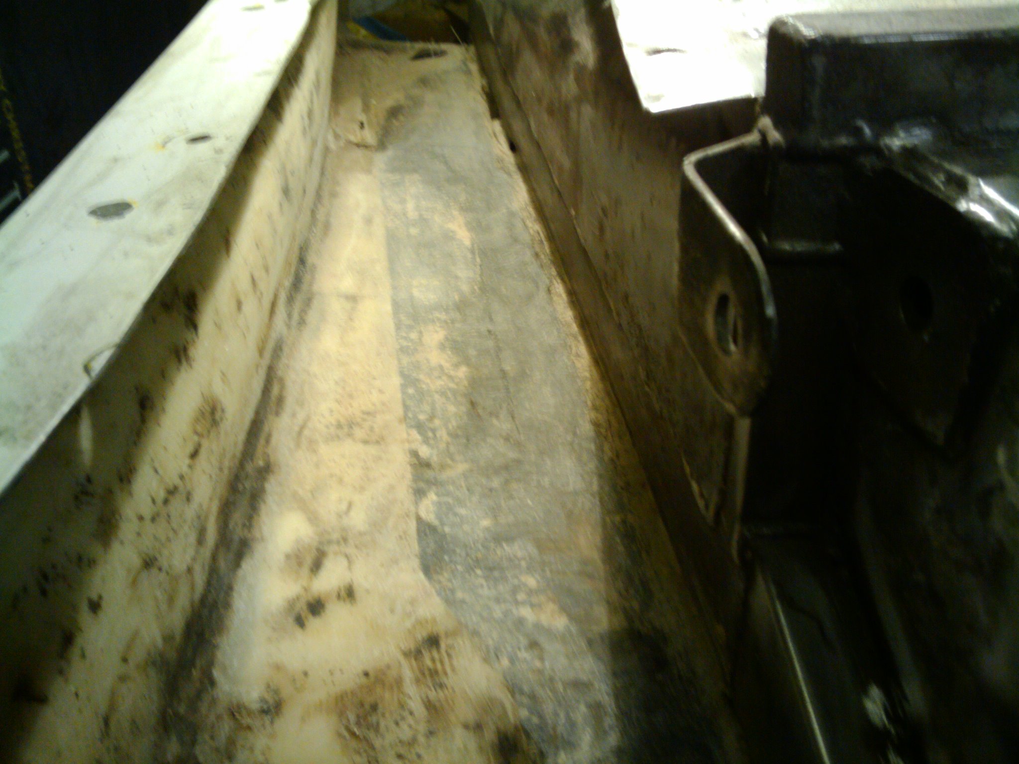

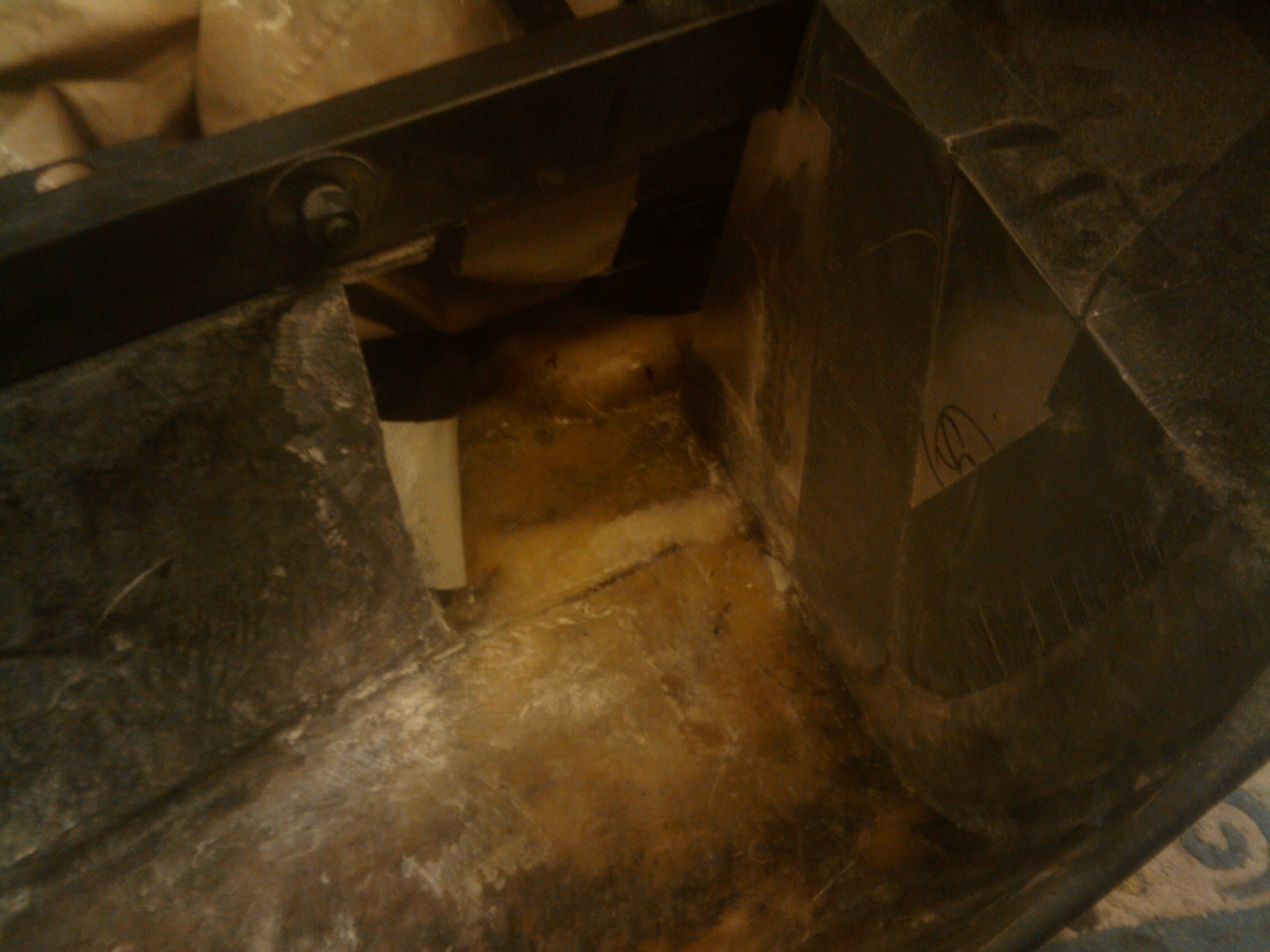

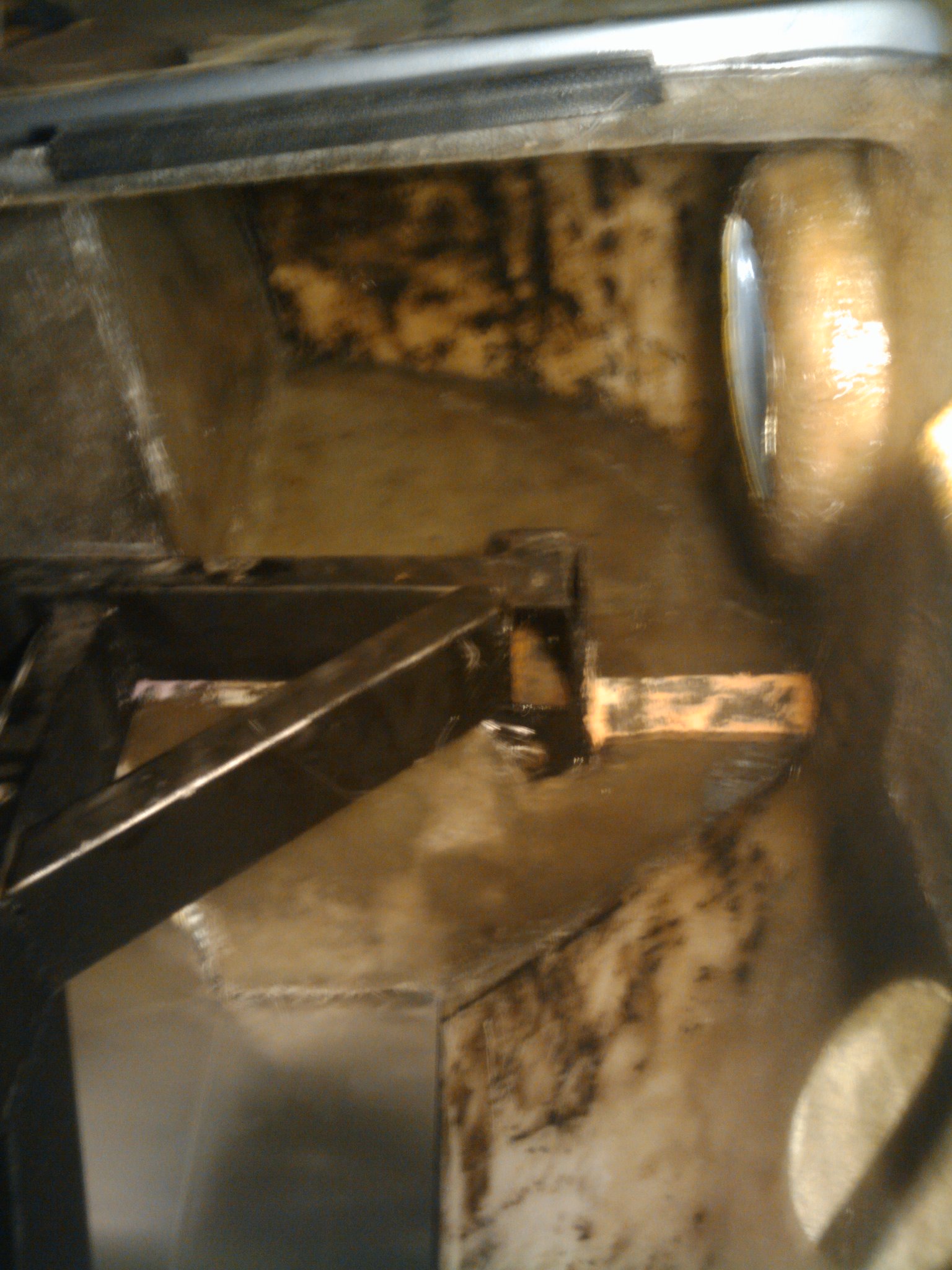

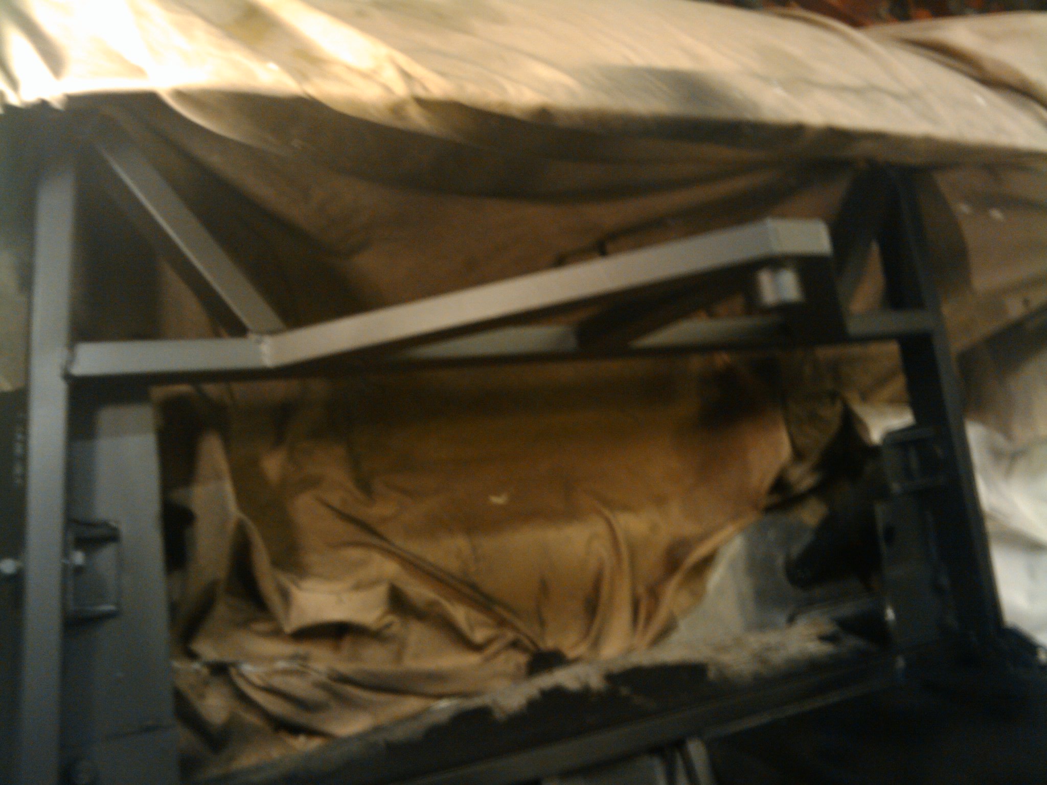

Next on the agenda was to make use of this wasted space inside the drivers cill
Surface keyed up awaiting fibreglass

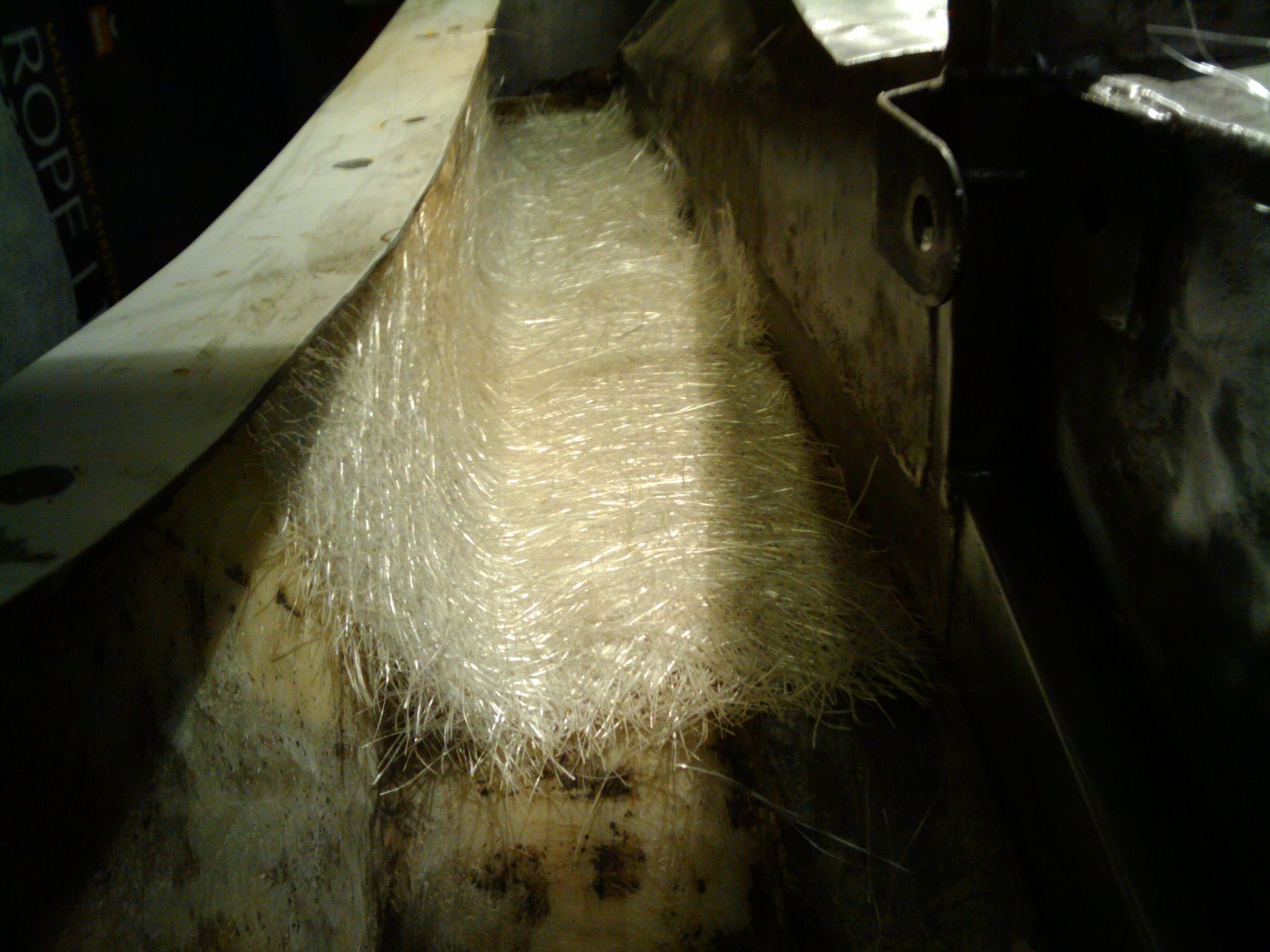

Getting the matting ready
Then cut a peice of 10mm ply to size & bonded it to the cill then glassed over it aswell to seal it. This gives me something nice & strong to screw into for the hatch door :-)

Just used ratchett straps hooked to the rafters :)

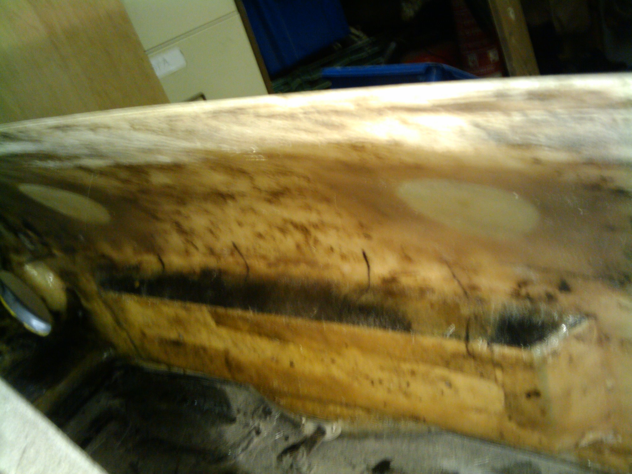

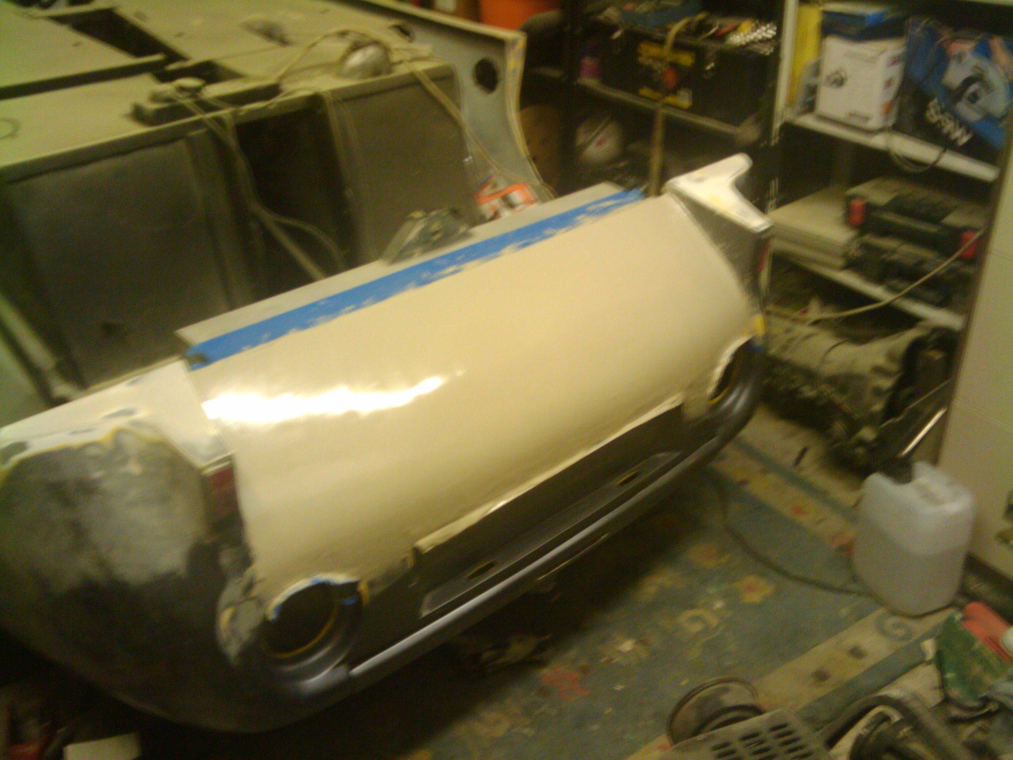

1. A thin skim of filler over the under side of the back

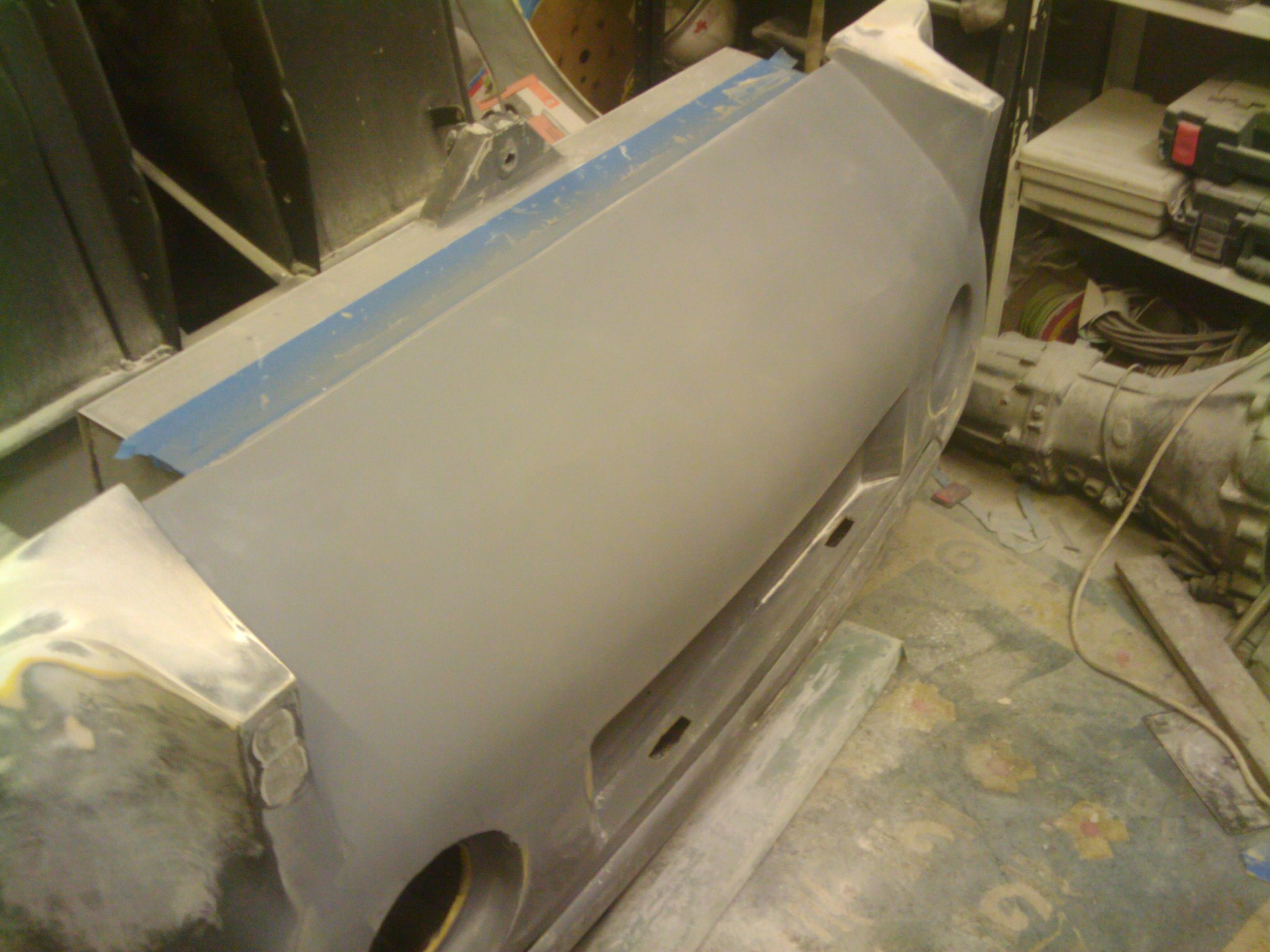

2. Sanded it all smooth than gave it a quick  coat of primer
3. Using playdoh I extended the lip which the dashboard sits over
4. The playdoh works great as a tempory former!

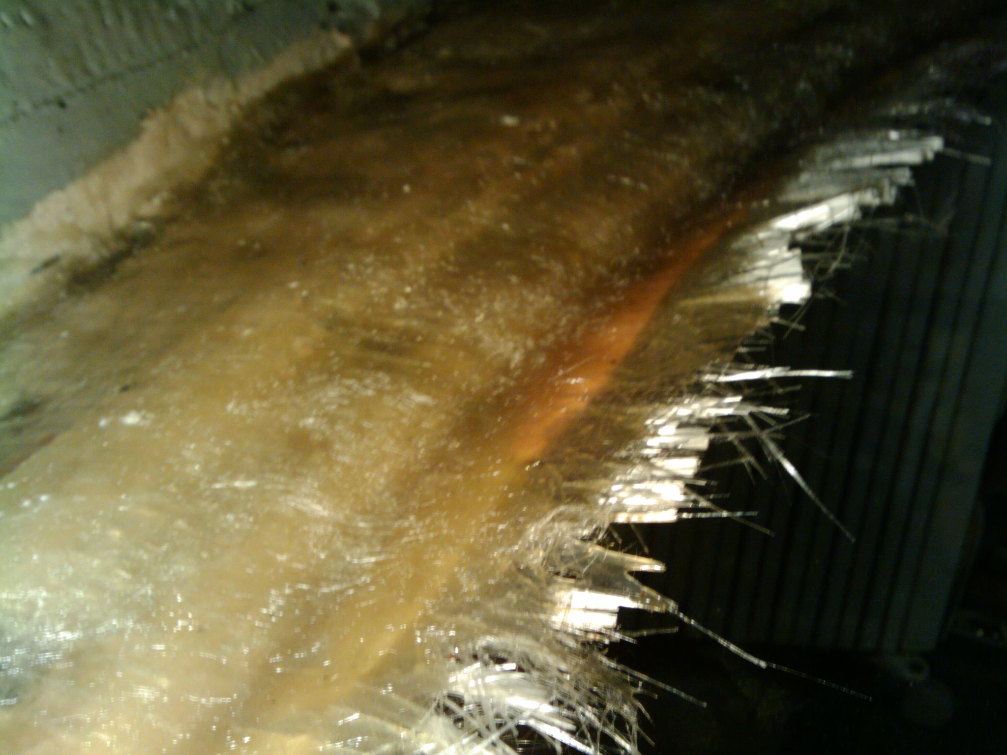

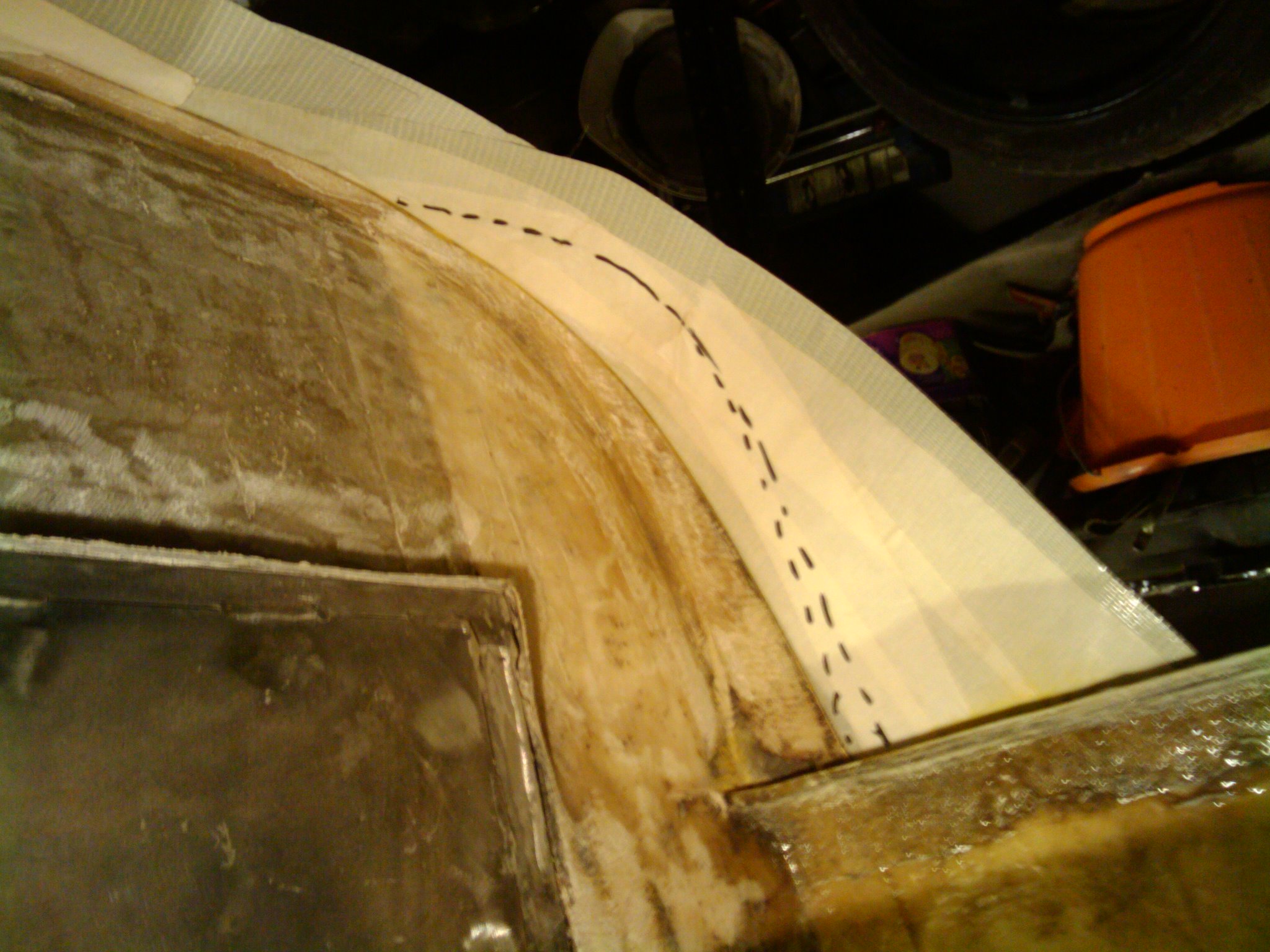

5. Using tape I made a surface which I could fibreglass over to extend the bonnet lip to stop the edge of the bonnet catching on the side
6. After a couple of layers of fibreglass rovings

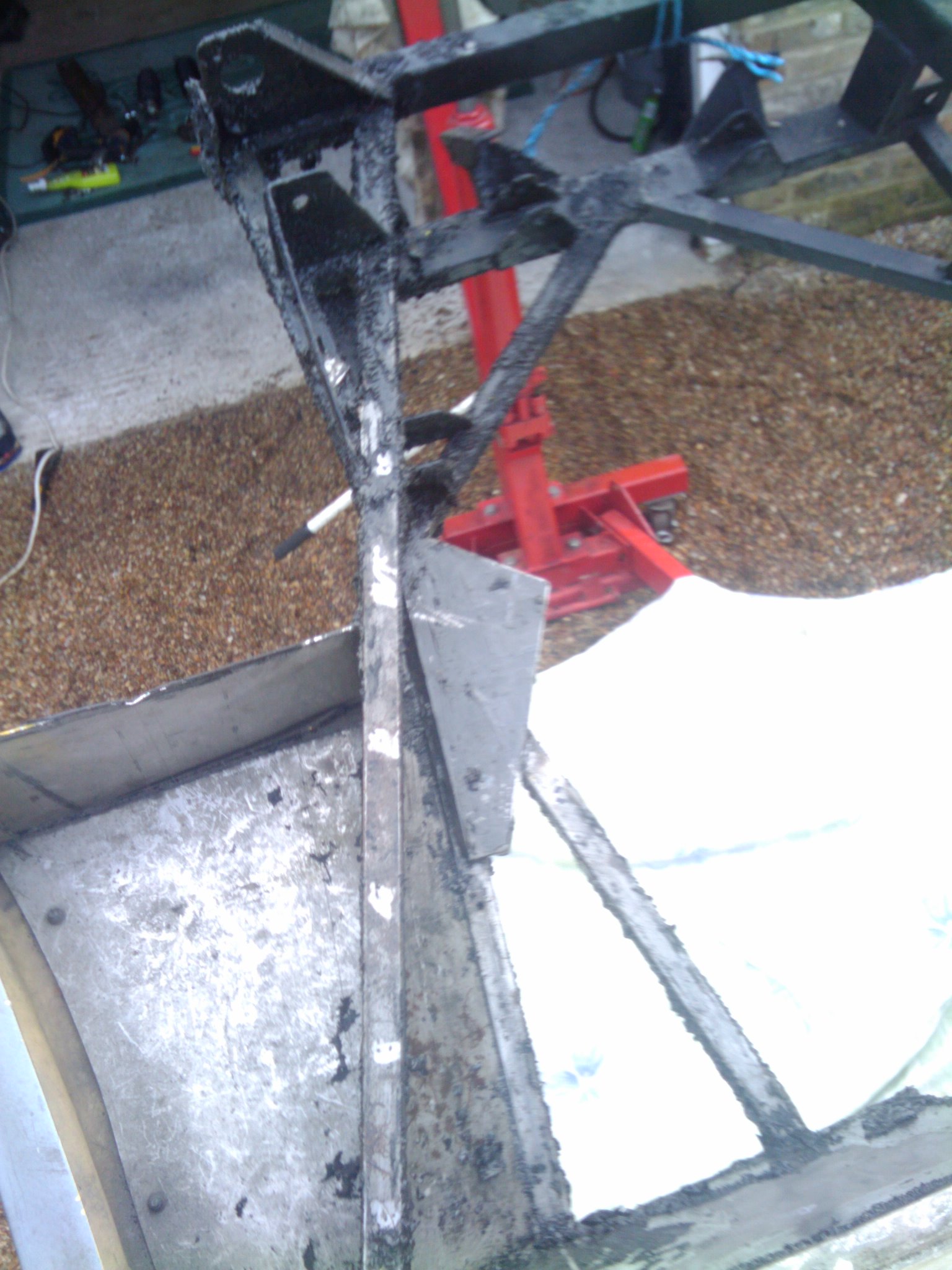

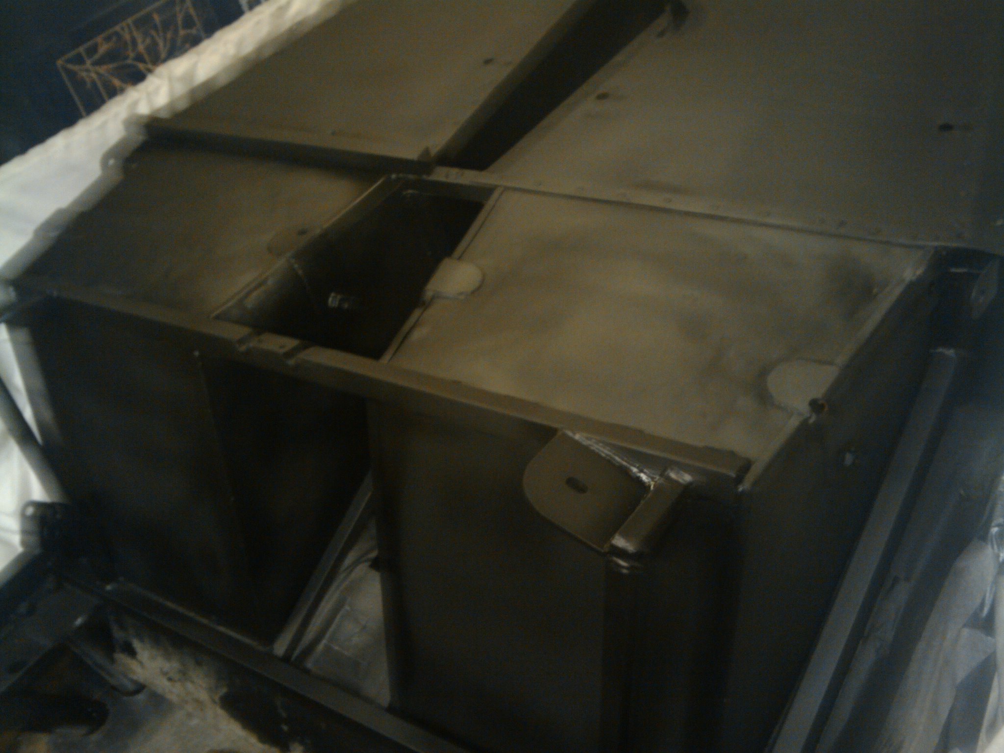

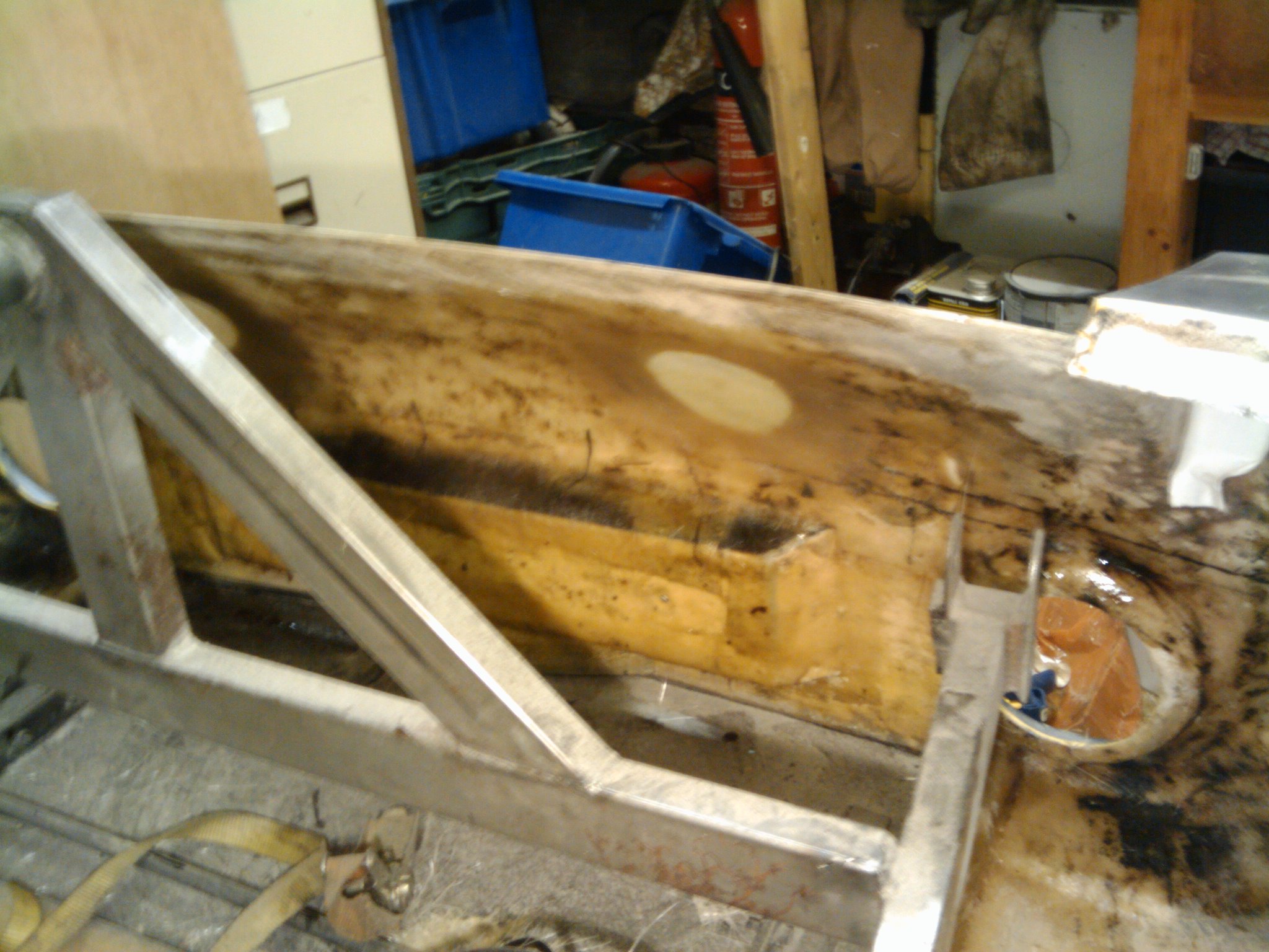

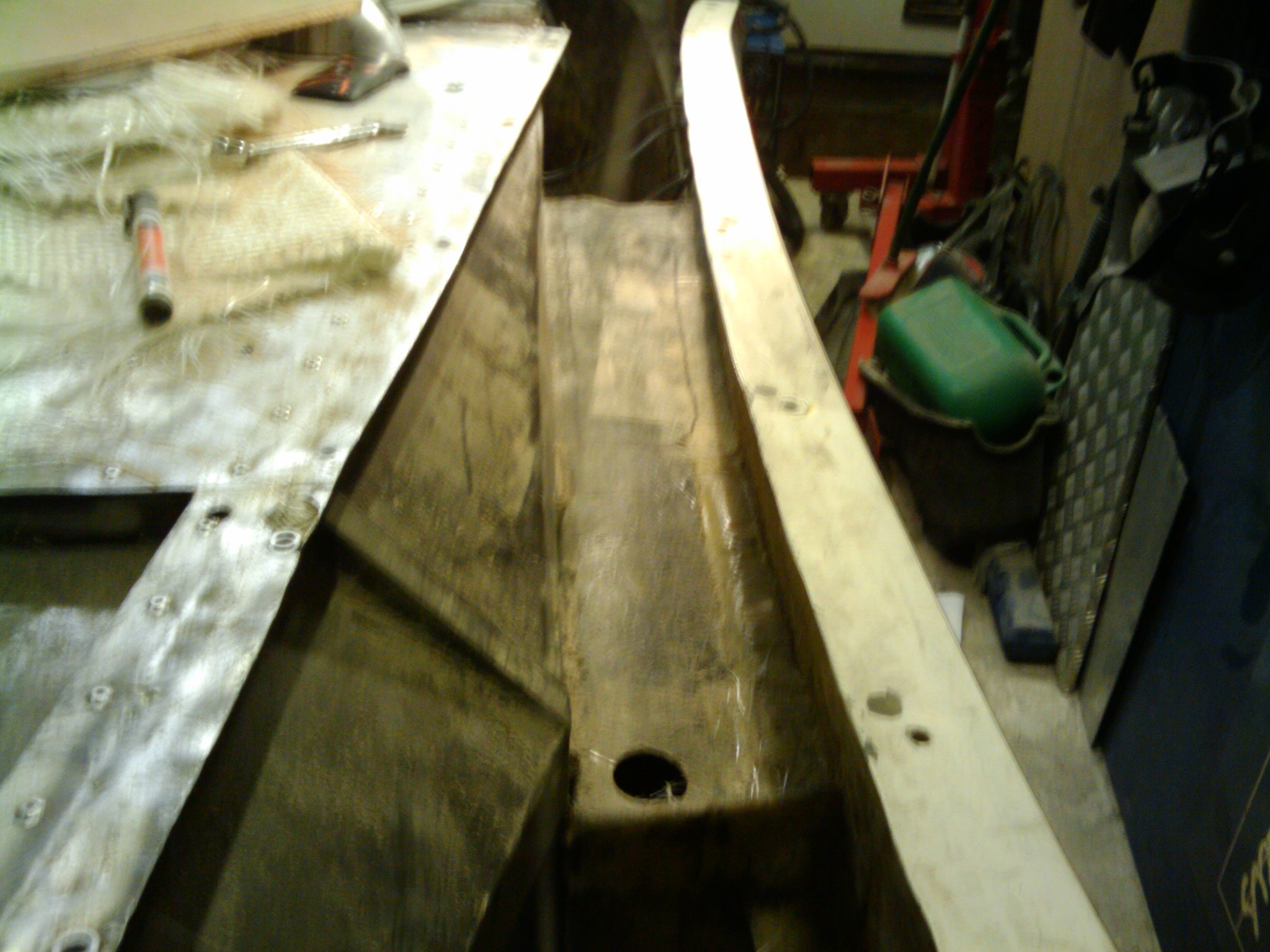

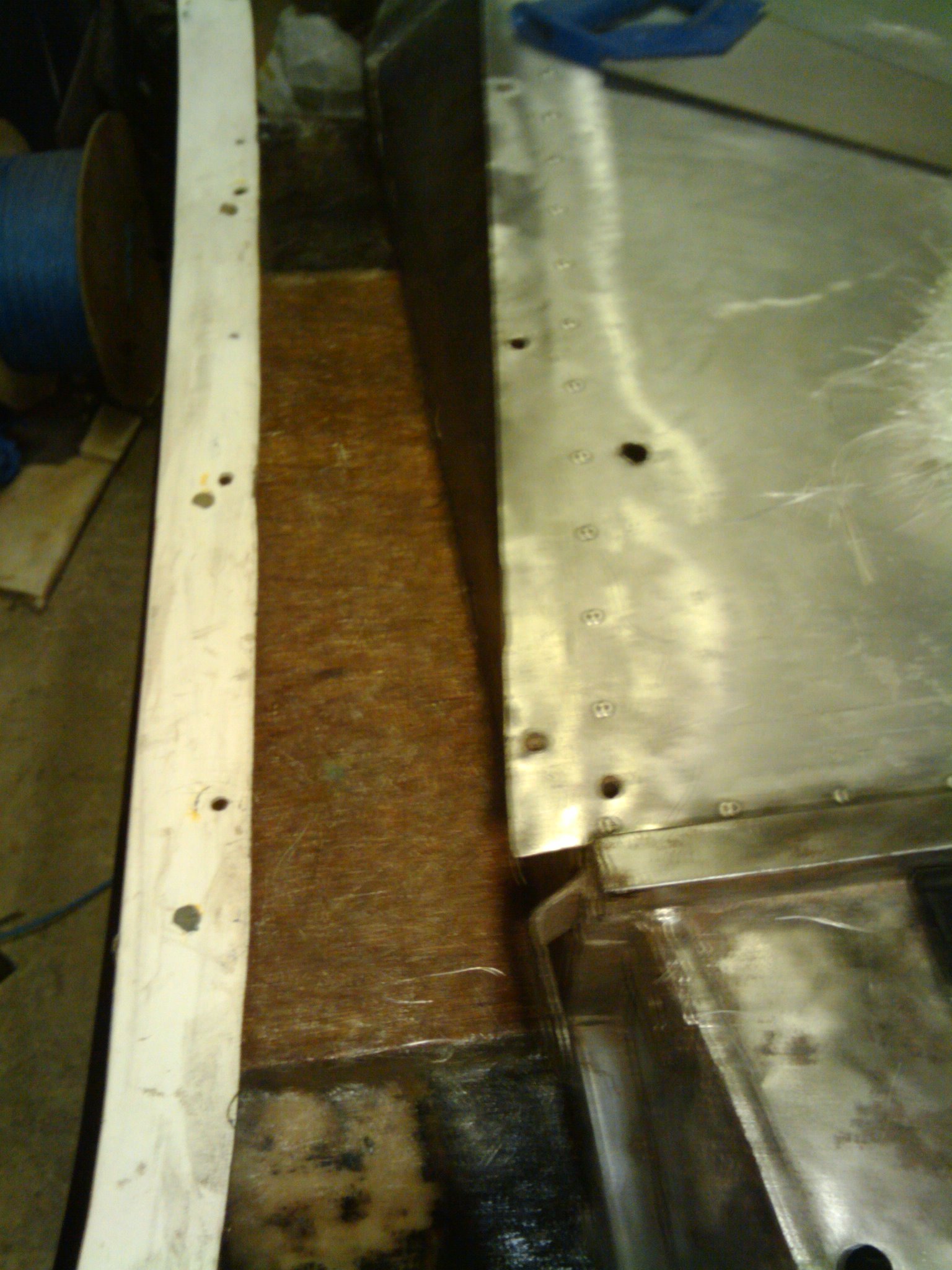

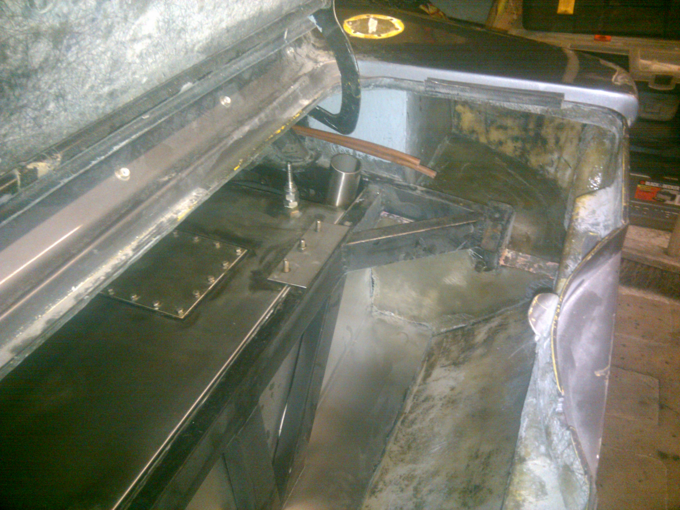

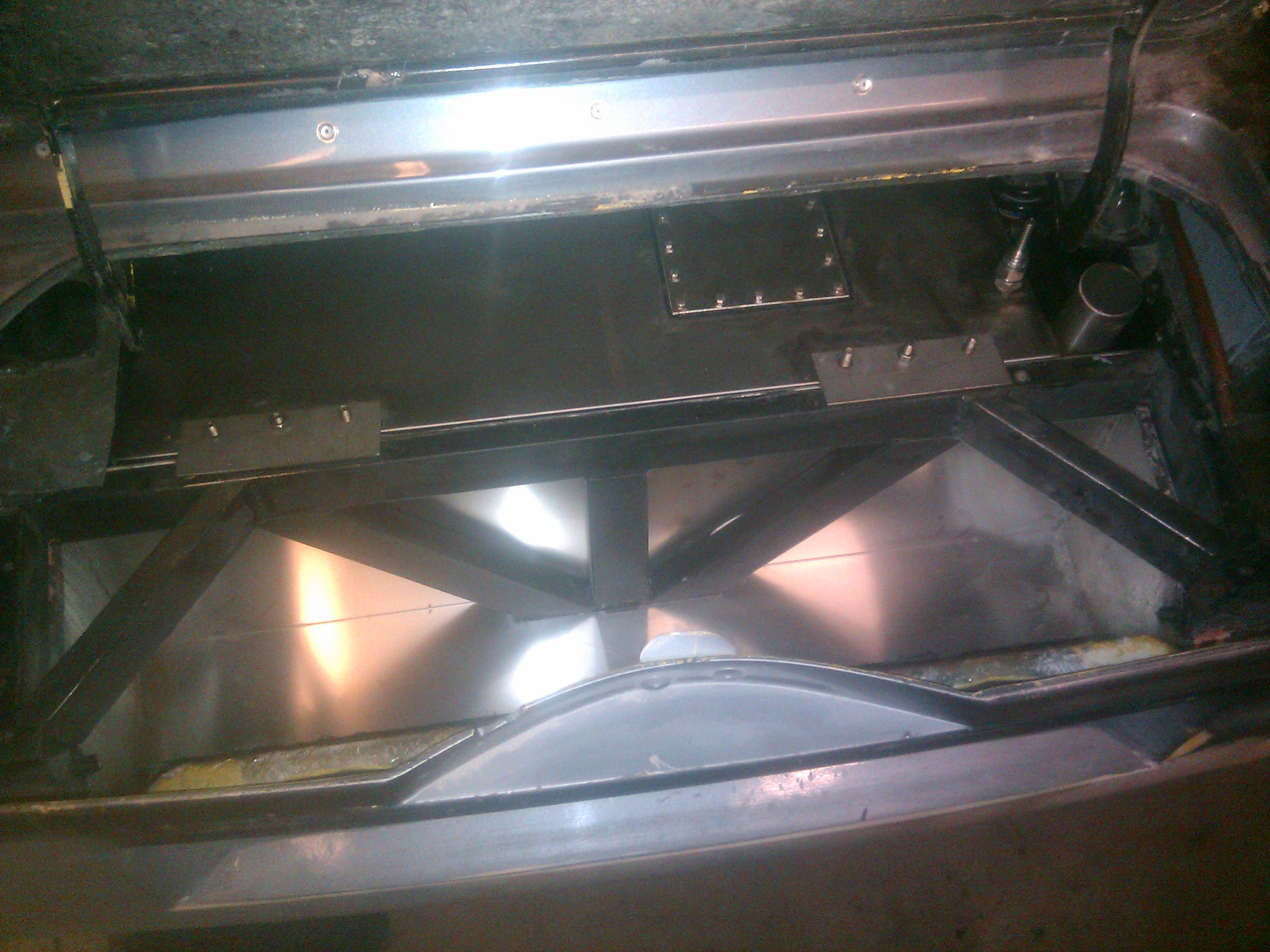

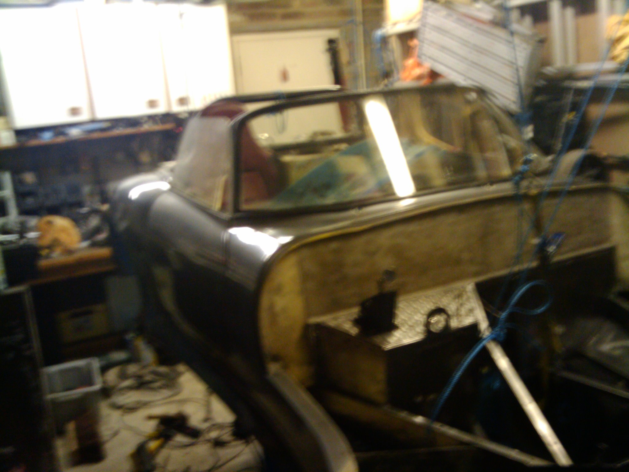

7. This is how the boot was when I brought the car...I thought it was abit small so i investigated into expanding it....

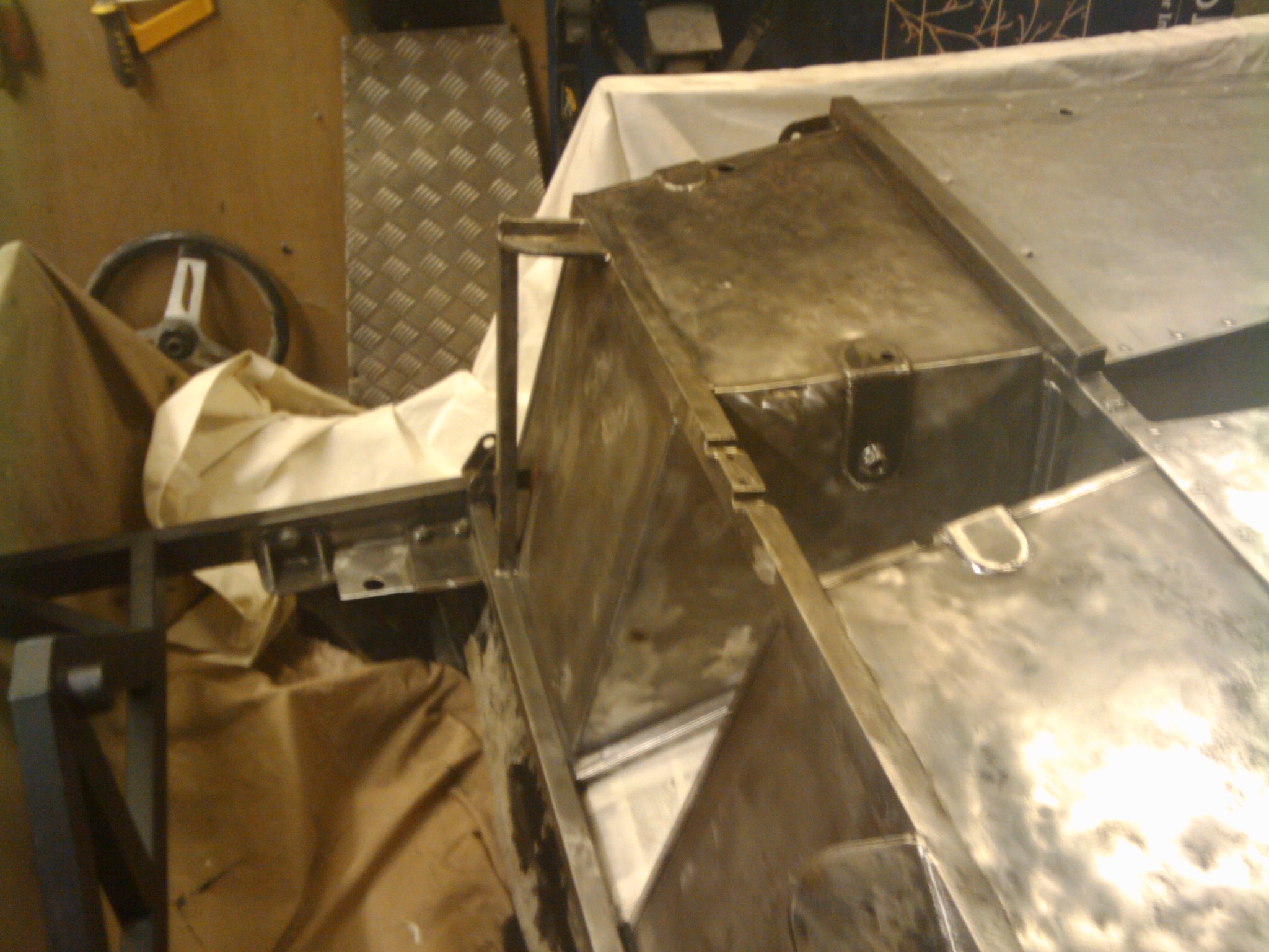

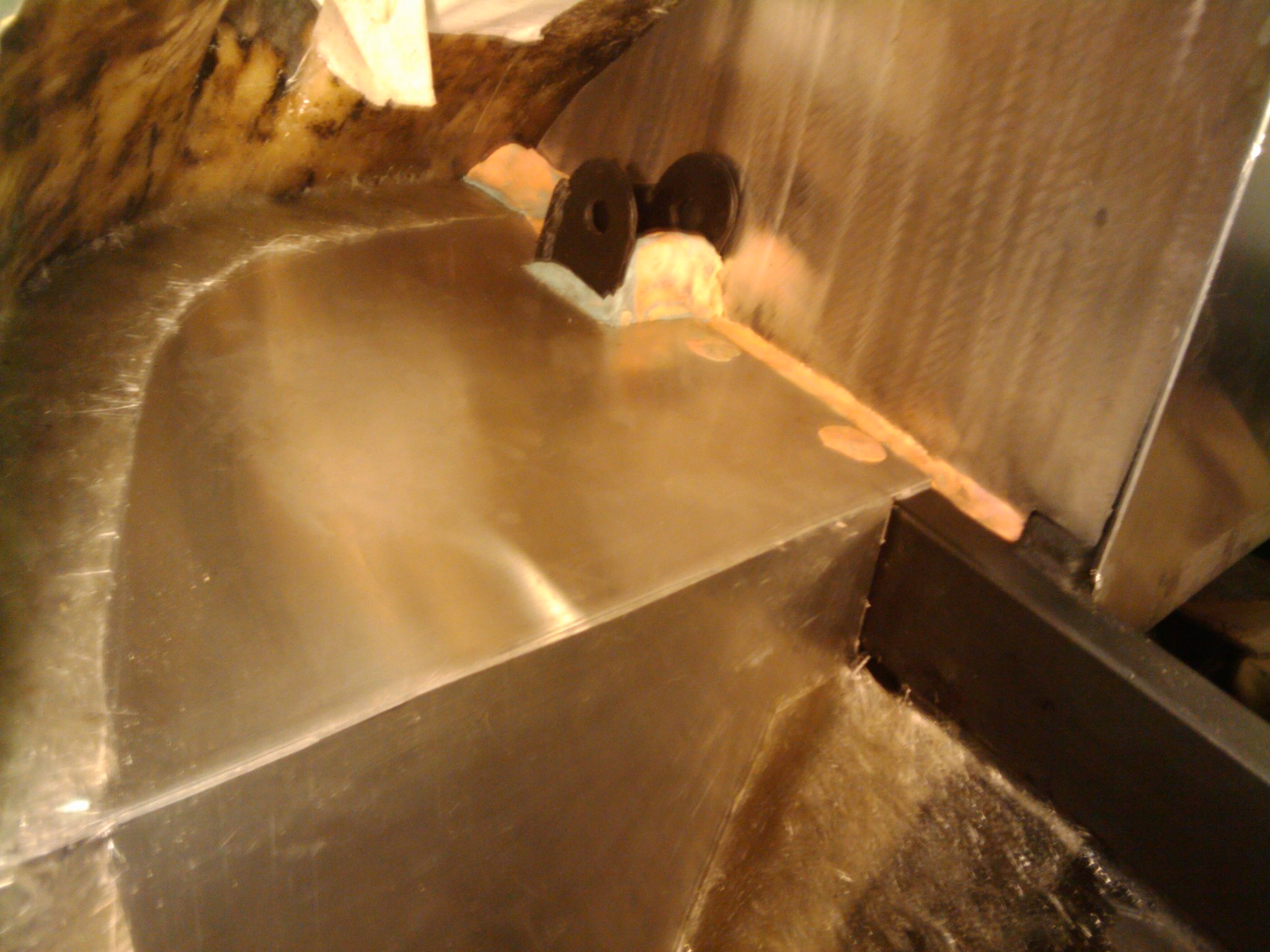

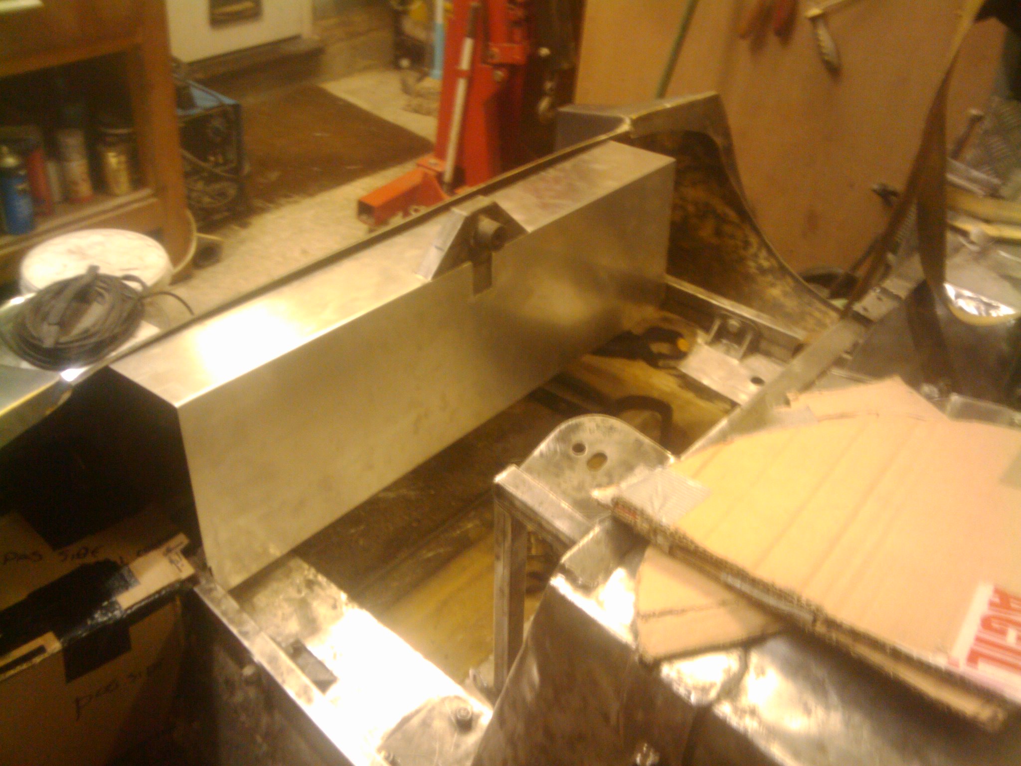

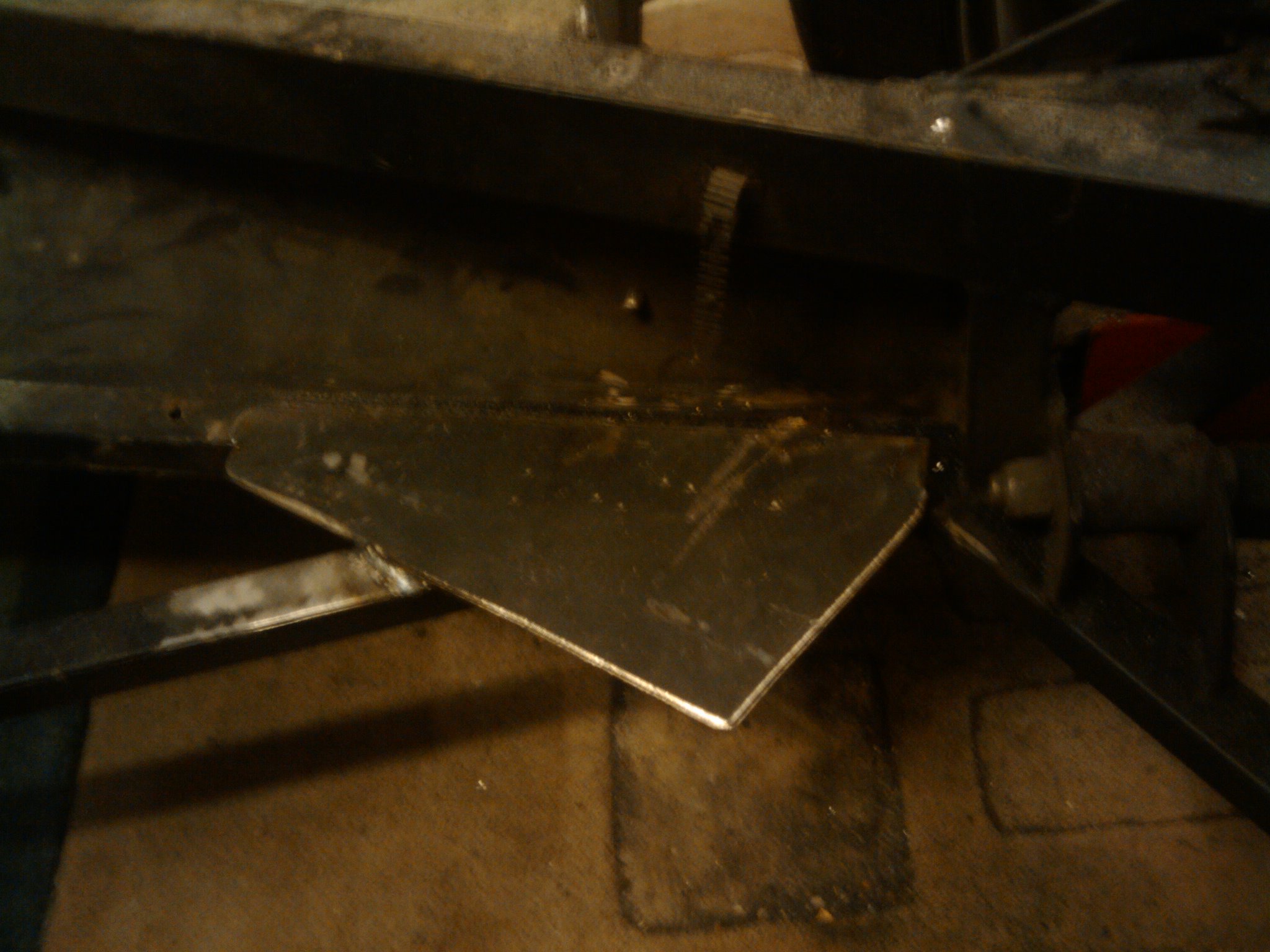

8. Boot floor & sides cut out, also the cross member
9. Aluminium panel fixed in place, Also started to make cardboard templates for either side
10. The cardboard cut outs were then transfered to aluminium sheet & fibreglassed into place

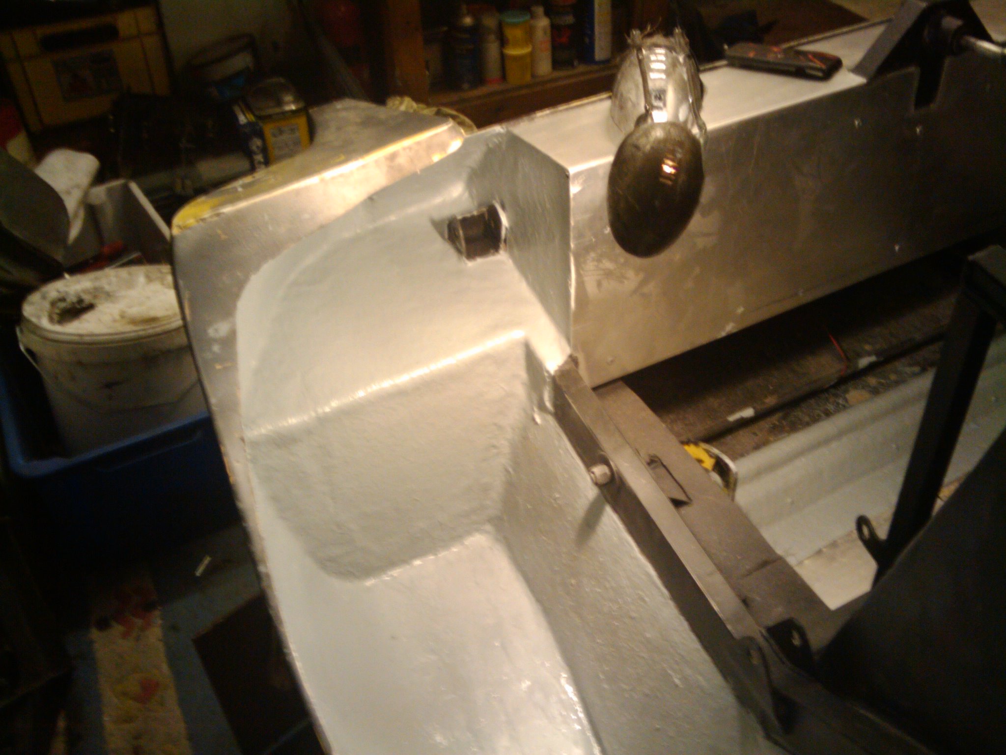

1. This is where the fuel filler hose passed through the side of the boot
2. As I smoothed the filler from the wing this was no longer required so i smoothed it over with a panel of fibreglass

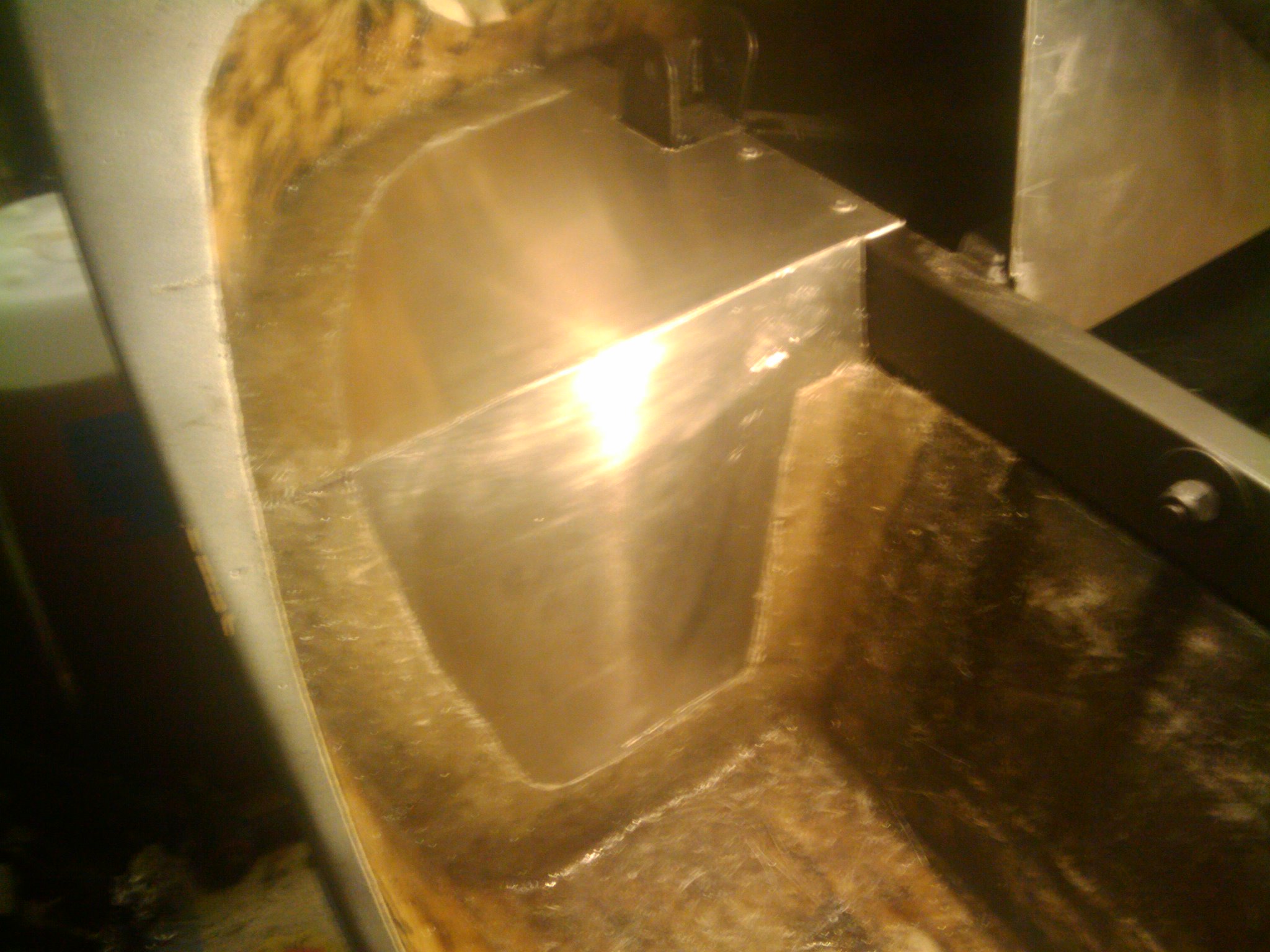

3. more playdoh forming :D

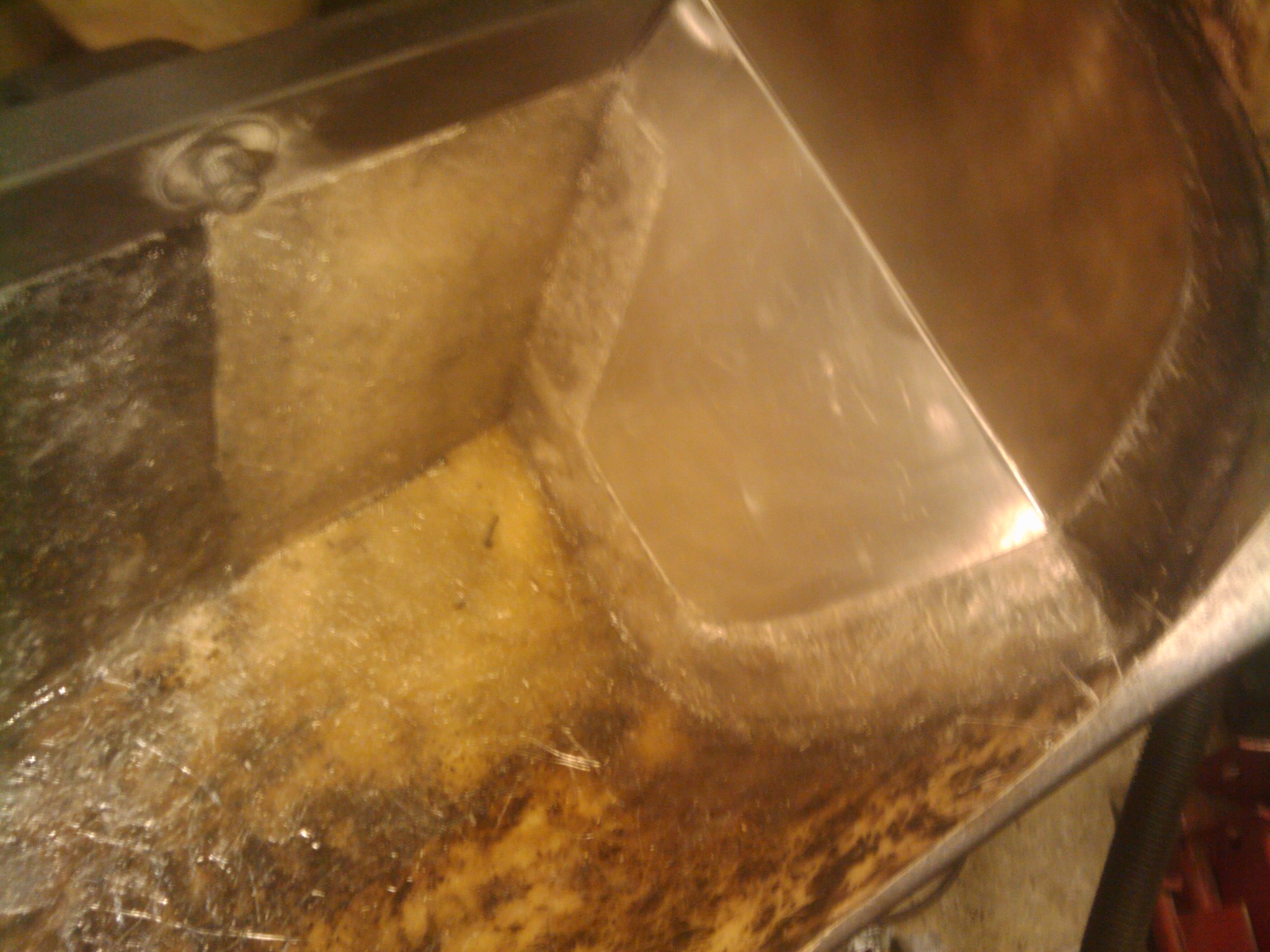

4. I then glassed over the aluminium panels
5. I then removed the aluminium panels from the inside, Just the fibreglass shape left
6. Here's it how it looks now, Much bigger than before!!
7. Another shot of the boot

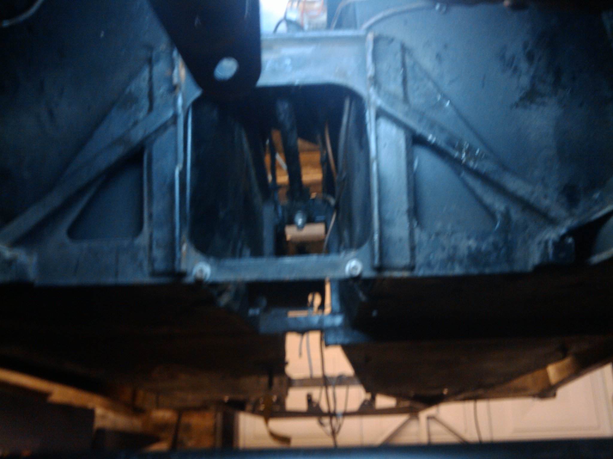

8. Heres the under body of the car after a coat of flowcoat, shows the extended boot nicely too :)
9. Flowcoat again
9. Flowcoat again
10. Other side after flowcoat.
