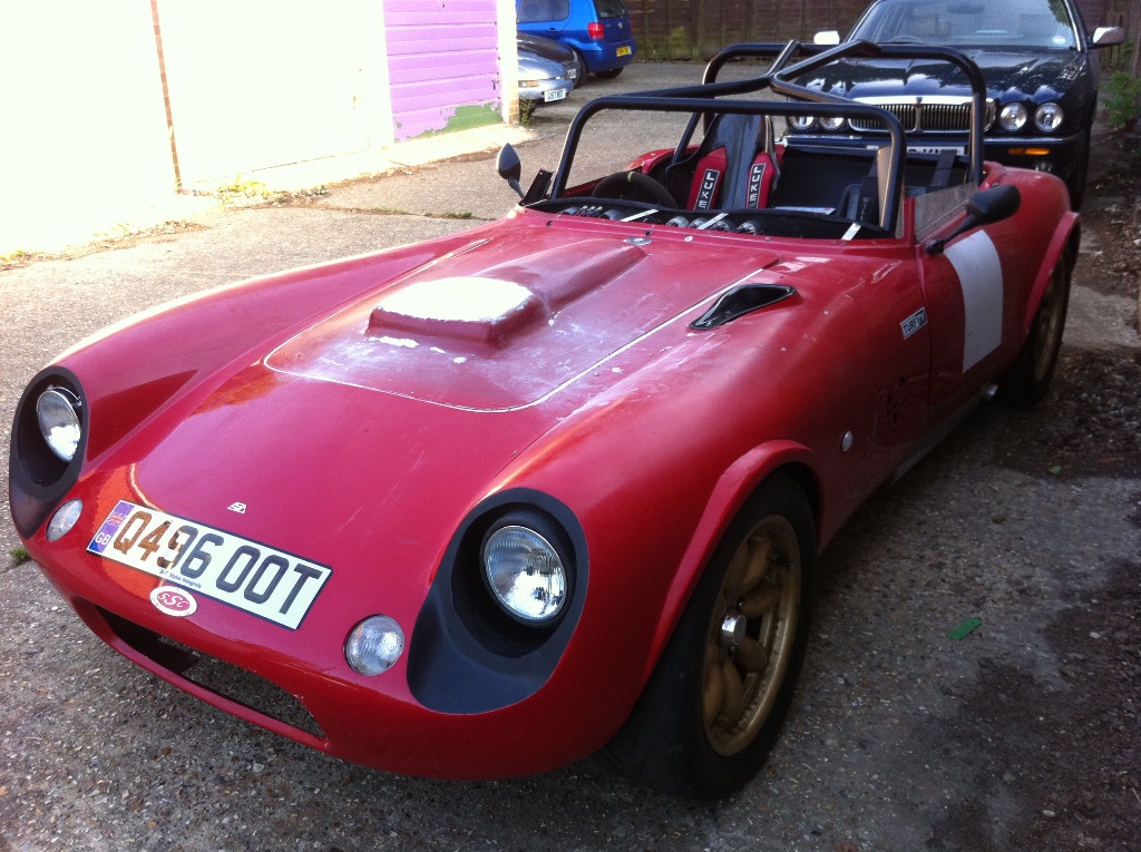

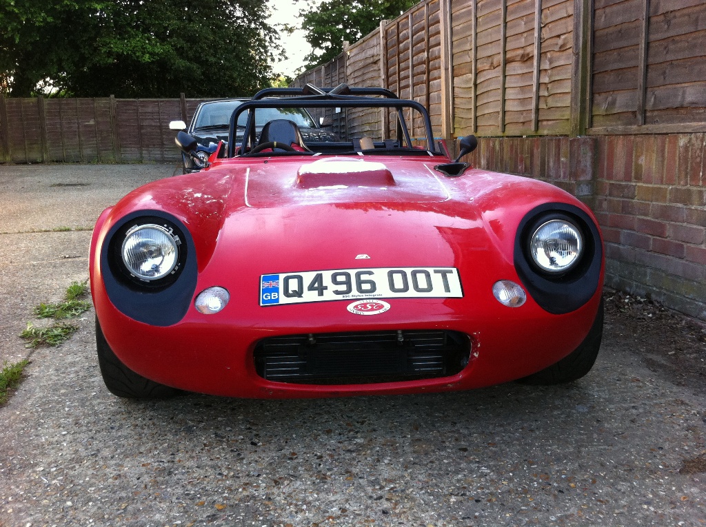

Posting plenty of pics today :roll:
My own car is nearly there too - now a year since I pulled the Zetec out :cry:
A few silly jobs left - main one is to get the bonnet bulge presentable & painted, plus fit aeroscreen & light covers.
Itching to drive it now :lol:
Heading towards a 60s retro look.... well that's the idea :!:
Re: More work & £££ !
Gonna run with a clear version of this aeroscreen & see how it goes.
