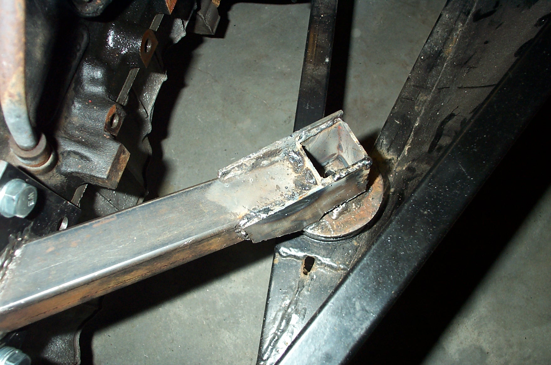

I managed to fabricate and weld the engine mounts and the car is on his wheels with the engine in.
Welding 2mm box tube isn't easy with a arcwelder. TBH this is my first attempt at welding, never done it before.
I still have enough materials to construct 2 more sets, so might fabricate the parts again and get them welded decently by someone that knows how to weld. But for building this will do.

Werner , you will need to weld a triangular plate about 3mm thick on the top edge of the engine mount that bolts to the block THEN weld the pointed end onto the tube. All original engine mounts were made as yours is but most eventually failed due to engine torque/braking/cornering. Look at the repair job I did on mine when replacing the engine. It cracked around the tube and split the bracket too.
stylussprinter wrote:Werner , you will need to weld a triangular plate about 3mm thick on the top edge of the engine mount that bolts to the block THEN weld the pointed end onto the tube. All original engine mounts were made as yours is but most eventually failed due to engine torque/braking/cornering. Look at the repair job I did on mine when replacing the engine. It cracked around the tube and split the bracket too.
SNAP! (literally!!!)
My steering rack brackets failed too, through lack of fillets....
From memory , I think that's because your car was not an RT from the outset but converted by Nathon from a classic , some years old. Pete Powell was then MD and built all cars as designed by J Phillips who thought a bit of tube was sufficient I noticed my ' rack ' moving with the force of moving the steering wheel when the bonnet was open . So the triangular gussetts were welded in years ago before they cracked Fury's had the same problems with engine mountings and steering rack mounts.
