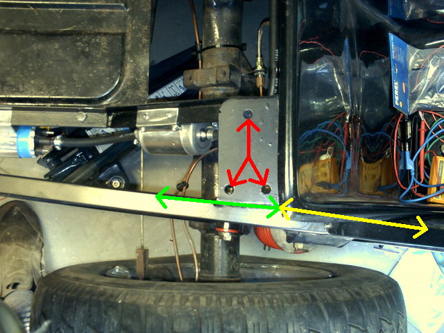

Regarding roll bar, i will have to get one made custom over here and want to know how and where it has to be mounted.
Also regarding the recent post of SVA fail regarding the roll bar. Is it necessary to have nuts welded to the underside of the holes of the red arrows?
I've also seen roll bars with supports going to the back and some to the front, wich is best and what are the distances for the green or yellow arrows?
Guess that where the supports mount that crushtubes will need to be welded in?
Also in the cross bar in the roll bar where the belts mount need crush tubes for the eyebolts?

Werner Van Loock wrote:and here we go again on a new question.

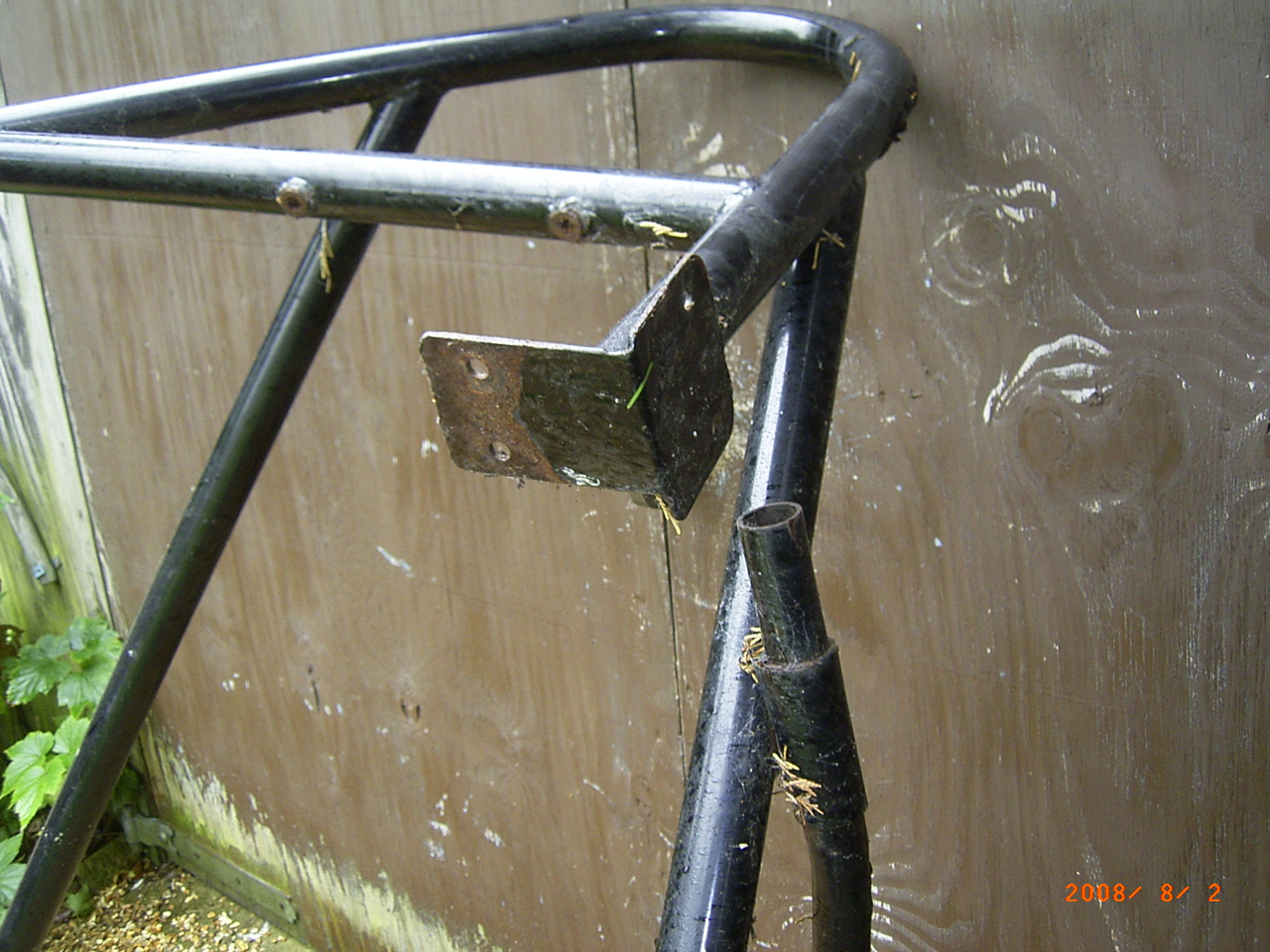

Just opposite the mounting plate in your pic' ---- you need a plate around 3 inches wide and 4 inches high welded vertically down the side of the 2 x 1 inch tube and projecting up around 2 inches above the plate in your pic'. The roll over bar can then have a 90 degree plate welded to the bottom of the bar tube sufficient to bolt down to the chassis plate and horizontally through the plate welded to the side . Sit in the car and measure from the ledge where the ' bar ' bolts onto , up to 4 inches above your head. With your height , you'll want a nice low to the floor seat to allow vision through the screen and to keep the top of the roll over bar to a minimum height . The standard factory ' bar ' years ago wouldn't have saved your head/neck in an overturned car accident. Mine is 23 inches from ledge to bar top.
Bolting wise , I can't see how they'll see the captive nuts if the car's finished / carpeted etc but crush tubes are a must and also can't be seen for welded or NOT . Definitely weld the roll over bar threaded tubes or they'll hold nothing --- they aren't crush tubes

You got me completely lost in the above part. HUH?
Werner , unfortunately my car in that area can't be seen . I'll try again. Where the 2 inch x 1 inch chassis side tubes slant up towards your shoulder/if sitting in the car --- then level off to form the boot area ----- at the point the tubes change angle THAT is where a plate should be welded (it will be opposite the plate with red markings in your pic' )
When the roll over bar is made it will have a plate welded to the bottom of its round tubes If another plate is welded to that outer edge pointing skywards it will be 90 degrees ---- THEN fit tight up to the plate welded onto the chassis 2 inch tubes They are then bolted together PLUS the bar is also bolted down through the plate in your pic' YES

Think i get it now, but what's the point of it? The roll bar has a brace so i don't see a point for extra bracing. Is it SVA necessary? If not i rather not start welding, my welding aint that good you know.
Werner Van Loock wrote:Think i get it now, but what's the point of it? The roll bar has a brace so i don't see a point for extra bracing. Is it SVA necessary? If not i rather not start welding, my welding aint that good you know.
It's much stronger that way . Sorry I can't do it for you but my leads wont stretch to Belgium. P.Powells bar wasn't that wide but Tim widened it so made alterations to it's attachment method. The bar tube originally was quite a distance from the sides of the chassis rails/tubes so apart from looking good did now't to save your neck and was also lower than most peoples head just to make sure it went under a standard hood

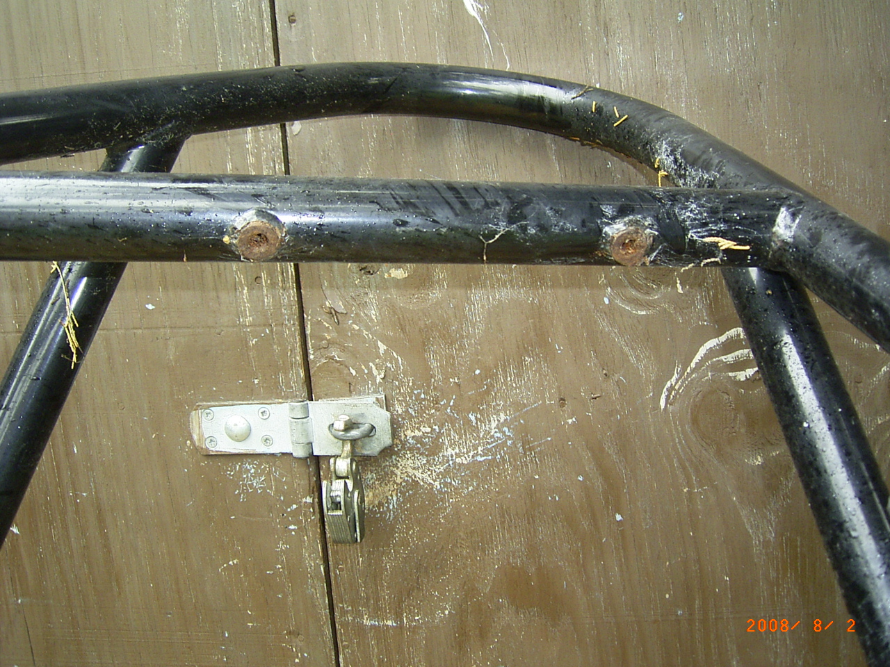

As promised Werner These pic's are of a single hoop ' bar ' but the bolting positions measurements are the same regardless of type of ' bar '
Distance between the two outer upright plates measured from the outside edges = 985mm (It's these two plates that will bolt to '' two other plates welded on the outside of the chassis tubes '' therefore matching their shape/fitting flat to them)
Distance between the front edge of the plate on the bottom of the ' bar ' tube TO the furthest edge of the forward diagonal support bracket = 390mm
