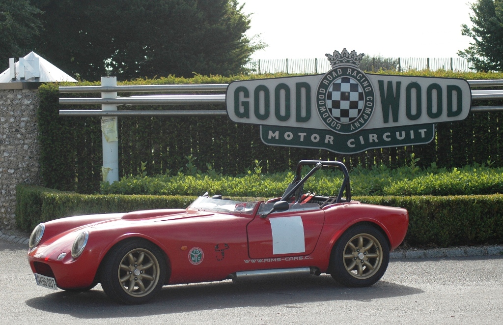

Well my Stylus did another faultless 200 miles on the road yesterday.
Had to go to Goodwood Horses for a tech problem, so took the Stylus rather than the tintop.
No getting away from it the car is awesome on the road.
Had a nice dual carriageway run from home up to Teddington, then a blat down to the office in Andover.
The A272 Winchester > Petersfield > Midhurst > Petworth road is a great motorcycle route.
Even better in a wound up Stylus, so good I had to do it again in reverse !!
Dropped in to Goodwood circuit & got a noise test done.
OK for Testday / 105 Sprints
Not OK for normal track days
New exhaust needed maybe, but I think even Rob's big bore jobbie won't get under 98dBs ??
Might do on a STD spec Zetec ??
