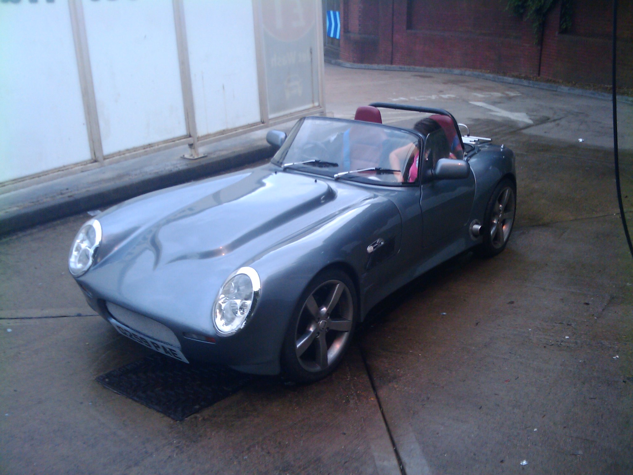

The Car!
Looked absolutely beautiful! But I have to say I was abit disappointed at first, after all the add did say how over £6k has been spent getting the car perfect...
The bonnet has a small crack under the light, and either side where it closes there was some light damage where it had closed onto the body of the car.
There was also bad paint damage where the doors weren’t adjusted properly.

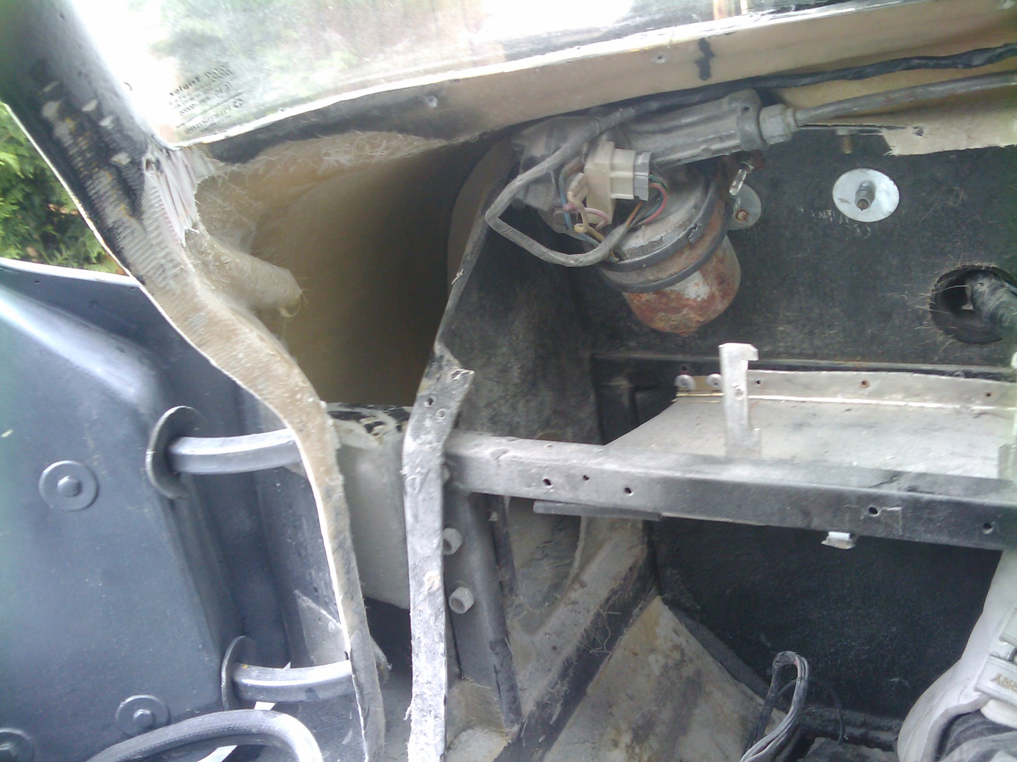

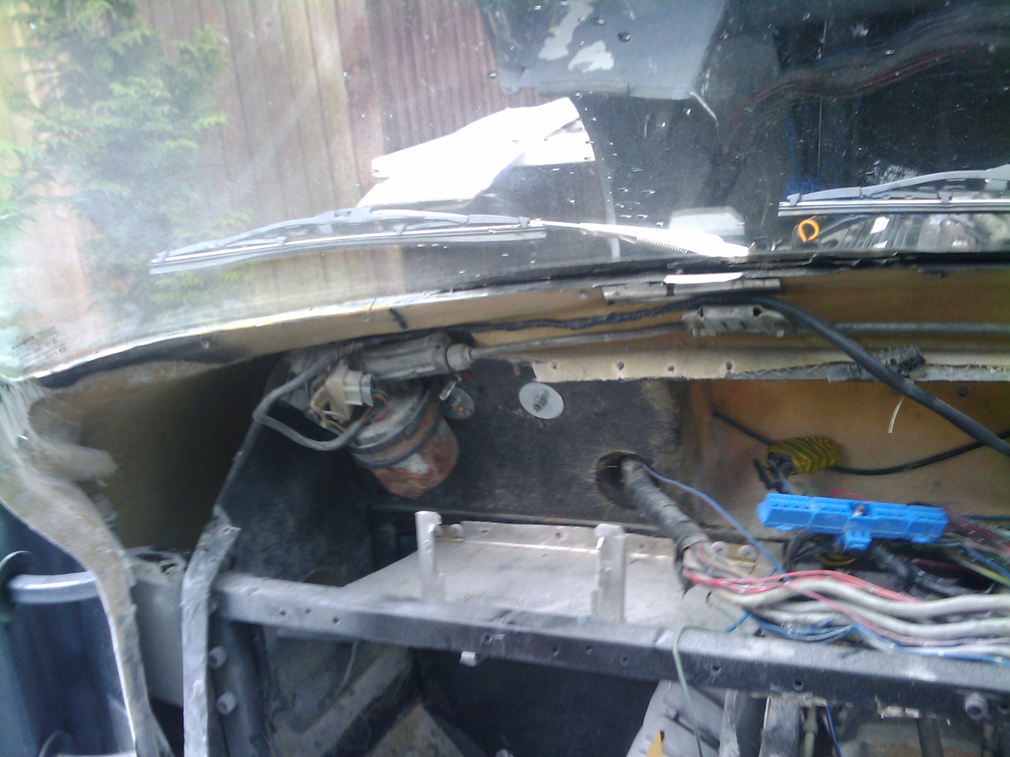

Whilst securing the battery down properly I noticed a kink in the fuel hose which explained the squealing pump…The braided fuel line (12mm ID) had been kinked and was crushed,(pics to come) After repositioning the pipe and trying to un-kink the pipe it seemed to run much better.

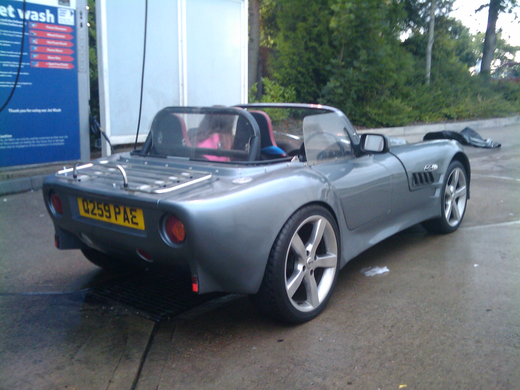

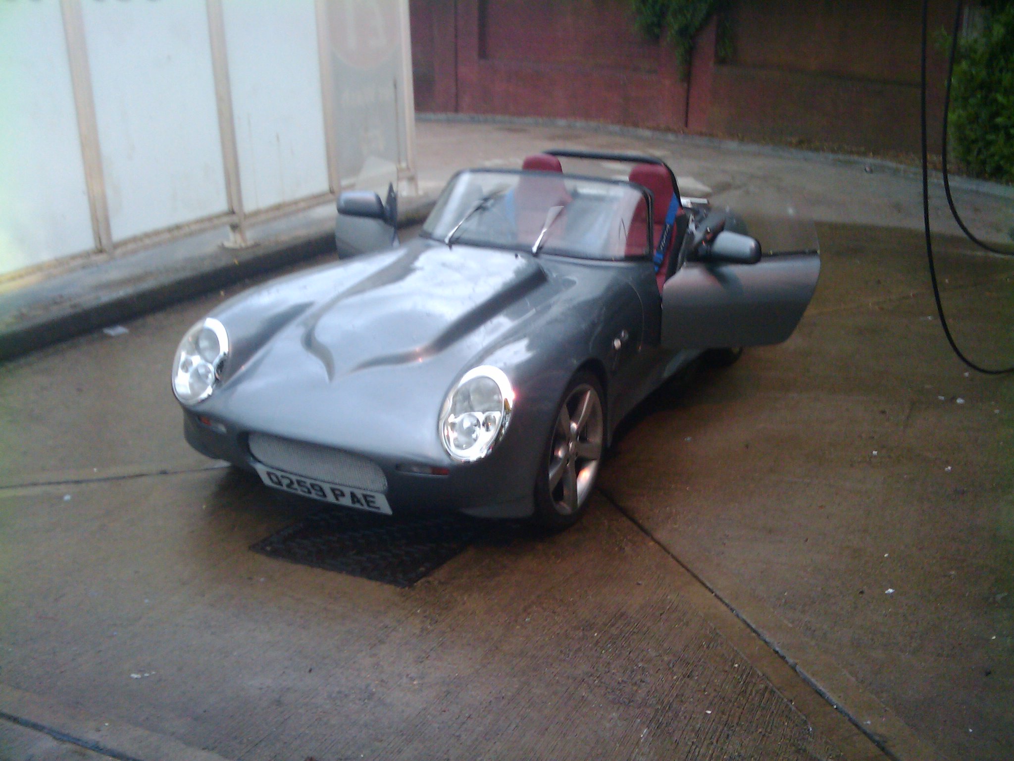

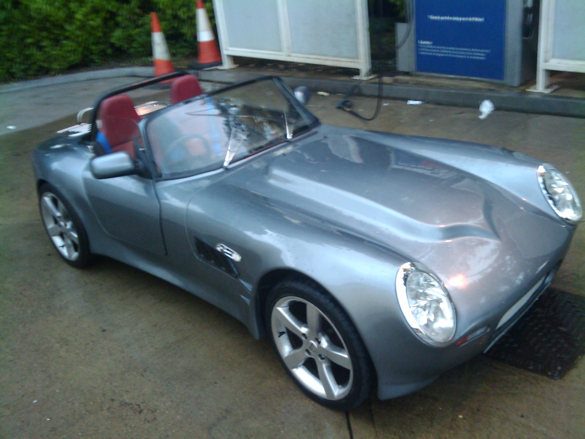

So I decided my new pride and joy deserved a clean as it looked as if it hadn’t been cleaned for months!

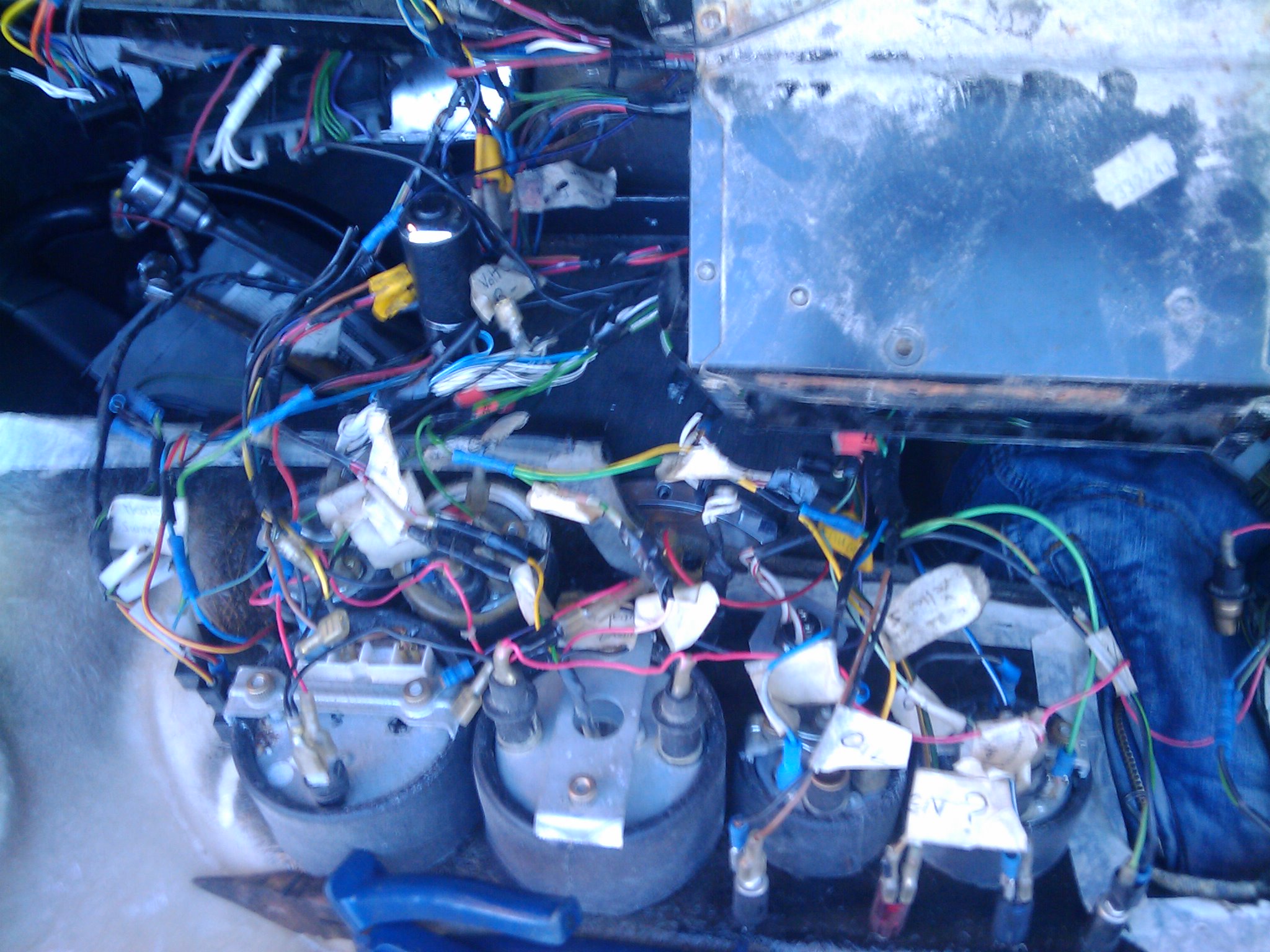

RPM Gauge not coming on turns out to be the voltage is low(11v) until you rev it up to about 1500-2000 rpm and then the alternator kicks in and Voltage jumps straight upto 13v, that will be getting changed shortly!
This was the first of many parts to be changed on the car.
since changing the fuel pipe the pump is almost silent again!
Cost £5
The car has been hesitating intermittently and this came down to the Facet fuel pump which feeds the swirl pot/catch tank in the engine bay was shot (pics to come)
The new one arrived today so that will be on the car shortly, Hopefully this will fix the hesitation!

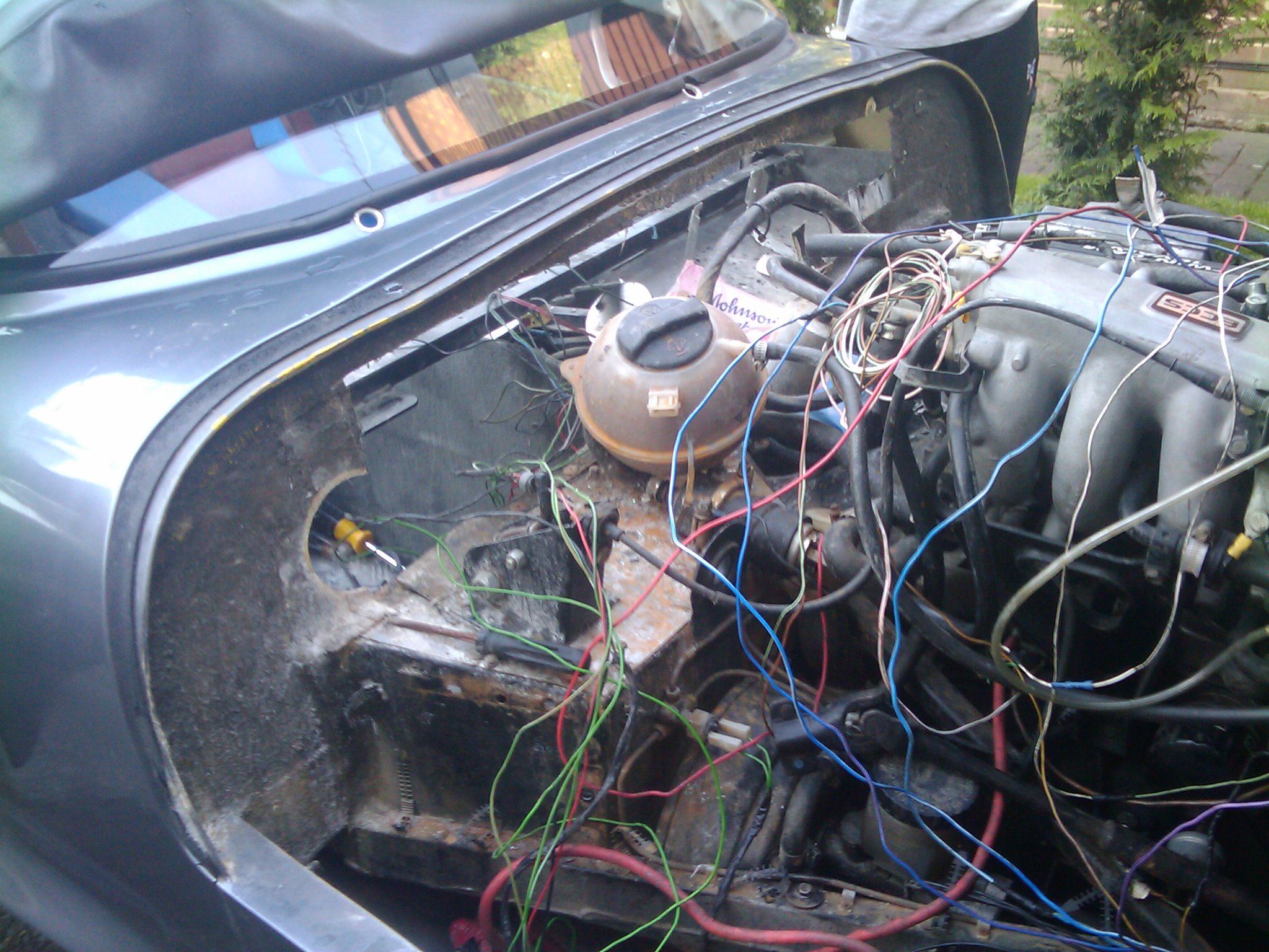

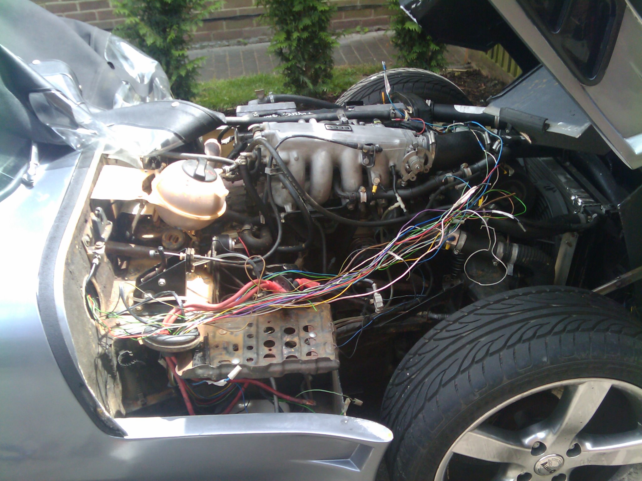

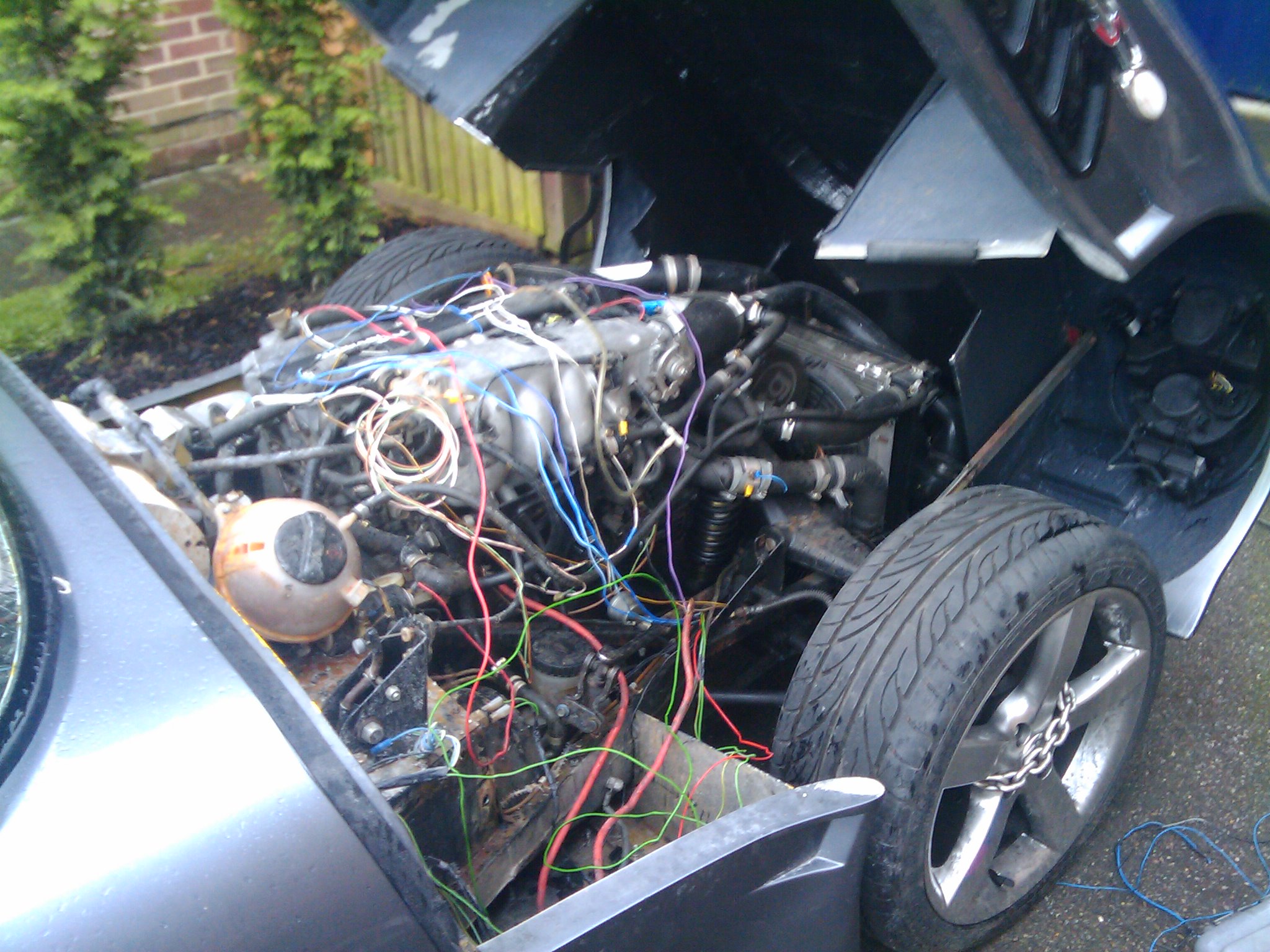

Manifold to head gasket was blowing by the time I got home, which wasn’t a biggy, so I ordered a new one, and in preparation for the new gasket I begun to removed the manifold,
Cost £20
At this time I also noticed that the exhaust pipe from the turbo to the back box had blown through the weld so whilst taking that off I managed to sheer one of the turbo bolts!
The manifolds not with a friend at the moment getting welded up and he is going to see if he can ‘easy-out’ the sheered bolt…. Fingers crossed!
