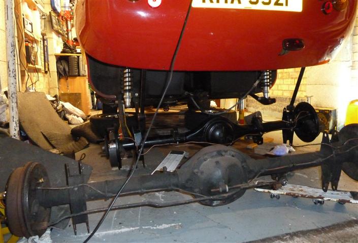

After suffering rear traction issues from the massive power my Crossflow puts out I thought there is only one way to improve traction and that was to follow Tyrell and WIlliams F1 ideas and go for 6 wheels.......

Nice that you have a spare axle Rob , or is it a different ratio
The one at the back is the original Koln axle which by what I've read should have lunched itself already with the power I've put through it as it was only ever fitted to German 1.3 escorts.
The new one (one under the car) is a English and should take more power and came from DH2s car. I'm swapping over as I've had to remove the tank and it wouldn't come out without taking the axle off so thought I'd swap at the same time.
