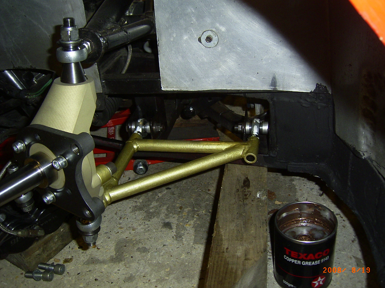

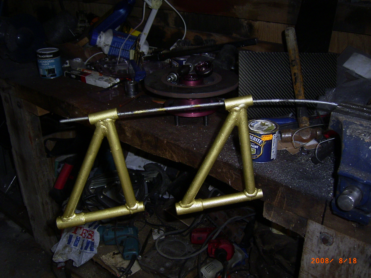

Wishbones welded up and painted ready to fit
Re: TWMC Goodwood TONHIRE SPRINT 28TH June.
looking good, made 2 new ones, or is it one new and the original good one you also painted?
Yes , that's right . One new and the original pattern from the passenger side. The billet uprights are gold adonised and I had the gold hammerite anyway from doing the rear drums years agoWerner Van Loock wrote:looking good, made 2 new ones, or is it one new and the original good one you also painted?

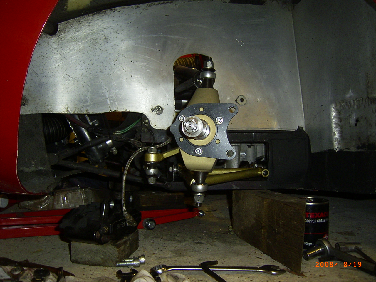

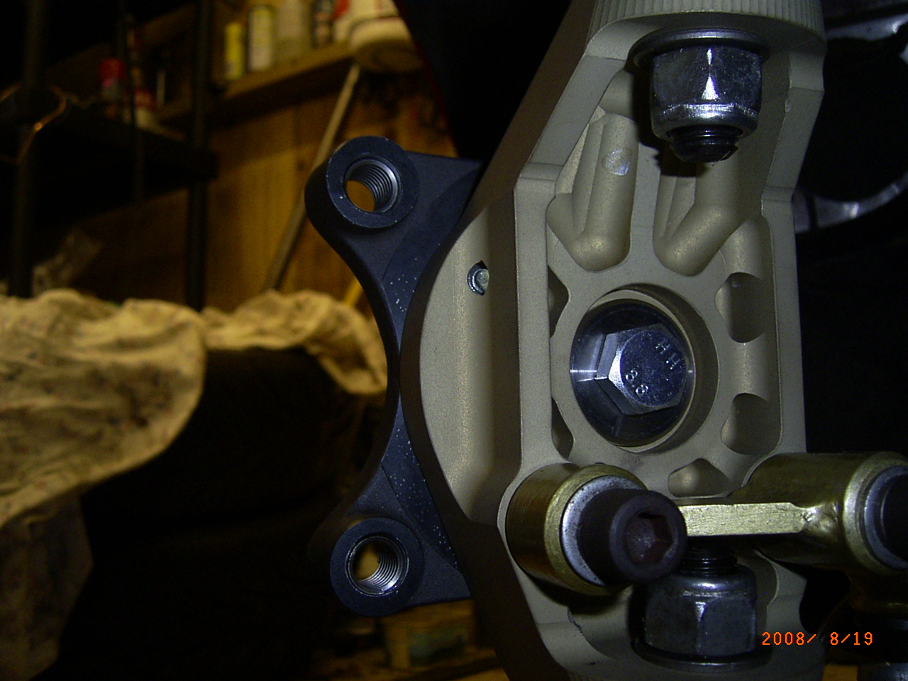

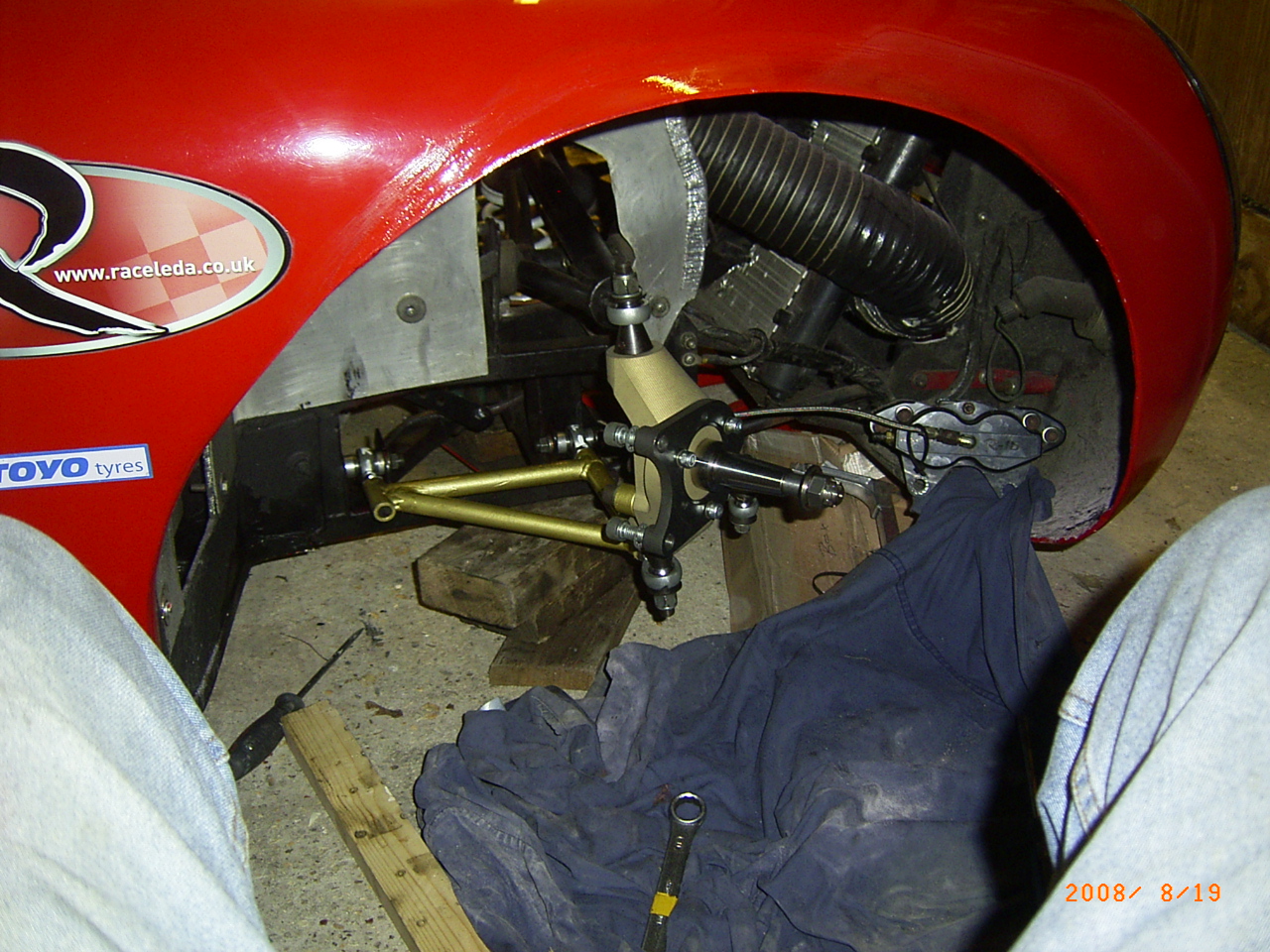

Got it all together again apart from mounting the callipers and fitting new wheel bearings which I'm waiting for. One problem was not keeping the paperwork from the Raceleda uprights with all the torque settings
I'll have to contact my friend to get his advice. All the upright threads are coiled so they're only finger tight at the moment.
The set-up of the wishbones is simple enough because I marked everything plus counted the threads each rod-end was per corner ---- it took a lot of hassle and experiment setting it up when I first rose jointed everything so it was worth recording all the positions
When you've got a friendly set-up it's good to be able to repeat it
Still waiting for torque settings on the uprights so they're not bolted up tight yet. The wheel bearings arrived in the post today so the old ones are knocked out and new ones pressed in/grease packed all ready to fit
Very boring swiddling your fingers when you actually have the time to work on the car but can't move forward for the want of parts OR tech' info .
You'd think with 50 years of fitting wheel bearings to everything from a tractor to a lawn tractor , road and kit car , that I wouldn't over tighten them
Can't think of any other reason that I've messed up two sets over 4 events and 2 track sessions
In case it's the nyloc method that Raceleda supplied in the begining , I've bought new stub axles for the uprights that are grooved and split pinned , like FORD always used ----- hopefully they will stay the course this time. They aren't loose / warn but are a tad notchy when you turn the wheel when it's jacked up

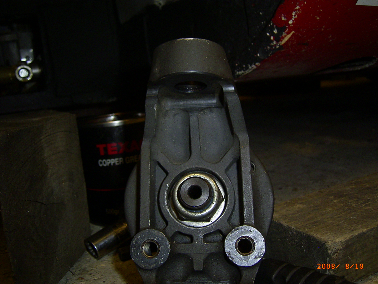

Did my grand parental duty this morning going through 11 plus questions with my 10 year old grand daughter
SO ------- I thought this afternoon , now the torque settings have arrived via email , I'd bolt up with locktite then fit the hub/disc/bearing assemblies -- h'mmmm
First side went on a doddle , all bolted up and bearing adjusted , calliper bolted/torqued
The other side was a pain ---- wouldn't push on at all , period
It was so difficult to get off without damaging the new seal too --- however , having got it off and removed the seal and bearing , I tried the bearing only up the stub axle ------- absolutely no chance
Cleaned all the grease from it and measured it against the old one only to find it was 1.5 mm smaller diameter
I've never had that happen in 50 years of spannering
--- outer bearing was fine
So now it'll be bl-----dy Tuesday before I can finish the job , what a pain
Just fitted the ' correct ' bearing at last. It arrived this morning while I was working --- you know , that stuff you do to pay the bills
Just need to get it up in the air at the rear to see if any damage was done there seeing as it sounded pretty loud spinning around over that rumble concrete
May have to shift the axle a touch for a touch more clearance between prop' and tunnell under cornering --- if that's what I'm hearing through the quick corners
Paint job needs more work but it's not going to stop me getting on track
