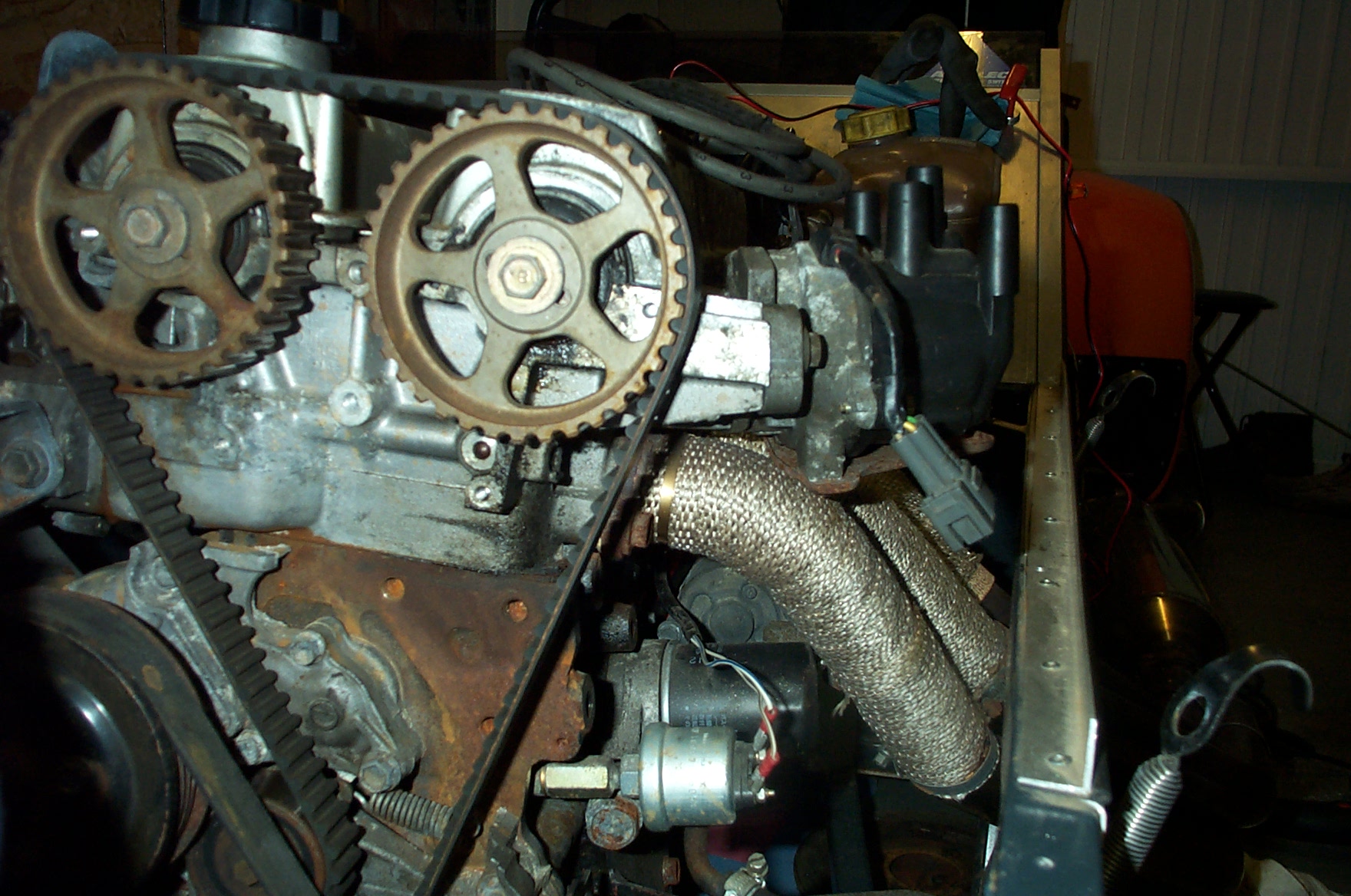

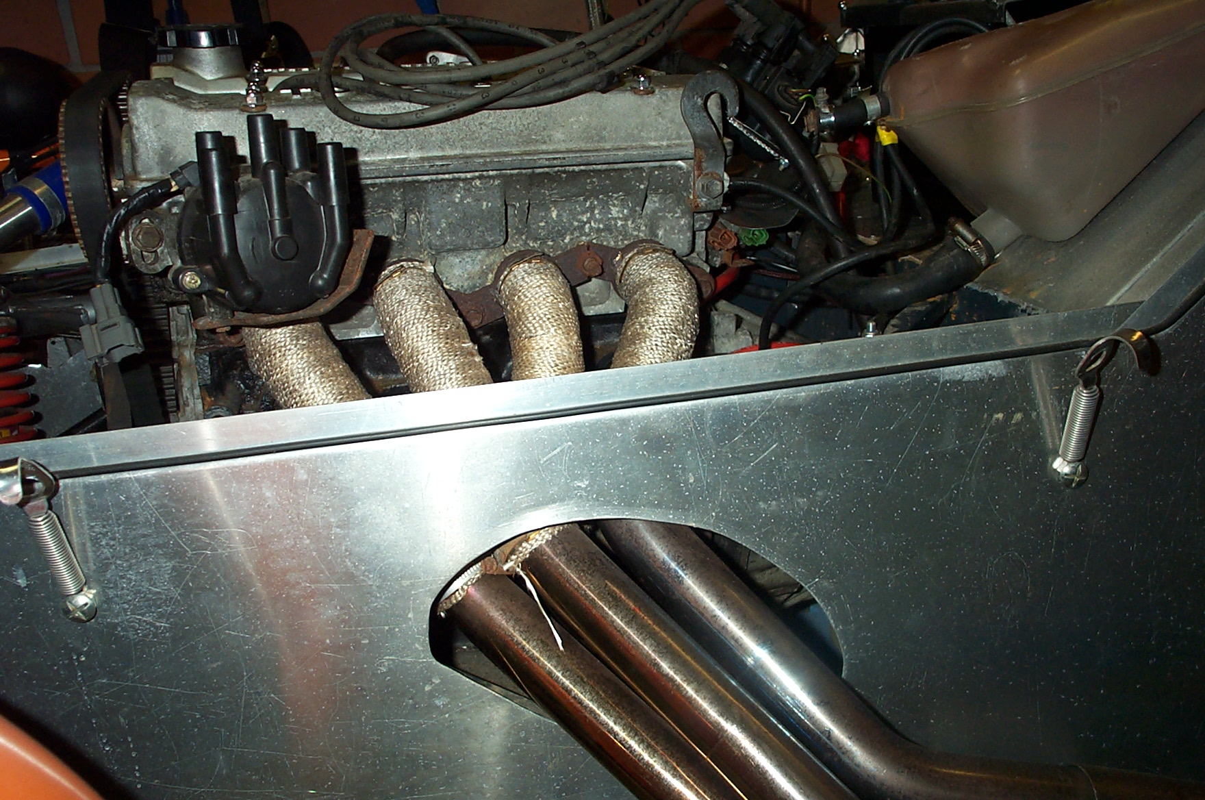

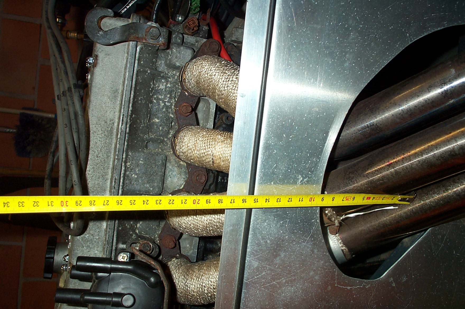

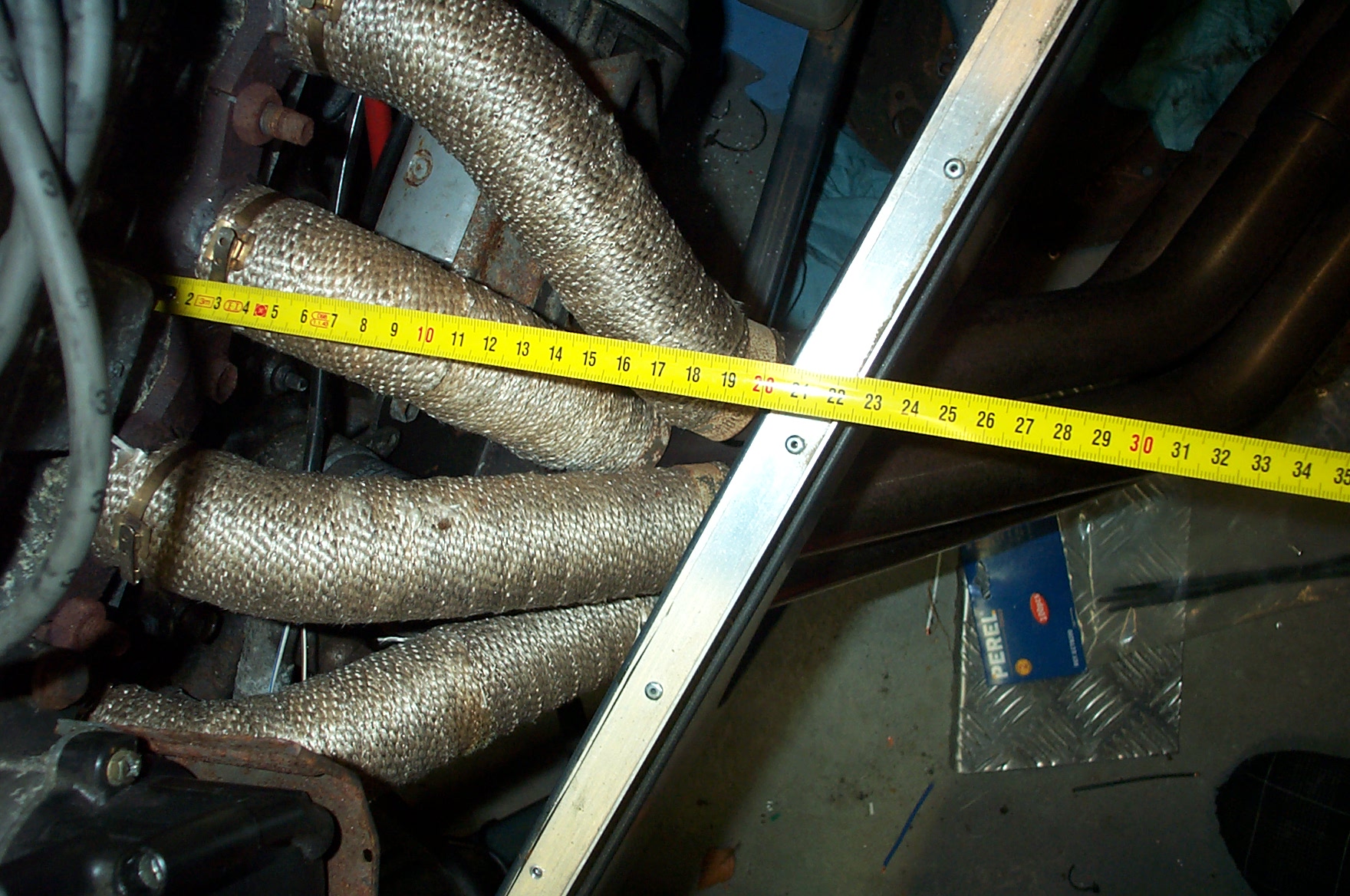

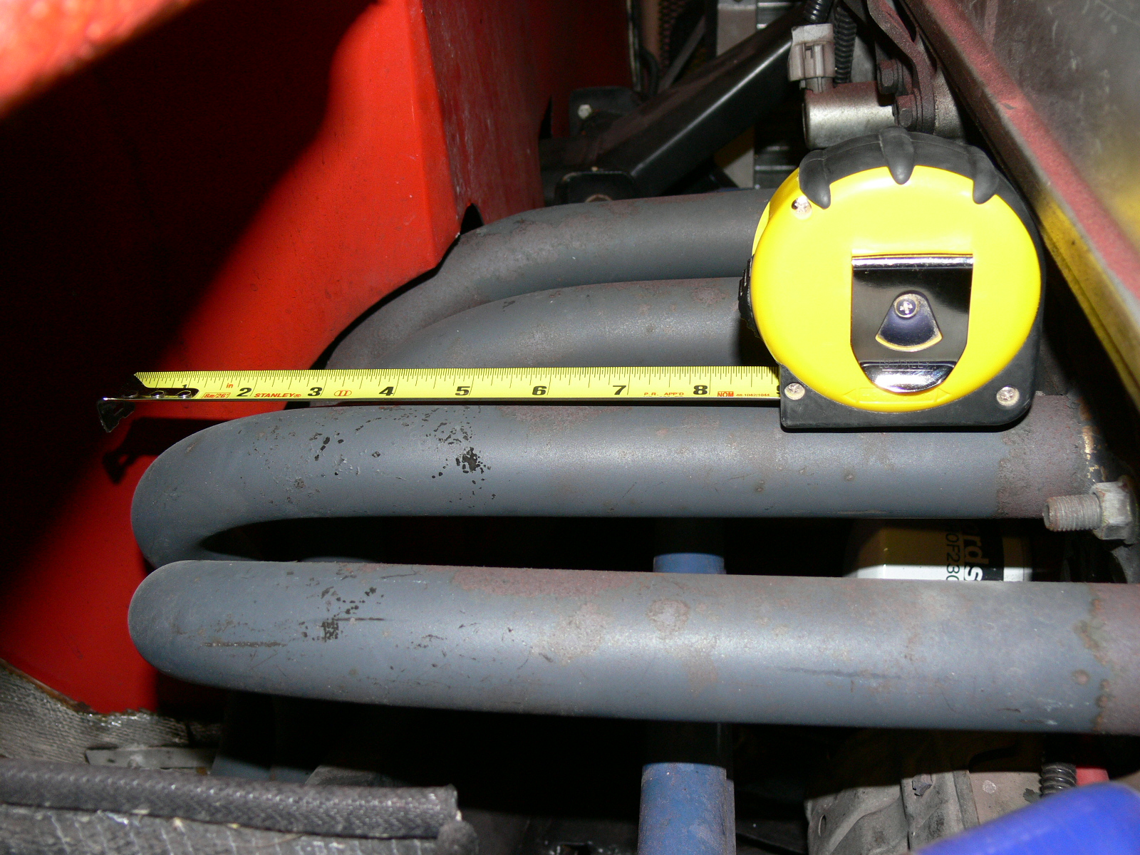

Well I have tried to get some pics!!! not the easiest place to photograph.
The pipes come from the head until they are over the chassis rail and then come together in a bundle running along the rail until they join together in the 4 way collector. As best I can measure they are all around 30" from the block to the start of the collector.
Hope this helps

Thank you very much Pete. Our other option is to get a RAW manifold, now i know how far it needs to come out gives me a good start. However, at £225 im a little put off, especially as we will probally end up having to cut and shut it

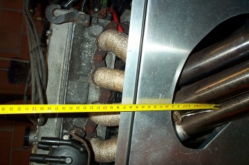

I'll check in the garage on the striker, it has a Raw 4age exhaust on it
Re: Manifold
here it is, don't think that even with a cut and shut it would fit
measurements are in cm, don't use any imperial measurements here

many thanks Werner. It is like i thought it is, has a shallower "throw" from the head itself as it doesnt have so much distance to travel. Looks like that option is out then!
