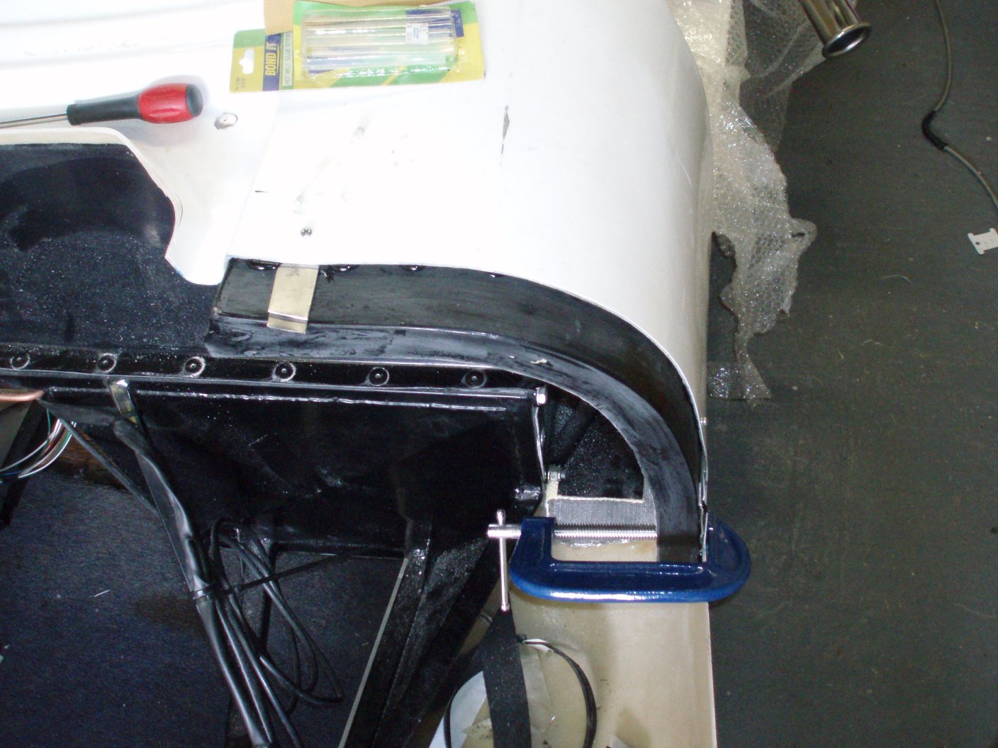

Me and the old man have taken this week off to get loads done on the stylus! Just some pics so far.....
Shocks are now in place, awaiting Robs roll bar to be fitted on the front. Doors are now fibreglassed in place.

Surprised you put the door skins together off the car
Re: A week working on the car!
nope, did them on the car and stuck them with sikaflex, then took them off to bond them together with fibreglass
Good man --- you had be worried re -- shut linesPete&Matt wrote:nope, did them on the car and stuck them with sikaflex, then took them off to bond them together with fibreglass
