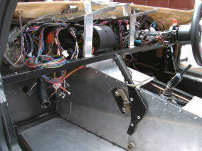

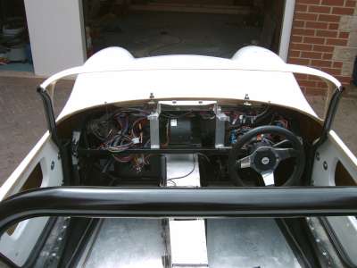

We were initially going to take a hot air take off from the manifold and blow it into the car to get some hot air, however, speaking to people who have done this, say dont bother!
So! have looked at small heaters, the smallest being one from Westfield, but its all going to be too tight in behind the dash with all the other stuff we have in there! What have you guys who run heater done? We are thinking of making up a small box with a matrix in it and using the bilge fan we already have with all the pipework and doing that as we can mount it all in the drivers side sill area. Pics would be excellent!

I got my self a after market heater unit from stoneleigh some years ago,cant see a deal on the pic's soz...
Pete&Matt wrote:Heaters!!!
