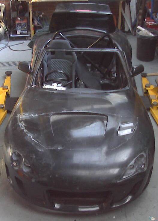

I accompanied a friend of mine to SVA about 3 weeks ago now, with a Subaru based Murtaya kit (£20K+).
We'd spent 4 days solid over the Easter weekend getting bits done, but it was clear (to me anyway, owner was in denial
) the car wasn't going to be fully "presentable".
The rebuilt 350BHP engine ran for the first time & the car drove out of the garage on the Monday, SVA on the Wed.
We also fried part of the loom & had a small fire on the Monday evening, as we hadn't properly earthed the starter (it was accidentally insulated & dumping the current down an ECU earth, ouch). 1 am to trace it out & rectify.
The car was submitted unpainted (edges knocked off), with engine, transmission, brakes & suspension fitted, all lights in & working. But no screen, wipers (& no centre mirror), no heater, one seat, one belt, no door glass, no locks, no dash, no trim (you get the idea).
The killer was that the car decided the engine wasn't going to run on the day of the test, so we pushed it on the trailer & set off. After the test we found out this was due to the new ECU startup map being too rich & flooding it.
