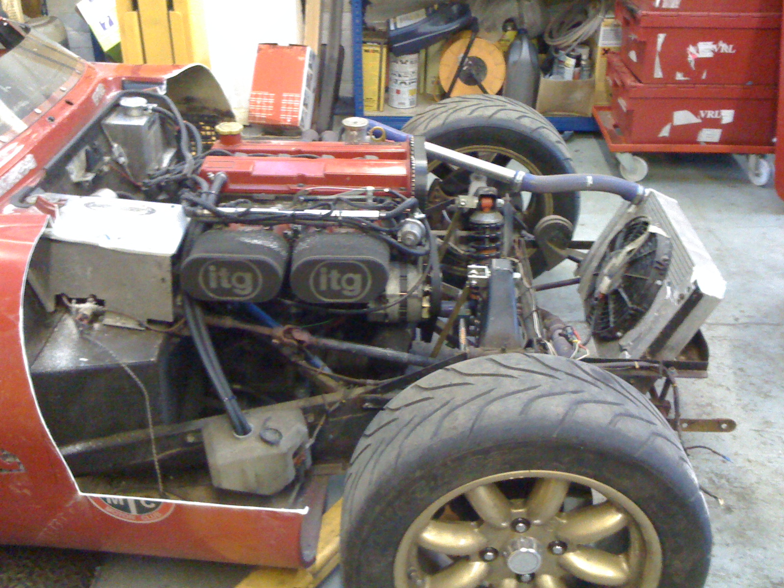

Here's a pick of my old 2ltr silvertop zetec setup, about 5 mins after I'd cut the front off & about 15 before the engine came out for good.
(Blimey does that look a simple layout compared to what's in the car now )
Difficult to see, but its the long version Jenveys (DCOE replacement), with 2" ali rampipes & ITG dual port air filters, all on a Raceline inlet manifold.
It was reasonably tight, but did all fit under the bonnet.
The horizontal clearance was never a problem as they went into the void under the wing.
What was more of an issue was the vertical clearance on the front TB pair to the underside of the bonnet gutter (as the bonnet narrows & drop towards the front). I just cleaned it up with a power file to suit.
But a big K&N airbox or similar probably would be a real problem. Rob F has an F3 style airbox under his bonnet, and uses the shorter style TBs from Dunnell.

Mine is the same as Matts photo above.
Short trumpets (2"). With the foam filters. i am trying to sort an air box out with cold air feed at the moment.
As you can see from Matts photo, the foam filters end up in line with the pedal box edge (if thats any help).
Cant comment on the effect of short/long throttle bodys or trumpets. Although longer trumpets are supposed to be best.
