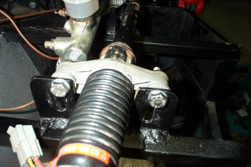

did you have any luck with this as i melted mine last night while welding a bracket to the column!

Not a good idea
it's very thin . If it's got to be fixed to the pedal box or whatever then clamping's a better bet
Any replacement can be made from poly water pipe , agricultural grade . It's a little thinner and easier to rasp away

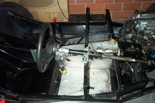

I would cut off the brackets for the escort column and weld some on for a sierra column, it was done to mine. I'll take a pic this evening.

We have the mini steering column set-up. its very lite and simple!

Werner,
could you please measure you column forr me?, I need the length from the end where the wheel fits to the first knuck joint.
If its the same as the escort and will connect to my lower existing part, i will fit a sierra one as I have the stalk assembly and surround for a sierra so would make life much easier in the long run. I jkust need it to round the turbo, which at the moment, it doesnt

well, i would like to measure but my original fixed column has a welded boss on for a detacheable steering wheel and therefore it will be different from a original column. The other column i have is a extendible one, so no good either i guess.
