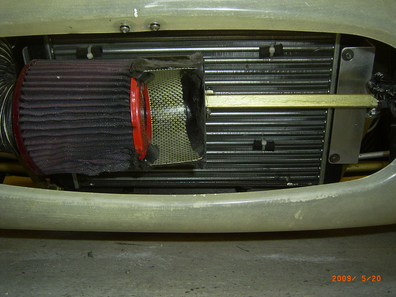

Matt and Kevin both thought my air scoop had crap flow potential , so as a half hearted modification to improve it , I've sikaflexed in a thin curve of kevlar level with the mouth of what was the forward air entry. If this isn't enough to supply the beast with it's appetite for air then I intend to cut the 100mm pipe within the engine bay and fit an inline filter. The open end of the pipe can then point forward again behind the grill guard.

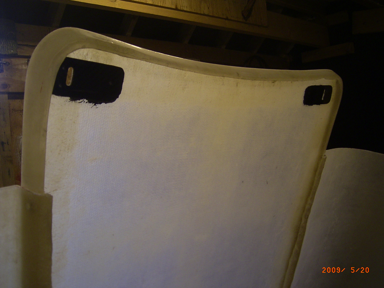

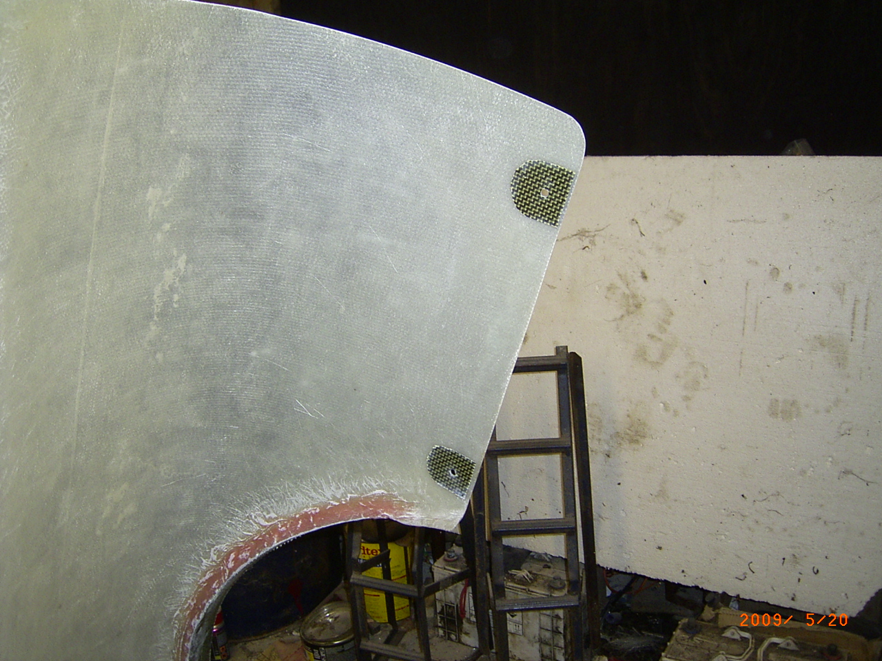

Bits of kevlar for ' hole ' strengthening at the side shut lines are in. If trying to shut the flip on your own , it's quite tricky and easy to snag the shut lines at the bottom ie -- shut inside rather than outside

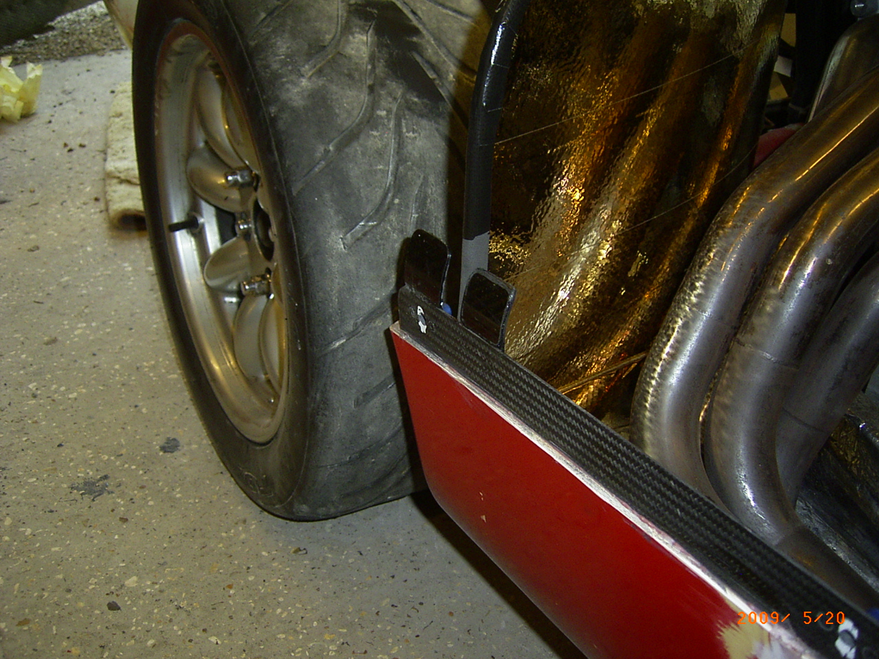

With that in mind , I've utilised bits of my old carbon exhaust to make curved guides to draw the passenger side bottom shut into position.

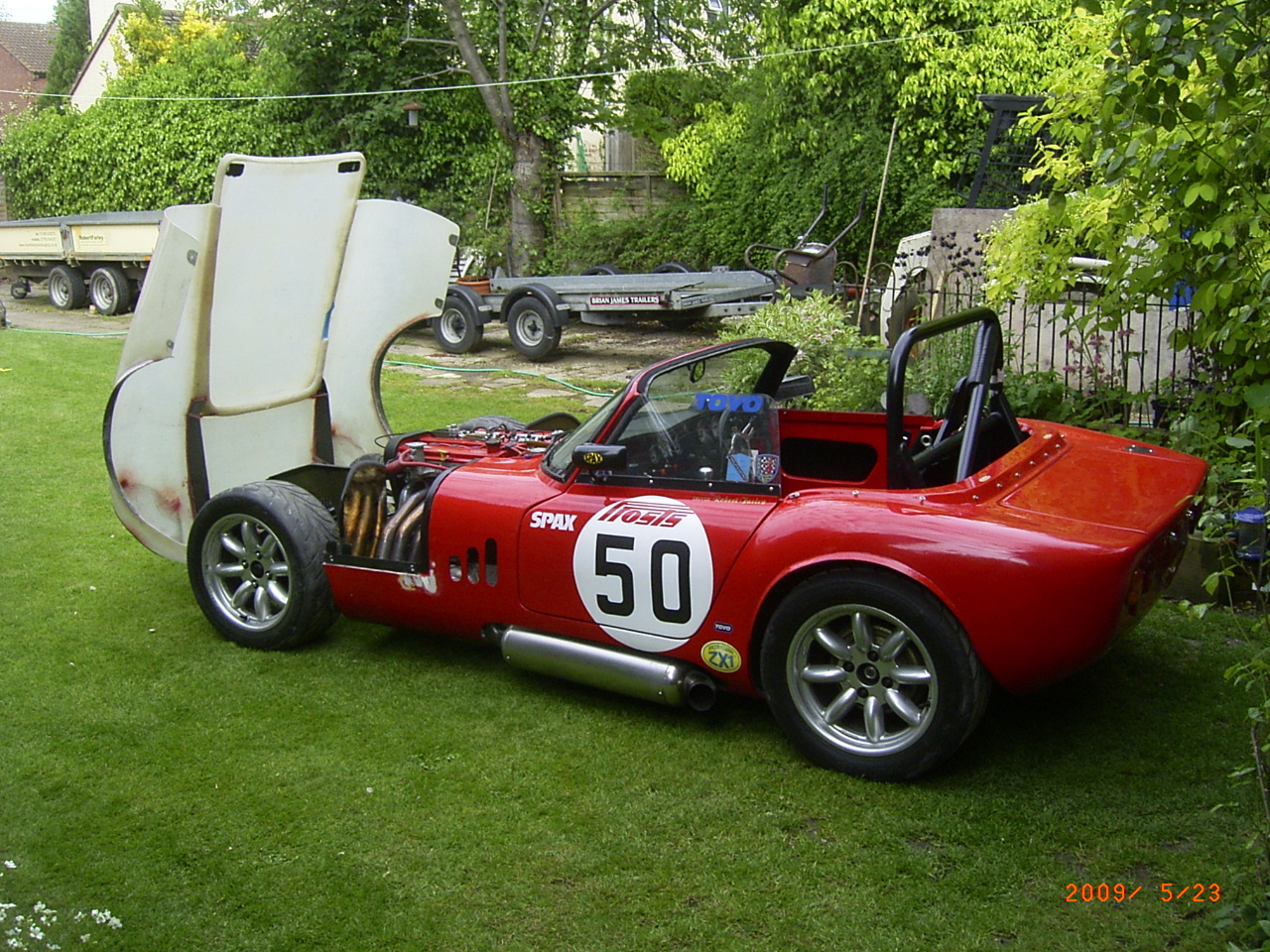

Getting bored now , waiting for the paint job so pushed it out onto the lawn , ran it up to temperature then sat looking at it

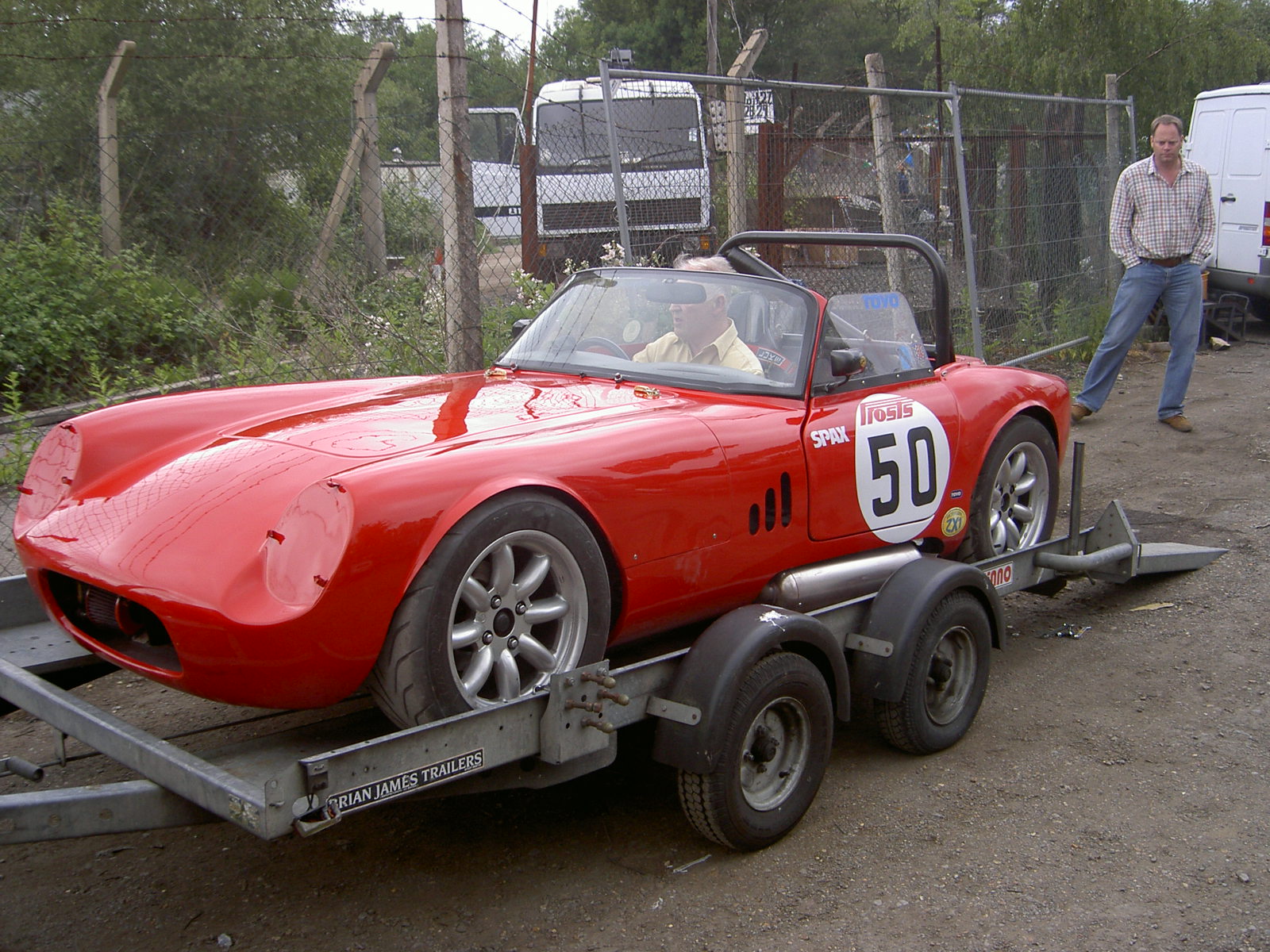

Trailered the Stylus to Joe Middleton today and he reckons it'll be ready to collect this Thursday He's going to fill the bonnet to ' flip ' gap that I left though because he says that with preparation and paint the gap will get full of dust etc and you'll see non painted bits through the gap
I was saving weight . He says he'll just bridge the gap rather than fill it so's to keep weight down
Apparently I'm going to get a CD of the job from start to finish. Can't wait till Thursday now

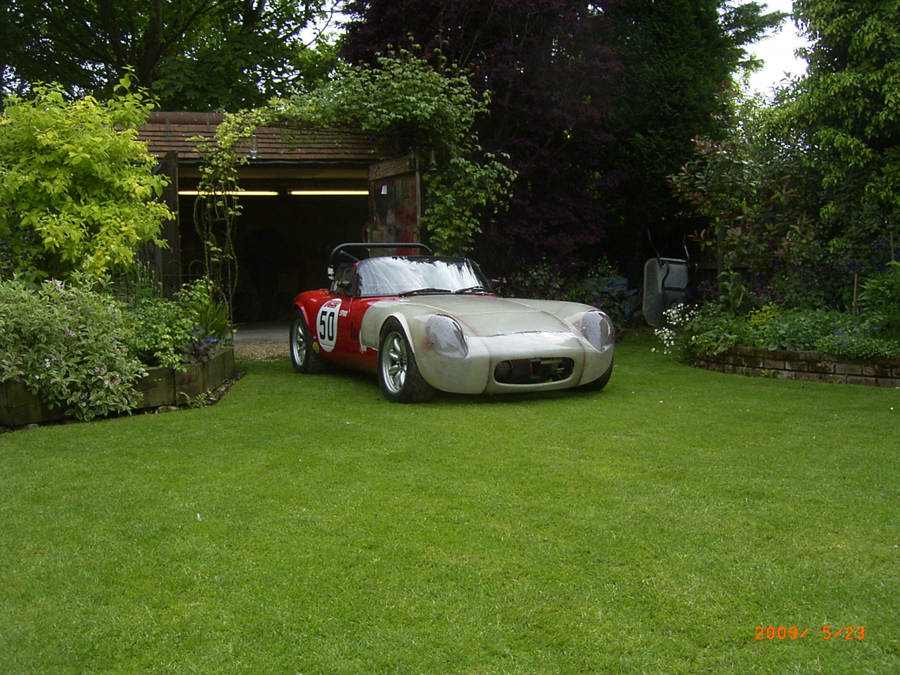

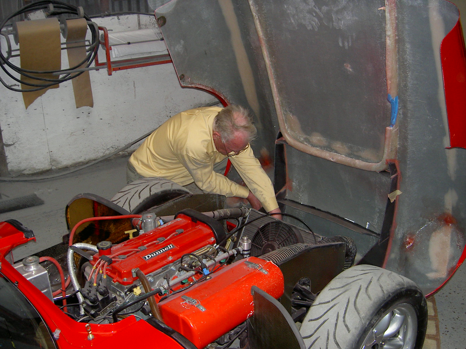

Just one or two pic's for now till it's cleaned up and painted underneath plus it's got to be heat insulated over the manifold or the bonnet will collapse under the heat I also had quite some trouble re-fitting the flip because the holes in the bonnet didn't line up. Filling the open edge around the centre bonnet plus painting seems to have shrunk it very slightly --- probably because it's so very thin Bit more fettling
These are curticy of '' Bailey Enterprizes ''

looking good Rob!
SSC Sylus 2.0 Dunnell Black Top Zetec weber alpha / DTA + cams, 236@fly. (aka NORMA)
Re: body parts
Yep , very pleased just got to make my mind up what colour to do underneath with . Was thinking silver
