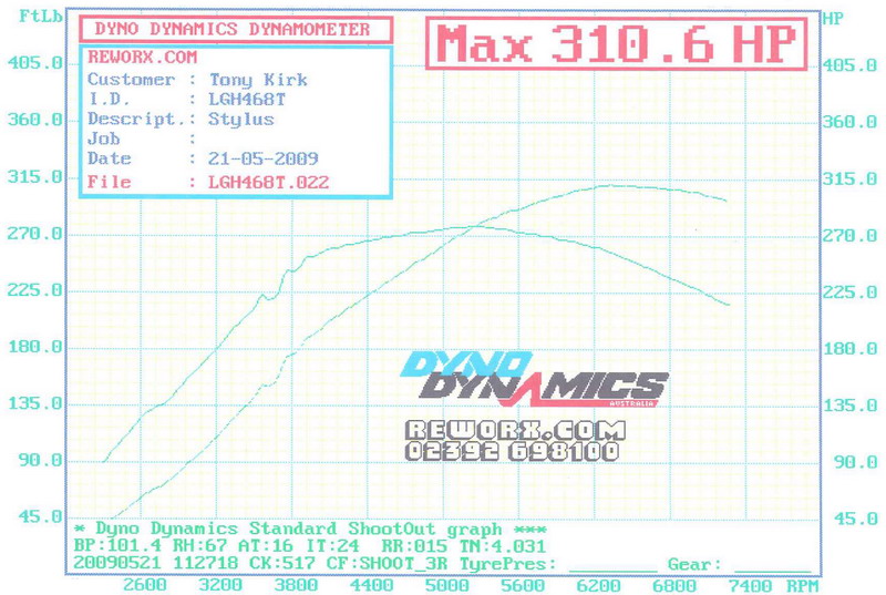

Good day at the dyno today, at last the engine can breath and i'm making power to 7500 rpm.
She made 380 at the fly and 340 ftlbs (310 bhp atw's), so pretty much as i predicted, Still have an issue with boost dropping off, it peaked at 12 psi but soon dropped off to 9 psi after 5k rpm. although it's a nice safe boost level. We have put it down to the intercooler being restrictive so a less restrictive one will see the boost stay flat and not drop off which also means torque and BHP will also not drop off as quick. The I/C i'm using was only a cheap ebay one so a better quality one is called for. I'm not really looking for more power as the car is manic as it is, luckily the boost is adjustable in the car, but i would like things to work as they should. With a flat boost curve the power would easily be at 330 atw's
My wife is going to scan the graphs in at work tomorrow so i will post them up.

Re: Bringing Back the Dead.
my wife scanned the graphs in as pdf's so i'm not sure how to attach them, hopefully it will work.
edit nope, i cant upload pdf's i will see if i can convert it somehow
just mail them to me and I'll put em up
Converted into a jpg
Many thanks werner
