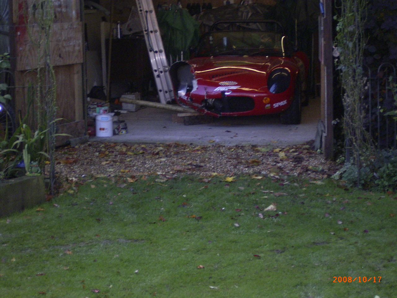

Well at least it's in the shed now :) After my tree incident it got loaded on the trailer the easiest way at the time which was backwards . Unfortunately it couldn't come off the trailer front ways and straight into the shed or it would end up with the rear facing the outer doors . That was going to make it difficult to repair so somehow I had to get it off the trailer and get it into the shed backwards ----------- tricky :?
The trailer only just literally scrapes past my house as it has poly mudguards so the L.Cruiser can't back it past because it's wider than the trailer . This means we have to push it past with the car on the trailer weighing jointly over a tonne :roll: It had to be turned around somehow :roll:
I've had a week or more to think about it ---- facing the wrong way on three wheels ---- chassis & sump & broken f/glass dragging the lawn(soggy :shock: )
SO ------------ I had a brainwave :lol: I got my heavy duty rotovator out and bolted a large nut/bolt to the front weight carrier , leaving 40mm sticking upwards . It has reverse gears . Hooked this bolt under the trailer hitch --- hung onto the handles to transfer weight to the roto's tyres ---- then dragged the trailer past the house and into the front gravel drive area . Here I wound up the trailer jocky wheel which made it rest solely on just two wheels and the roto' then turned the whole thing in a circle ready to go back past the house :D The roto' got it right up to the shed doors . Here I laid out 5 sheets of 8 x 4 3/4 plywood behind the trailer over the soggy lawn . She came off quite well once the sump/chassis was past the ramp hooks and onto the ply. Shifted the trailer back out the way then put more ply down behind the car as we pushed it backwards close to the slight ramp to the shed. We struggled here and failed so disconnected the fuel power and the ECU --- put her in reverse and turned the key ----- great :D . Back in the shed at last :D
Couldn't start it , as some of you might be thinking , cos the radiator's buggered = no water :lol:
This week and last , we had builders working here so there was no chance to move anything around 8)

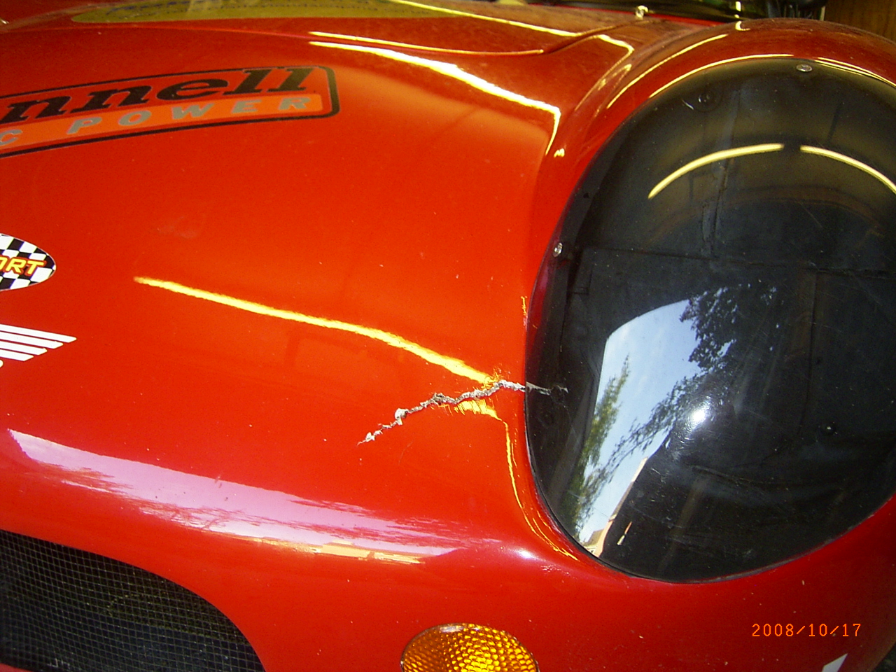

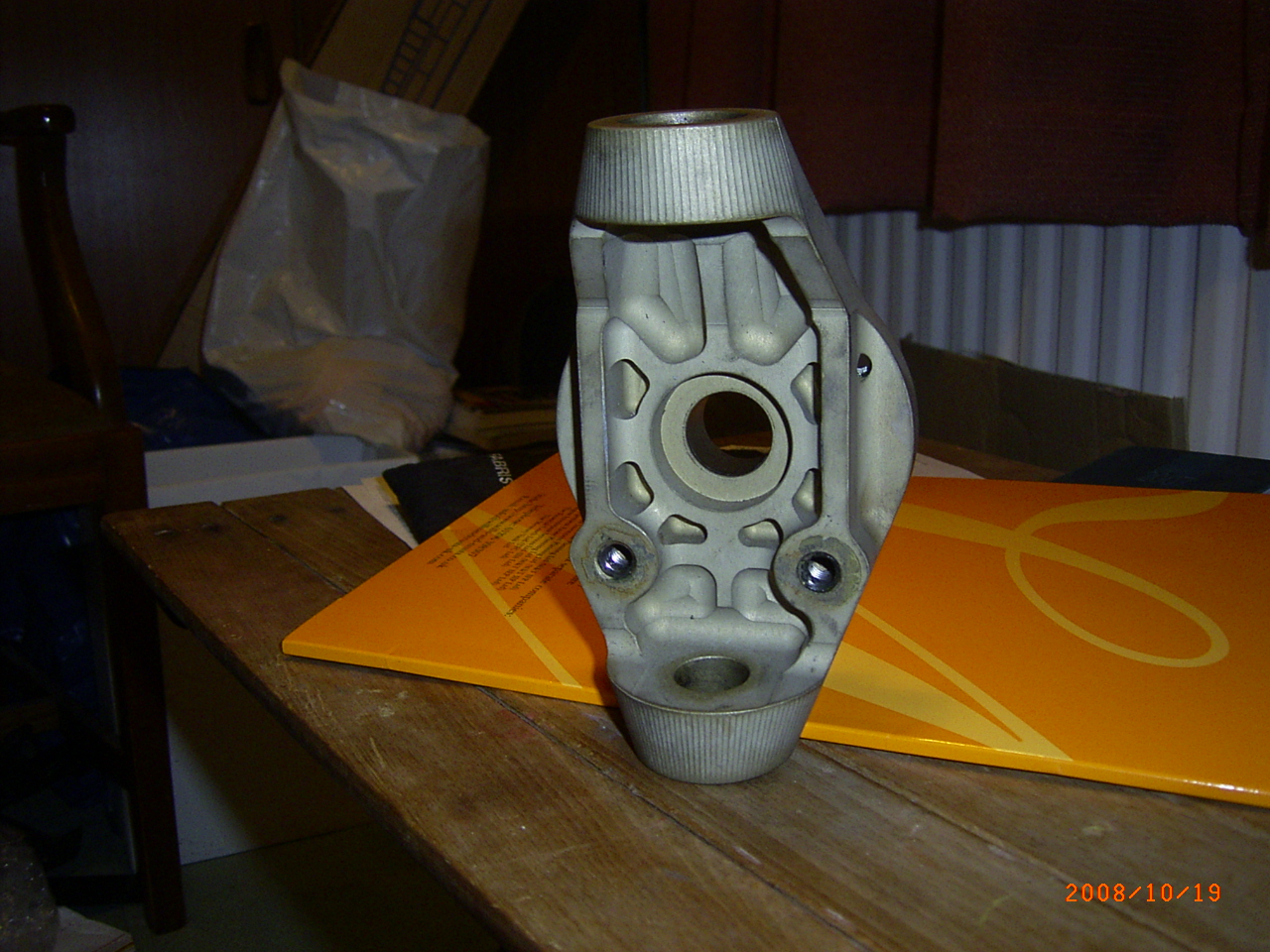

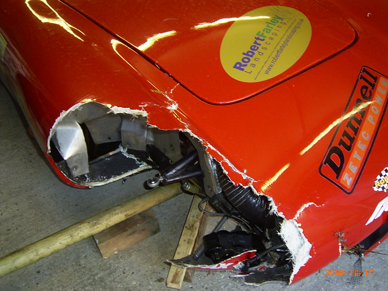

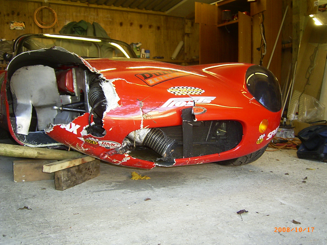

Yes the alloy billet upright was fine but I took it all apart for checking . The ' A ' frame's twisted though and the rack took a beating so both will have to be replaced . The body is cracked on the drivers side too near the light cover , also the ' D ' f/glass got pushed really hard on that side by the ' a ' frame so has split the f/glass in layers where on the surface it looks ok. Still not certain that the engine mounts haven't torn at all . They are new ones but it stopped in a big hurry so both need checking and the gearbox mount :?:
I'm amazed the sump is ok too :o The marshals dragged the car backwards for 50 metres over tarmac then rough rubble plus I dragged it around getting it into the shed :roll: I think the finned bottom helped take the treatment being 15mm deep :roll:

I see your using the Cortina uprights. Do these fit the standard wishbones etc. as I have still not sorted mine yet.
Kevin
Re: ACSMC Speed & Hillclimb Championships 2008
k
kevp wrote:ROB.
Kevin
The geometry is Cortina but were actually Raceleda cast alloy , now billet identical copies geometry wise but with strengthened stress points. They could be made to fit the standard rockers/wishbones with the top/bottom pins made to suit but of course you'd lose the adjustability of the pins made to take rodends . More work on the rockers/wishbones to do it though :roll: I've got one good Raceleda upright and stub axle I'd be happy to sell cut price if you're considering the change Kevin :?: just the one more to buy then :roll:
Don't forget that fitting these drops the car 20mm because the stub is 20mm higher than on Escort geometry (which was a major reason I did it)

I have at last made a final decision on how to repair the front end , body wise . First thought was stick all the bits together OR try to get Tim to supply me a quarter front and mould it in. This weekend the decision was made --- Tim :D :D :D will get me made a half body :D :D :D then it will be converted to a flip front against my better judgement . He made me realise what a bugger it would be to work on the car if I'm on my own ---- if I'd made it a lift off front/needs two to get it off :o
Until then I was fully intending to cut the whole front off like racing bodies because the painting would be difficult to merge with the existing paintwork had I only moulded in a wing/front grill etc.
Opening the bonnet for scrutineering will be tricky with the flip due to my chassis height of 90mm . I'll have to carry shallow ramps and drive onto them to open the bonnett :roll: In the workshop it'll be fine so I'll just have to get used to it :)
At least there's a plan now so I can cut off this mess back close to where the flip will shut --- that'll make the other repairs easier to work on too :D
