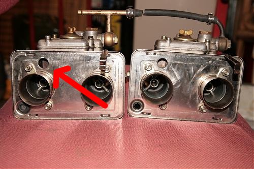

Thinking about it, that hole's more likely to be a vent or something to do with the idle than the choke. To clear up any confusion if some one can tell me what it is, it's this one:

Apparently the little hole is the float chamber breather and has no vacuum so so doesn't have to be filtered.
