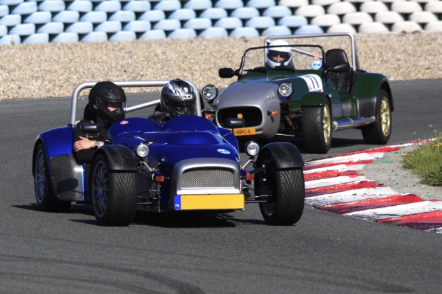

Re: ARB goes East
stylussprinter wrote:I had an enquiry from the Netherlands for an ARB to fit a Striker front end. Hopefully he'll be in the UK for the Stoneleigh show and collect it then ------ it's good to meet guys as opposed to simply posting them off , it helps the fitting process if they see mine and chat it over.
Having bought a huge volume of SS fasteners , ally link rods , rodends and spacers , particularly , I'm now finding it difficult to source spacers at a sensible cost plus the rodends have shot up in price since the first 100 batch . Fitting 4 rodends and 8 spacers on each kit means a damn silly price if only buying a dozen or so . The original supplier has disappeared from the email contact I had so am looking for another supplier :|
He's just emailed this pic' of the Striker on track after fitting my ARB and says the front traction is transformed (he has my set-up info to suit) Just look at that Westy behind him and the roll :wink:
Wrongly named pic --- it's not in Belgium

Must make you feel good when you get to see and hear that is making a difference to the handling of someone's car. :D
Re: ARB goes East
Yes George -- it is very satisfying . Just a pity I'm not young enough to start up a proper business allied to kit and suspension set-ups etc . Nice pocket money to help keep me running mine , nothing more though. Having said that I do enjoy doing it and the feed back :)
