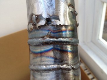

MIG can be reasonable- the attached pic is me welding some 1mm thick exhaust together (total beginner- ignore the really rubbish bits!) after a couple of hours practice. It's not the greatest bit of welding, but for my level of experience I think it shows the machine is capable! I'm sure you'd be able to pick it up quicker than me if you've got 50 years doing arc.
Your right though- TIG looks ace. But I've hardly done it so I'll leave someone else to comment on the cheaper TIG sets

Wow -- 1mm is really thin but the weld is sound Craig :wink: I may have to settle for a gas MIG in the end :roll:
