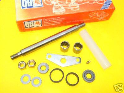

As mentioned in my rebuild thread, i have discovered that my drivers side rocker arm has forward/backward play between the brackets.
I havent tried taking it to bits yet but was wondering how its assembled. I have a nut at each end of the pivot, is that because studding was used and not a nut and bolt? Is it just a case of packing it with a washer so its tight (both bolts are tight)

The rocker arm assembly kit should have a sixty's ' mini ' spindle & nuts / bearings for each end / washers-scored / locating oval plate&nuts bolts. If assembled correctlyAntnicuk wrote:As mentioned in my rebuild thread, i have discovered that my drivers side rocker arm has forward/backward play between the brackets.

There's just a possibility that your previous owner didn't put the front washer / scored in , either trapped on one edge or not there at all . Apart from that , it all just gets bolted up very tight. No way of telling until you've taken it apart Tony
You certainly don't want any extra washers put in

Right,
I have removed the rocker arms tonight, the passenger one moved 2-3 mm and the drivers moved about 5mm front to back on the spindles. Both were done up tight and had nice easy movement with no play but when levered, would slide as mentioned above.
Now they are off I can only just turn the spindle by hand as its stiff but when it was bolted up in place, it was easy to move the arm, i'm not sure if this is down to the extra leverage or not.
Both sides were the same with a thick 'washer' to the front and a thinner one at the back. Both washers had a groove machined in but this groove is off centre so i dont see how this can locate anything?
Tomorrow i am going to fix rose joints to the lower wishbone and then re assemble it all but i want to make sure the rockers are ok and not going to slide as this will bugger up my caster

I have finally figured out the bearings. The shaft has 2 raised steps, 1 at each end of the tube sticking out just proud of the tube end, The idea is that the two washers clamp against the steps holding the spindle clamped between the 2 brackets on the chassis, thus allowing the rocker arm to rock on the bearings inside the tube. The edges of the tube should be as close to the inside face of the washers without binding so the tube doesnt slide along the spindle. The tubes on mine are a couple of mm shorter than they should be so when clamped the tube in the rocker is able to slide along the spindle between the clamping washers. I will machine the centre of one of the washers a little more (0.5mm ish) so it gets closer to the tube once clamped.

Plenty of replacement rocker arm pivot's on Ebay for a tenner each too.
They are just Metro rear radius arm pivot bearings...
Re: Front Rocker Arm Assembly
cheers matt. my bearings dont look like that, they look like a conventional bearing rather than a needle bearing. I'm going to have a better look today, i think with a bit of lube.
