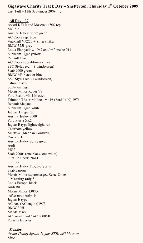

Last event for me this year will be a non competitive day at SNETTERTON to support a charity for a children's hospice and injured/stressed ex-service men. It's on Oct 1st and would be nice if it was a dry day , especially if passenger rides are given for some of those people
I only just squeezed in and it's full now

Runners
Don't seem to be able to attach the document Matt may be able to though Mr Wragg / OMEX was there running a MORRIS MINOR with a supercharged 2lt zetec blacktop with 380bhp

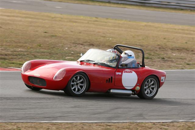

Have a browse through these pic's from Snetterton on the official photographers site.You can pick Matt's out without screen plus gold wheels http://www.edpphoto.com - They are under GIGAWAVE CHARITY TRACKDAY . My best pic's are in the AM group section 8 . A nice little opposite lock moment exiting the Esses just before the Bomb Hole. I had my cousin on board and he loved the ride even though he's just had cateracts done But then a good few years ago he fitted a 7.2 lt Pontiac into his SD1 Rover because his 3.5lt plus stump puller cam wasn't powerfull enough

Here's a couple of pic's from the CD I got from EDP , probably a little better quality Took the Esses in 3rd then 4th into the Bombhole

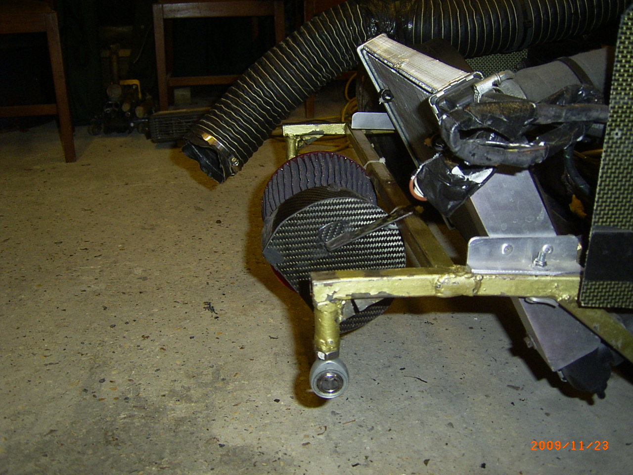

I've not touched the car since Snetterton , other than a quick look under the bonnet , as I've had problems with my breathing after getting a horrible cough when I got back. Yesterday , I decided to take the flip front off to make a start on sorting the ' A ' frame . I assumed I'd be draining the engine , removing the radiator , to get the frame off but on careful measuring I could see it was only the forward 5 inch lengths of tube that were bent.
I had two choices --- try to straighten them or cut them off at the point where they pass the radiator then make new extentions
I decided to attempt straightening because if that failed then the second option was still possible
A combination of ------------- jacking the car up from under each rodend , sliding a 16mm solid rod into the tube end , careful use of a hammer , cutting through the triangular steel support between top tube & threaded rodend tube ----- has got them fairly close to their original positions
I wont be welding them in position just yet though because if they're not exactly right , the flip wont close as before. When I built it , it wasn't as critical because the flip could be filed back to make a tidy shut line but now I don't have that margin for fitting. Then of course I've got to cut the carbon reinforcing off to re-fit as was . It would be easier if I had the advantage of no engine in the chassis THEN I could fit the flip onto it's hinges , shut the flip and tighten it's fittings ---- that way the carbon could be fitted in precisely the right position from underneath the bonnet.
The flip is very flexible due to it's 2mm gauge so guessing the exact position when it's off the car is tricky. If I get it wrong then when the flip is shut it will be under tension as it was after I drilled and pop riveted the carbon back on at Snetterton . That caused the fibreglass bonding to crack around the join of the old bonnet into the main flip front ----- so lots to plan and think about before I do anything more

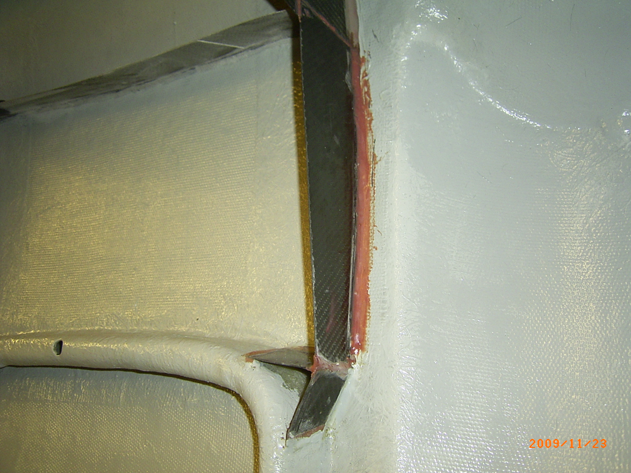

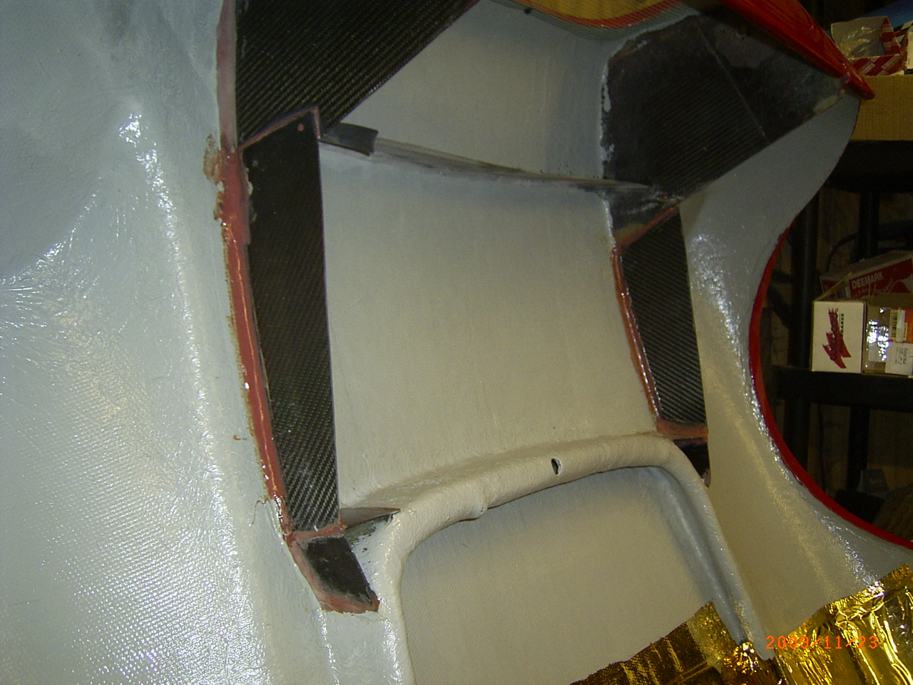

I found a fairly accurate way to position the carbon fillets before glueing & clamping them. Having trimmed all the old glue from the long joining areas , I noticed there was still a small ' glue edge ' mark still left on the ' D ' pieces where the two carbon pieces meet and overlap. It made a good marker , even though I'd really have preferred to grind it all off to form a new strong fix .
I wedged the front sill to bonnet shut edge (next to the windscreen) with a wooden batton to make sure that I could get the carbon overlap to ' D ' pieces behind the ' old glue line ' . Used some of the carbon glue I still had (given to me by Andy Bailey in June this year-- what a friend ) to put a nice wide/deep glue fillet round every edge.
All I need to do now is grind off that old glue edge then put a new fillet in it's place.

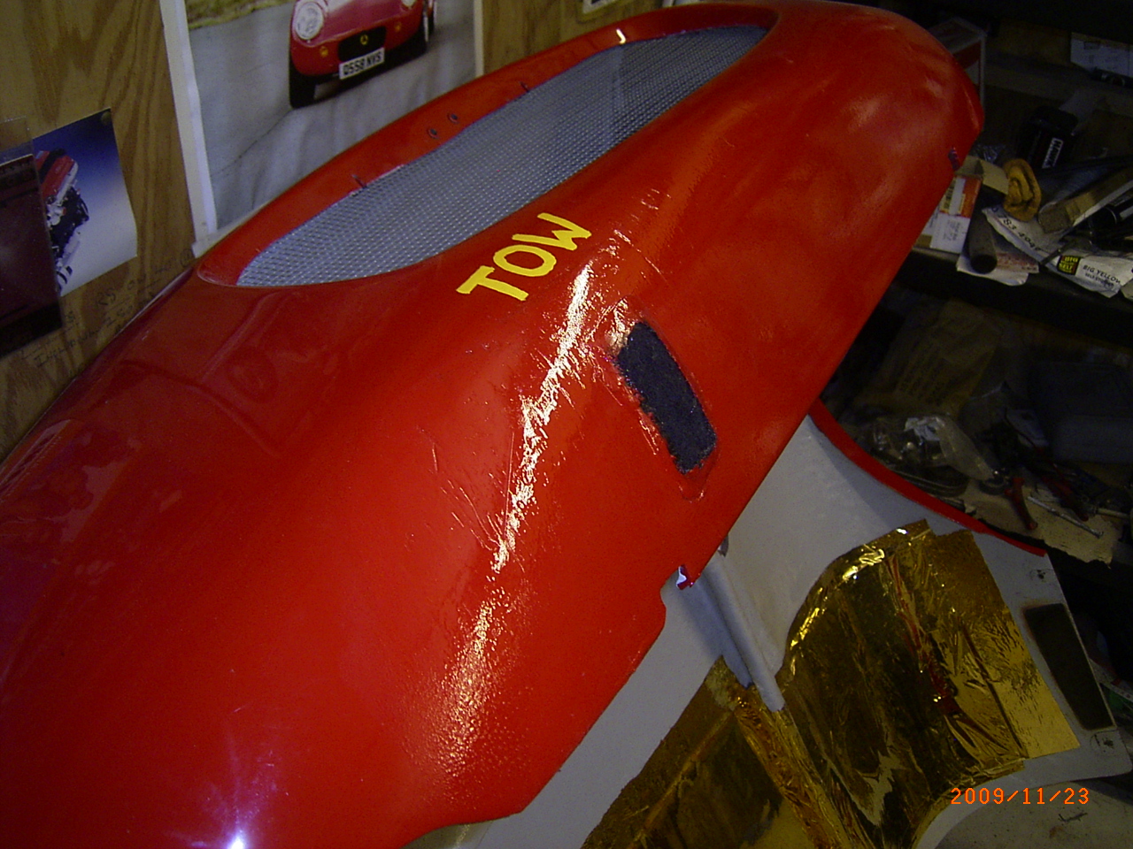

While that was drying/setting I painted the grey inside of the flip where it had black rubber off the R888's , through coming off and the flip being forced downwards.
The front lower grill and under front sill , I filled with P40 , sanded and painted yesterday , also refitted the tow strap velcro attachment which got ripped off and filled with grass/dust That'll do for Saturday DIY
Sunday 22nd Nov. Took the clamps off this morning ready to cut the old glue off the overlap and cleaned it all . Had a sweep around the shed --- that's it for Sunday Got people coming so I've other priorities so I'm told

Finished off this morning but still need to fix a split each side of the bonnet at the shutting end , where it's bonded into the ' flip ' . Only 13mm or so each side then paint. Brush painting seems a bit naff against the new paint job but it's a track car not concours and needs must
Next , I'll fit it back onto the hinge to see where it shuts or doesn't When that's ok the A frame can be welded up under the triangular fillits that were cut to straighten the frame

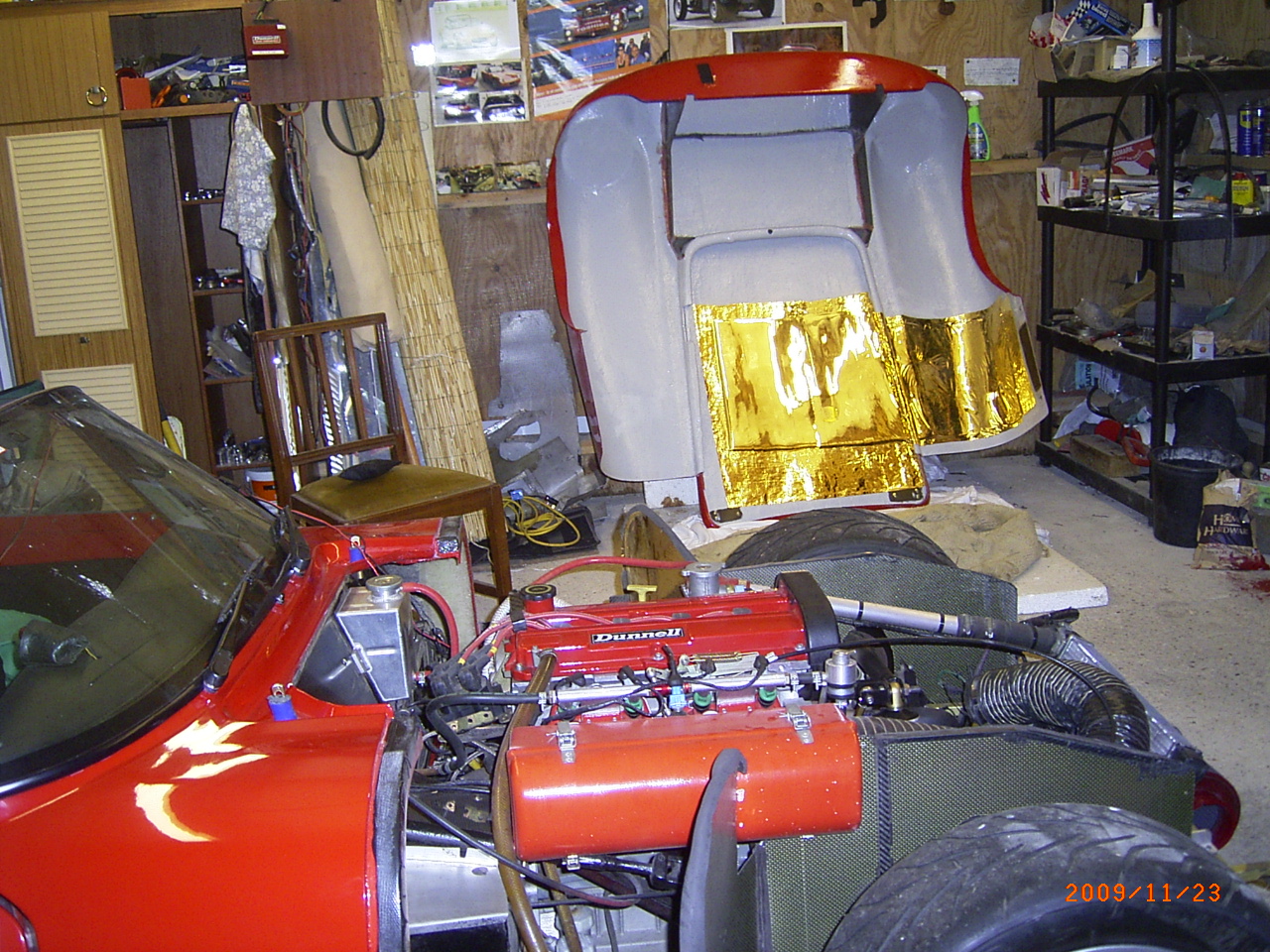

Well , over the last two days I've had the flip front on / off then back on again 5 times
First fit saw the shut line over fitting by 2mm or so --- that's the dog-leg line in front of the windscreen . Took it off and filed the holes out a little in the ' D ' pieces to allow the flip to move a touch forward . It wasn't enough so repeated this twice more so's not to over do it . Quite a struggle to bolt and clamp tight in the correct end of the now slotted holes.
More slotting didn't alter the shut line in proportion to the amount filed out so decided to remove the flip again and unscrew/lower the rodend/hinges. First stab at it was half a turn which combined with the hole slotting already done , I expected to do the trick.
Once the flip was back on it did shut reasonably well , so it was going in the right direction but with vibration on track , might still rub off paint , as it almost touched on closing.
Finally I took it off again to unscrew the rodends another half turn. Once back on , it shut almost as new so painted the scratched edges and left it open to dry. Spent the next hour and a half cleaning Snetterton dust from around the front chassis tubes and engine bay . So that's it now , all tidy again . It and I need a run but just don't fancy a torrential trackday
