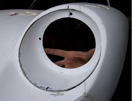

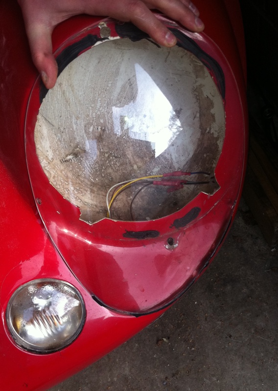

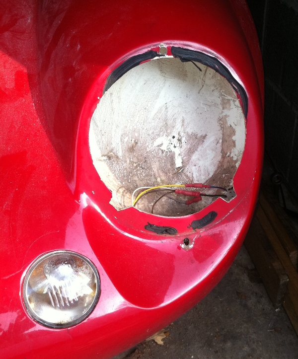

I currently have the porsche outer bowl with sealed beams and they are so naff I can see better using a torch at night so I thought i would go for some nice Wipac Freeform halogens with a view to go to the nice new look with the perspex covers, so off I go and buythe lights, basket and chrome finishing ring.
I come to take off the existing lights and see an immidiate problem, the whole is too big and on the wrong angle to fit the lights like I was expecting, so if I did fit them they would be pointing at the sky.
So what I'm after is does anyone have any photos of a vertical fixing hole without a headlight in it and any advice how to turn my sloping hole into a vertical hole. (So it ends up like the headlights fitted to the J15 http://www.sylva.co.uk/j15.html )
I have no expierence with fibreglass or bodywork so I might have to pay someone to do it as I dont want to mess the car up or it might mean I have to ditch the idea and go back to using the Porsche units but with the halogens in

I guess your new lights come with a bowl. How much smaller is it than the revealed light aperture?
I think you will have to prop the bowl at the right position in the hole, (ally tabs). Then from the wheelarch, fill the gap with rolled up wet fibreglass. Leave overnight, remove taps & fill as required so the front looks neat.

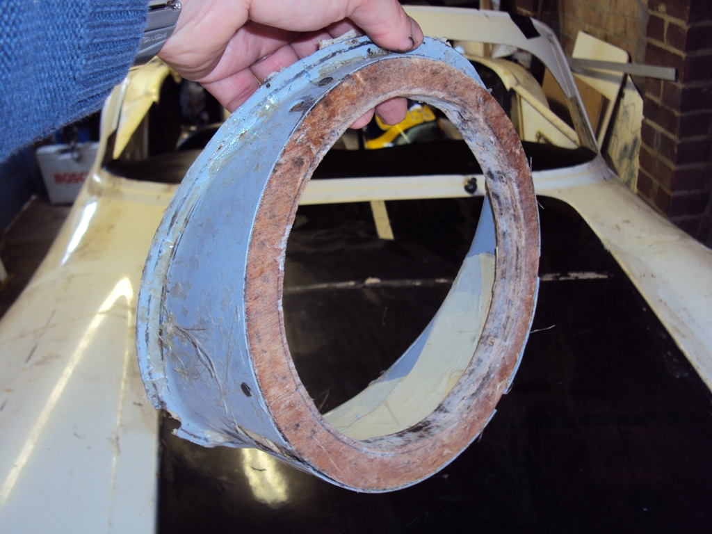

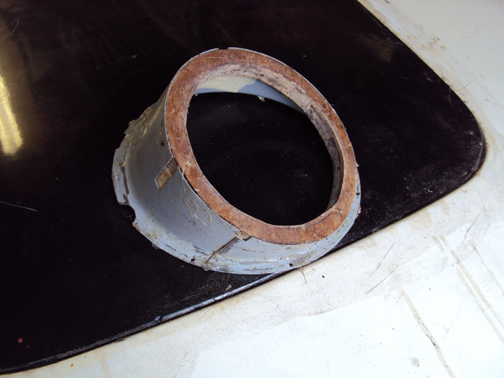

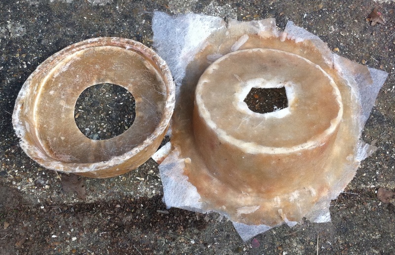

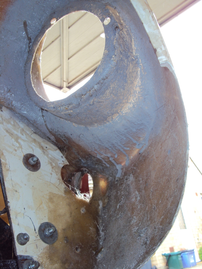

Hi
For my uncle's V8 Stylus build I made a mould from the porsche type shell (the metal duck-egg green bit which hold the lamp), with a wooden insert to form the vertical mount needed for the new plastic back shell.
Used this as the former for some GRP fibreglass, which was then bonded into the light aperture.
This was for a car that doesnt have the headlight bowls fitted, but already had some huge holes cut in the front light faces.
I'll take some pics of the mould & the end result (which is still in its rough state), so you get the idea.
Rgds
Rgds

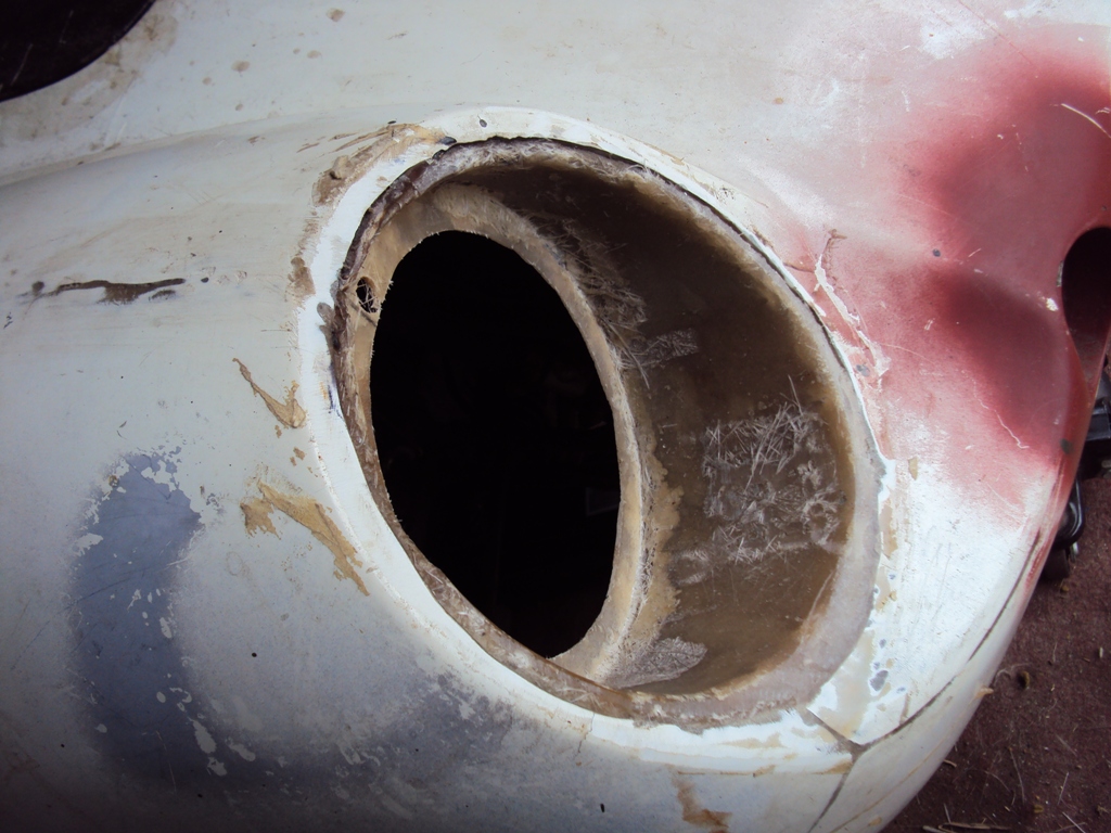

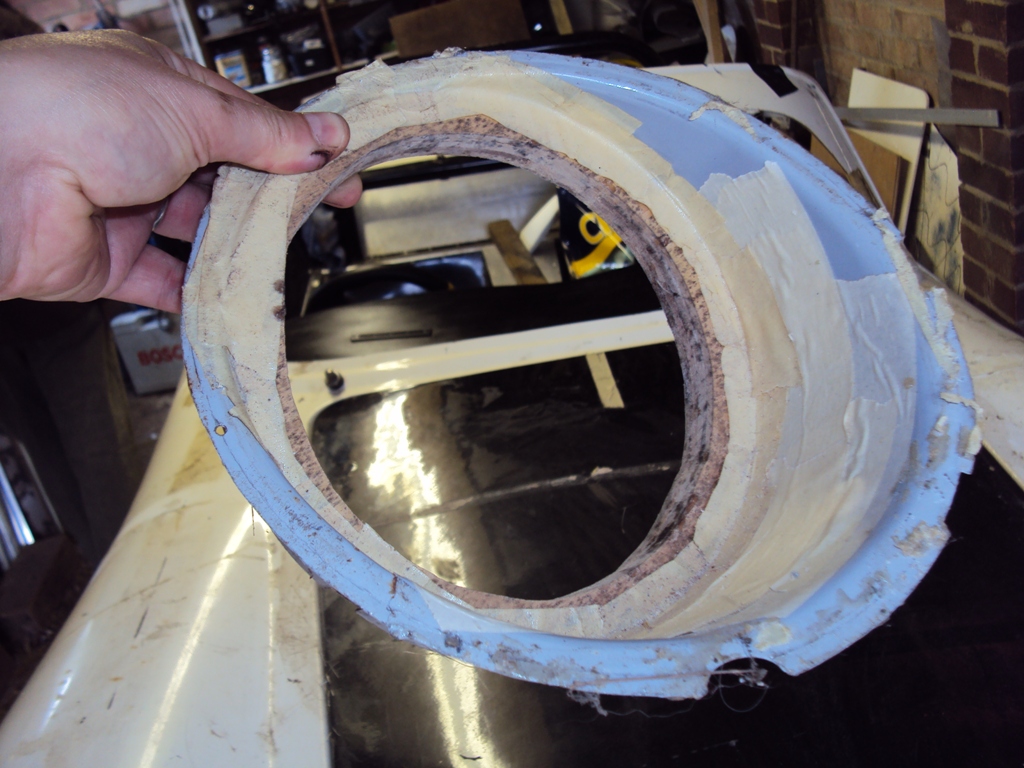

I cut out the whole headlight area and formed new ones using discs which take the 7" headlight and cut these out to take the light bowl, http://www.skcc.co.uk/smf/index.php?page=page1321 there is a pic showing this, this was before the large hole was cut and the filler applied.
George
George

I had those inserts but couldn't use them as the headlamps didn't fit into them so they were skipped.CMA wrote:Thanks for the replys peeps.
Just found and had a read of the Build Manual on here and it looks like I need to make an insert like in this pic to hold the light.

Sorry, meant to reply earlier, but couldn't find the right lead for the camera !
Anyway... looks like we re-created what George binned ! Rgds, Matt

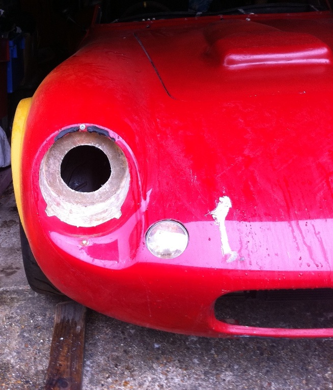

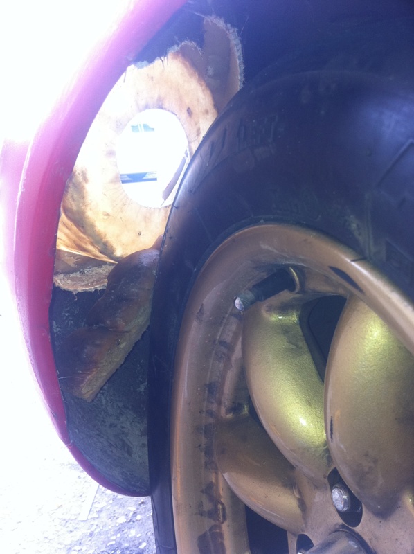

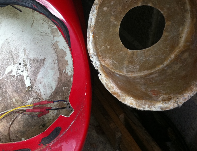

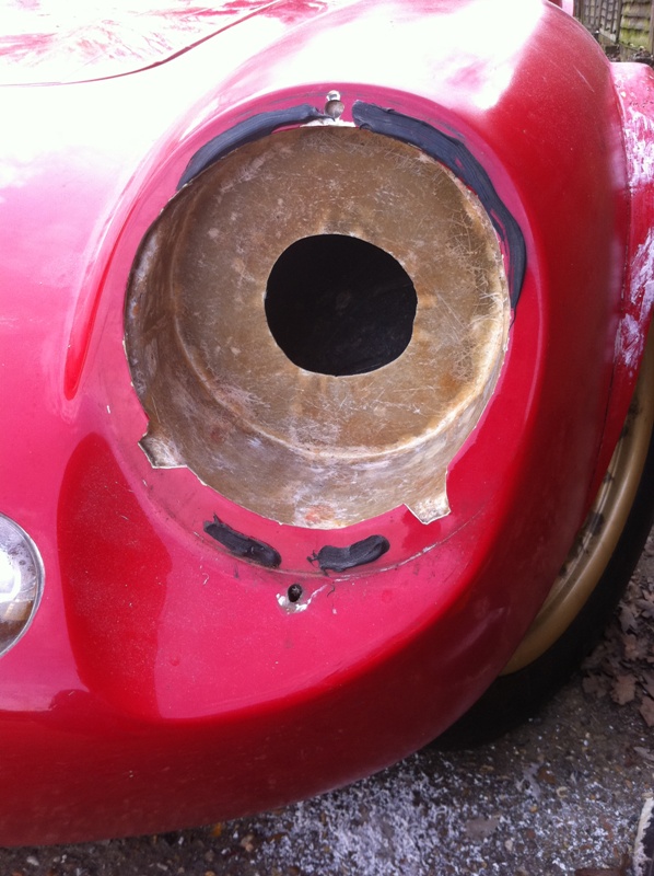

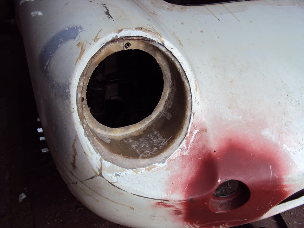

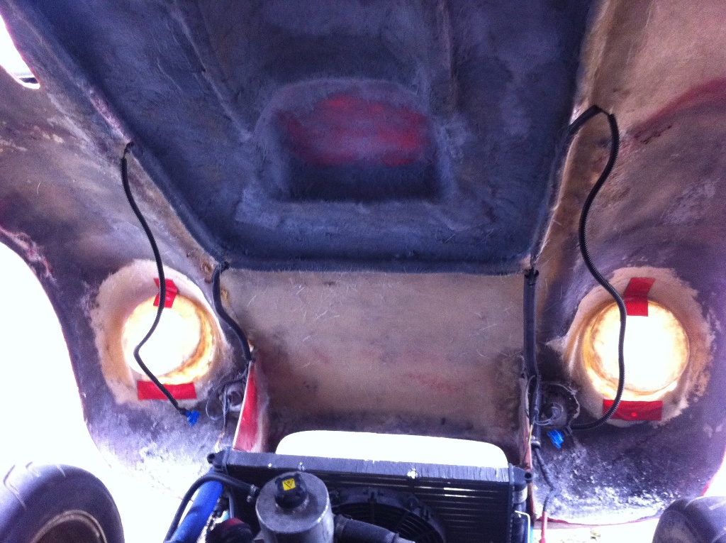

Made a start...
Uncle made me some inner surrounds off his Porsche/Beetle metal frame (as per previous post) Took the old light unit out to see how I fitted it 10 years ago !
Will cut the old rear bowls off & bond in the new over the weekend.
My question is... how does the GRP meet under the light lens.
Looks straightforward enough
I presume I need to trim my painted surround back flush to meet the shape of lower semi-circle half.
ie - not leaving any outer overhanging edges. But what about the top half ?
As can be seen above the V8 body had oversized holes cut that needed a lot of back filling, but look good now they're painted purple , so I can easily copy the style. Just wondered if any one has done anything different or had some practical tips ! And.. If anyone is interested in a good pair of Porsche headlights, complete ready to go, send me a PM.

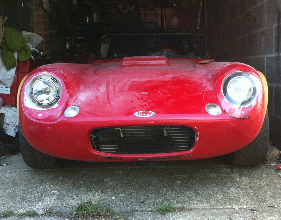

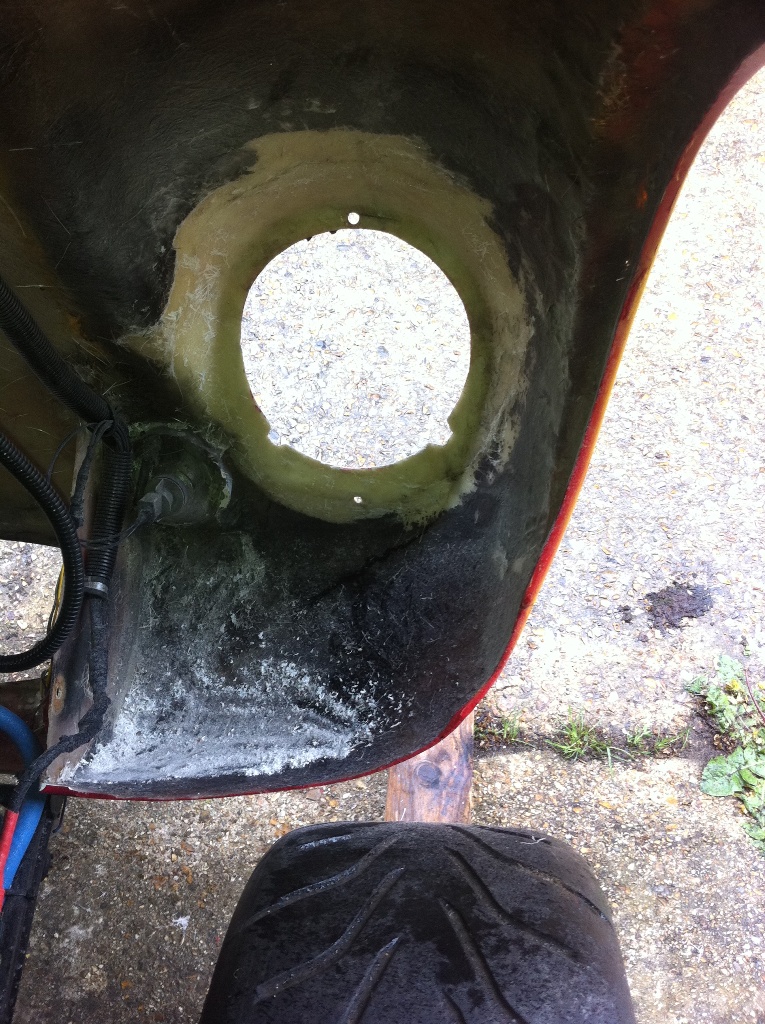

Re: Fitting New Headlights
Now all done...
