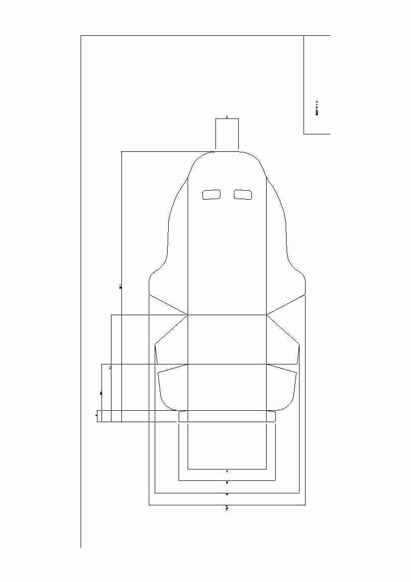

I have an autocad drawing for making ali seats if you would be interested in it.flipper123 wrote:RIGHT IVE DECIDED!
im making my own seats. ive bought three pairs now and im not happy with any of them so im taking the plunge. here we go.

Calm down how much do I want for them there will be lots of 0's in the amount starting with 0 and ending with 0 and some more 0000's in between. PM your email address and will send a PDF or the Cad file to look at. If it is any good go for it. I printed it out on a bit of A3 and cut it out and folded it up and taped the joints and it does look good. I could mod it if you wanted to make changes to it. The harness holes are going on the sizes Rob gave me as not able to measure mine just now so they may need moving slightly.flipper123 wrote:how much would you like for them.

I am working from home this week and the drawing is on my pen drive at work oops if I get time will redraw and send this week if not it will be next week.flipper123 wrote:thankyou very much that is great, im gradually building a long list of thankyou's

Here is a jpg of the seat plan cannot post the pdf here will email them when a bit more time. the quality of the image is not that good as used an online convertor. You should be able to print it out and fold and make the model thats what I did. If you want it moded in any way let me know and will do that for you no probs.

that looks fantastic thankyou very much i hope one day i can help you out and repay you

hey george, im a bit confused at how i get the drawing from here to a format i can print to make the templates?
sorry to be a pain im no good at driving these darn computers.
