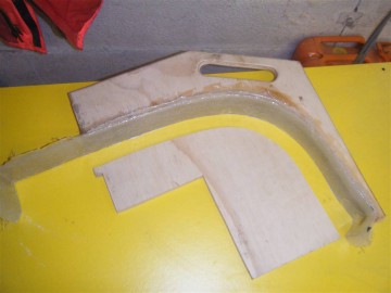

I think I got this sorted. I laid up some fibreglass over cling film on the outside of the tub then glassed a suport onto this with a handle attached. When it all set I took it of trimmed it up and lay it flat onto a clingfilm covered board, and used it as the mould. The finished part is good but the finish is not great, but as most of it will be bonded inside the tub that rough finish will help. The outside part that will be seen will have sticky backed foam for the flip front to land on so again won't be seen. I took loads of photo's during this but I can't seem to upload. I've had a look thru old threads but still haven't figured it out, will try again later..

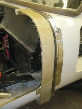

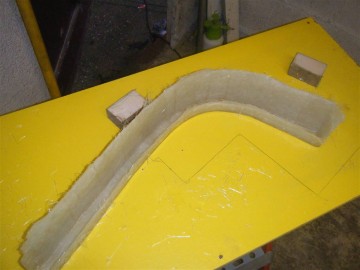

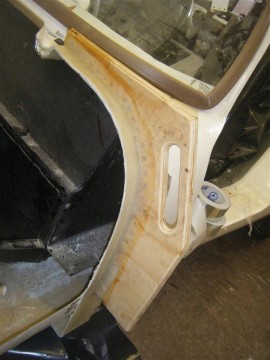

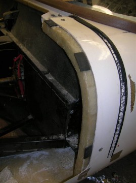

Right, remembered how to add photos.
So this is what I was talking about!!
fibre glass laid up on outside
wood added for strength and as a handle
removed from body and set out as mold
finished part
finished part
trial fitted into the body tub
