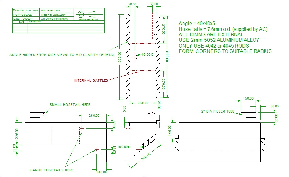

well, finally got the tank I designed made - very happy so far, fits like a glove and is over 40 litres. Also acts as the rear diffuser. Doesn't need a sump either as the pick up is right at the bottom of the wedge.

norma, do you have any sketches or dimensions for your design? orange gunk in my fuel filter currently so it looks like my Midget tank isn't long for this world... I loathe to spend £100 on a new one when that could be put toward a bigger and less rust-prone one!

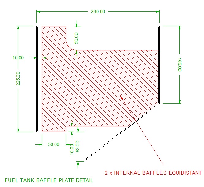

My tank does not include swirl pot because I run a small lift pump from the tank to a swirl pot at the front of the car, that's where the inj pump is situated.
So if you're not using a swirl pot, I advise you take some advice from here:
viewtopic.php?f=19&t=1196
I will try to add the sketches I did - some problems with dimms moving a little, but you get the gist......
