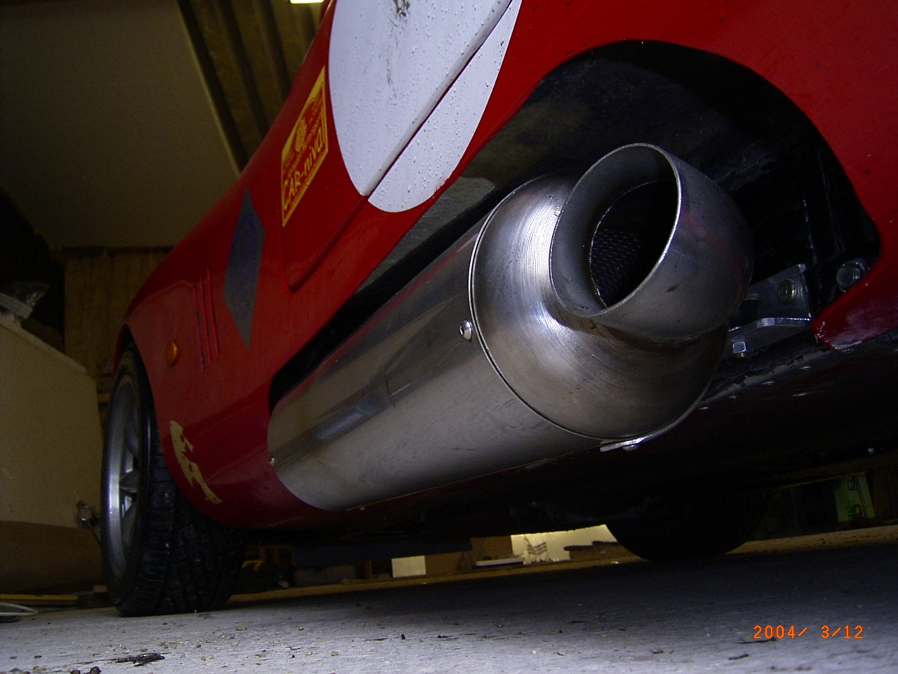

Here's how (You can see here that it protrudes out from the body about 20 mm's ------ also the alloy angle mount & bobbin on top)

Yes I am going to cut away the body work to give clearance, and fit the silencer as you suggest. So far I have removed the silencer and all the heatproof matting from the chassis and bodywork (revealing a bit of rust caused by moisture retention). Once I've cut back bodywork I'll replace the heatproof matting and add the extra ventilation holes (thanks for that tip) ...I'll go the repackable route as well.

Hi Rob, I thought it might be better to cut the grp back to the chassis. More cutting for me tonight then .
